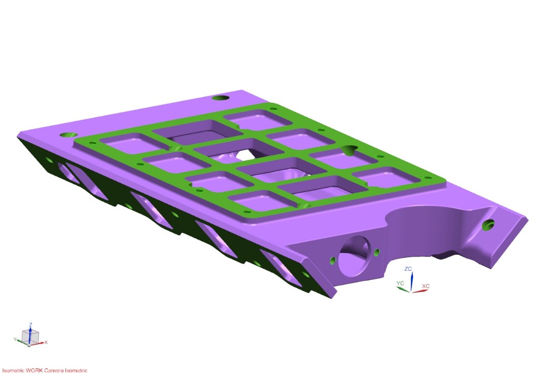

The reason I ask is that Weiand made the only "mass" produced MEL blower intakes, they pop up on E-bay from time to time, typically cost $1500 to $2500 depending on quality. The problem with the Weiand is that they were essentially a race only manifold. There is no provision for water or a thermostat with the Weiand intake. Also, the distributor needs to be relocated as it interferes with the Weiand intake. I am working on making a street friendly MEL blower intake with water, thermostat provisions, and distributor clearance, but I switched jobs and moved across the country this summer and have not got my shop back up and running.
There is a picture of the CAD model for the new intake I am working on getting produced atached. Hopefully I will have cast aluminum parts by the end of 2019. I also am willing to sell my Weiand once I get a functional prototype of new intake built.

I am going to make at least one for myself for sure. Hopefully I can get the first one made during this coming summer and verify that it will work and fit up correctly. After that I will decide if it makes sense to make more. The first couple will come off of sand cast molds with 3D-Printed cores to keep the tooling cost down, unfortunately, that also means the piece price will be higher.

This has taken way to long, but I am making progress. I got a 3D printed version of my blower intake a few weeks ago (and promptly set it onto a very dirty 430 MEL. I am in the progress of fitting it up on the engine, checking clearances, and then I will adjust the CAD model before sending it off for aluminum casting. I will focus on this project much more intently as soon as I finish building the engine in the 2nd photo, and recoup the funds from that expensive hunk of cast iron.

I am still diligently working on it. In fact, I received a 3D printed plastic mock-up version of the intake that I can use for fit-up, flow testing, and the like earlier this winter. I have to finish up another engine project first in order to free up some working capital, but hopefully this summer I can finalize the design and get serious about getting a couple of these cast out of aluminum.
