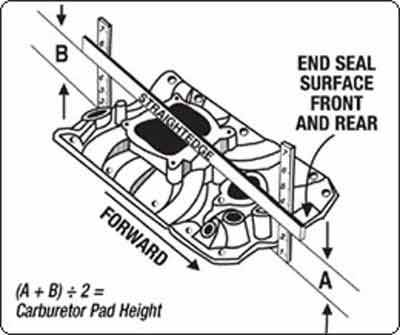

The heads are not physicall taller, but starting in 1961 with the LINC specific redesign of the 430, the intake manifold carb pad was lowered and moved towards the rear of the intake (this is more apparent on the 63/65 4V intake) to fit under the new lowered hoodline. It may be that the 66/ hoodline was increased. I just wanted you to be aware of the possibility.
Do you know how to measure carb pad height and/or is the blue vehicle you are showing in the photo a 66/ LINC?

KULTULZ wrote:The heads are not physicall taller, but starting in 1961 with the LINC specific redesign of the 430, the intake manifold carb pad was lowered and moved towards the rear of the intake (this is more apparent on the 63/65 4V intake) to fit under the new lowered hoodline. It may be that the 66/ hoodline was increased. I just wanted you to be aware of the possibility.
The car in the photo is a 67. What would I measure the carb pad height from? The carb pads for the tri power are without a doubt higher but with that clunky 4 barrel air cleaner I can see height being a problem but I will be using a 1" or so air cleaner with a flat lid. The Holley 2300s are no taller than the standard 4 barrel. If I used 2Gs or any other carbs it would for sure hit the hood. I will be sticking with the 2300s I have or move to Mopar D neck ones but they are the same. Thanks

by KULTULZ
Re: 430 heads on a 462
Posted: Wed 24. Dec 2008, 19:05
by buddy67lincoln
KULTULZ wrote:Image
the only question I have is that these MEL intakes have a valley pan. I can measure that as you have it pictured but the bottom plane might actually be different on the standard 4bbl and the 3 deuces (maybe different heights?). I do have both easily accessible so I can post both results. Take care.
Posted: Wed 24. Dec 2008, 20:31
by KULTULZ
:| Doh!
You got me on that one.
Yes, use the valley rails as the bottom measurement.
Don't forget to figure the additional length of the FE style air cleaner at the front.

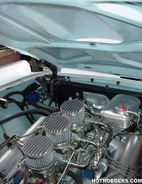

Posted: Sun 28. Dec 2008, 04:34
by KULTULZ
Below is a photo of a gentlemans 1962 LINC slabside installation. It is an EDELBROCK with ROCHESTER carbs so they do sit higher. You can see the scoop on the hood to allow closure.
John's is the OEM setup with 2300 HOLLEYS. It just may fit.
