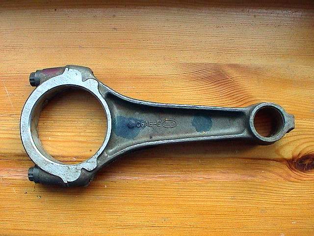

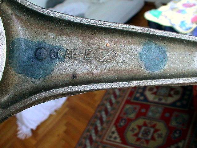

The blue colour on your rocker tips remind me at the blue spots that were on my NOS FE Le Mans rods. Maybe it's some kind of rust protection to amke the product longer storable.
