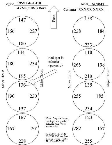

Can a 410 (4.2 bore) be bored to a 430 size (4.3) safely? I have found a NOS set of forged 11.5:1 4.3 standard sized pistons.

I don't know the answer to this question. You would think so as MEL would not have to cast more than one block. There were a few 410 users on the old board. Maybe if you cruise through there you can find an E-Mail for one of them. Having it sonic checked is the only other way I would know.

Beep wrote:Can a 410 (4.2 bore) be bored to a 430 size (4.3) safely? I have found a NOS set of forged 11.5:1 4.3 standard sized pistons.
Here's a sonic test sheet for a '58 Edsel 410 that was already 0.060" over. It potentially could have been bored out to 4.300" and still had the prerequisite 0.100" minimum remaining. This particular block had a porosity problem in one of the cylinders and was replaced with another block rather than sleeve the questionable cylinder as this engine had a history of other issues also. If core shift is taken into account on a block that's still a standard bore or close, then the cylinders can be offset bored to keep a more uniform cylinder wall thickness.

Now that's what I call an informative post... :shock:
THANX TED!
