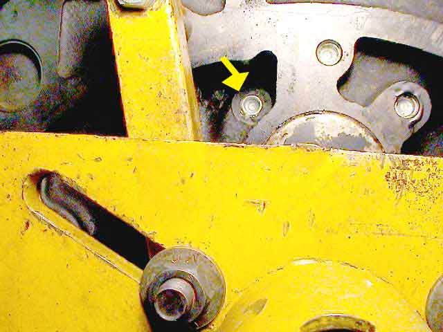

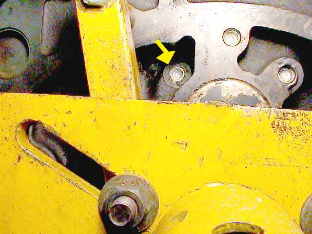

I assume that you were talking about this plug?
Some machine shops ignore it for a simple reason. Too much time involved to remove and to reinstall.

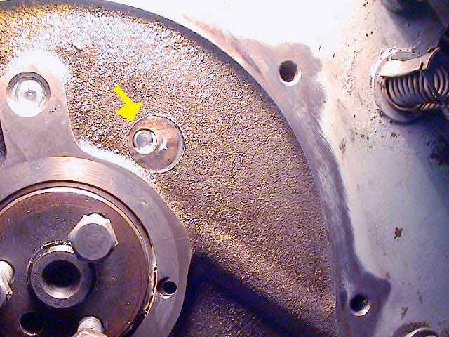

Please take a look at the second photo for an other plug that might get skipped in the process.
Installation seems tricky but is a lot easier than you might expect. Installation of these plugs should take place right after the block cleaning process and right before you put that biest on a stand.
With the engine standing upright on its' bell housing surface the plug seen in photo 1 can be positioned and driven in a lot easier. The same goes with the rear plug (see photo 2) and with the engine standing on its' timing cover surface.
