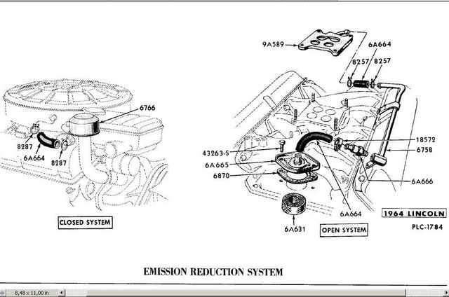

Theo, to be sure, his engine has 51.000 not 1000 miles on it.
Jeremy, is yours an open or closed crankcase ventilation system?

I have a closed PCV system. I don't think the filler cap is sealing very well at all. Could it be as simple as that?
