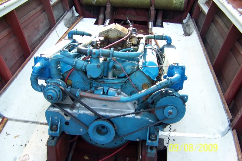

I just picked up a couple more engines... 1960 or 1961... How can I tell by casting numbers?
And... what is the difference between a 65 and a 60 or 61? These are marine conversions by Chris Craft, and the cooling varies slightly, but that is a marine only difference...
I am considering a roller cam etc, so I understand there are differences based on that..?
Here is a photo of a marine 430 ...1965...
Differences between years on the 430

Hi, check out this section. The sticky posts cover a few casting numbers according to various MEL engines.
it would be a lot easier to tell us what you read on your block.
Generally a C denotes the 60ies decade. The second number is the year. So C1 would be year 61 while C6 is 1966.
D would be the 70ies decade and so on.
Note that the block casting numbers did not necessarily change each year becaus design changes haven't been done each year.
