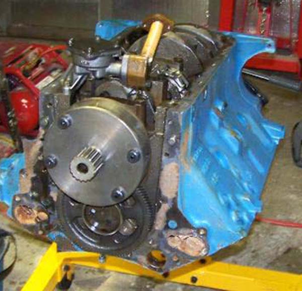

Posted: Sun 15. Nov 2009, 15:14
by Chris Craft crazy
So here we are... an engine torn down. This is a 1960 430 block, but by the casting numbers, the heads are 1961, so it must be an engine built on the edge of 61. I post these pics as a reference for those of you who have not seen the differences between the marine engine and automotive.
First, the block, with a single solid lifter sitting there..
Here is the curious little brass flexible coupling to the strainer... which is also bronze mounted in the bottom of the pan.
Now the pan, which is about double the capacity of an automotive pan, and is CAST ALUMINUM. Keep in mind the engine is flipped around... the flywheel is on the front, and the timing gears on the rear of the engine The pan has an inspection port on the one side, so you can unbolt the flexible pipe from the strainer before dropping the pan.

This is the cast aluminum housing that joins up the crank at the timing cover end to the transmission.(to the left of the picture.. essentially making it the timing cover. The transmission itself is the seal on the end of the housing... one of the reason for the extra oil capacity. The fuel pump and fuel pump rod are also in this housing, as well as the back legs for the engine as it sits on the engine beds.

Great Photos Peter, thank you for sharing them with us. There are not many photos of marine MEL engines out there.
I've edited some of your photos for a larger view if you click on them. Here they are.

I would LOVE to see a close up of that gear drive timing set!!! Wonder if it would fit under the passenger car timing cover??
