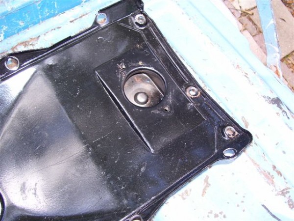

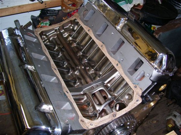

To properly vent a 58/60 MEL to PCV, the internal road draft tube has to be blocked off. The best place for the actual draw would be at the rear of the valley cover as on the 61/ .
61/ PCV Provision- Vally Cover
61/ Internal Air Baffle

Thanks Kultulz,
That's exactly what we were thinking, but couldn't find any place already threaded. The next question would be did you route that to the carb.? And if so did you use a spacer plate?
