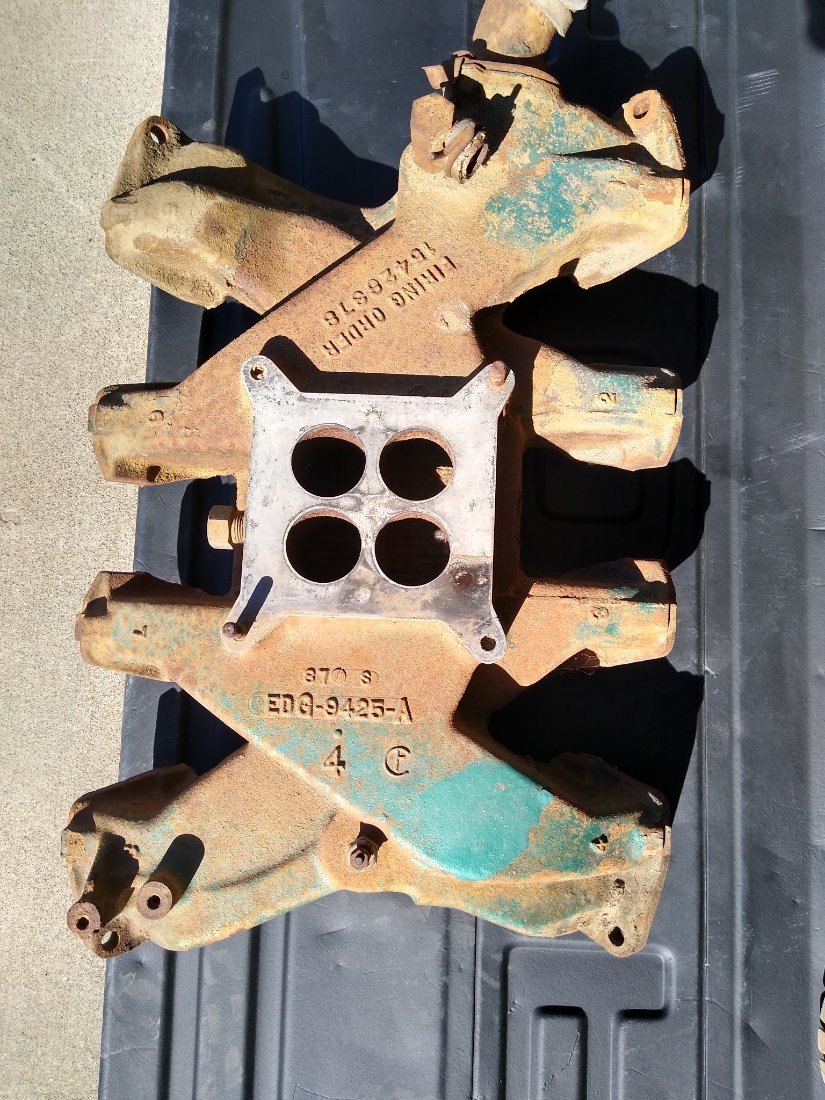

I've been casually searching for an early intake to replace the original on the '65 430 in my F100 since hood clearance isn't a concern. I finally made it down to the local pick-a-part in the off chance of finding something was shocked to discover a pretty disheveled '58 with the motor already apart and the intake sitting in the back seat! It needs a good deep cleaning but all the fittings came off easy and the threads and sealing surfaces look to be in good shape.
Two questions: Does anyone know if I'll have any fitment issues on the later motor?
Also, does anyone have any tricks for cleaning out the inside of one of these? I plan on sand blasting it but I'm not sure how well that will reach the inner passages.

In case anyone is interested, I plan on doing a comparison with the later manifold to document the differences between the two castings. Already it appears that the carburetor mounting pad is roughly 1.25" higher on the early manifold and the ports at the head mating surface are 1.125" x 2.625". Additionally, the temperature sending port and heater port locations are swapped between the two.

I have those height measurements saved somewhere. 58-59 4V, 60-62 2V, 63-65 4V and the 462 4V. Don't know what 4V Thunderbird used in 1960. Even started a post on it but abandon it. I think the interest got lost in life's shuffle. I have molds #1-3 of the EDG. I see you have #4. No difference I could see between the EDG's. I posted a couple of questions in your introduction post. Take a look and let me know.

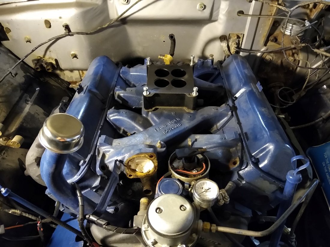

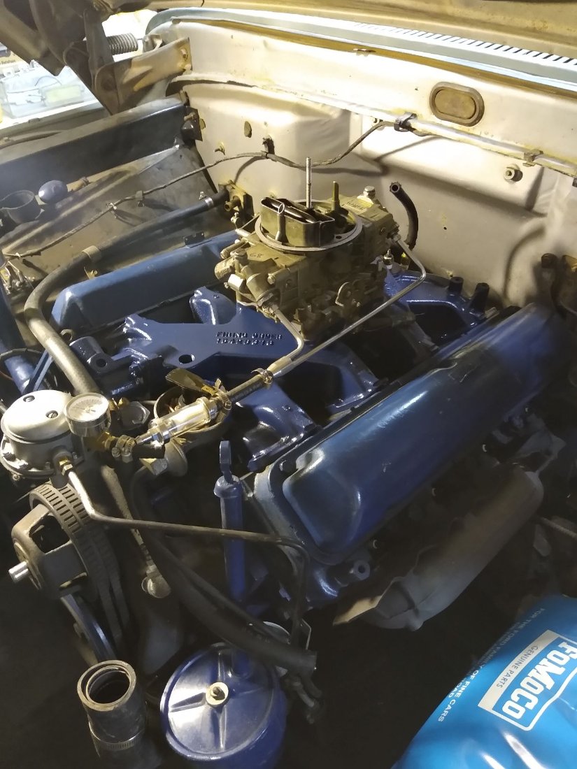

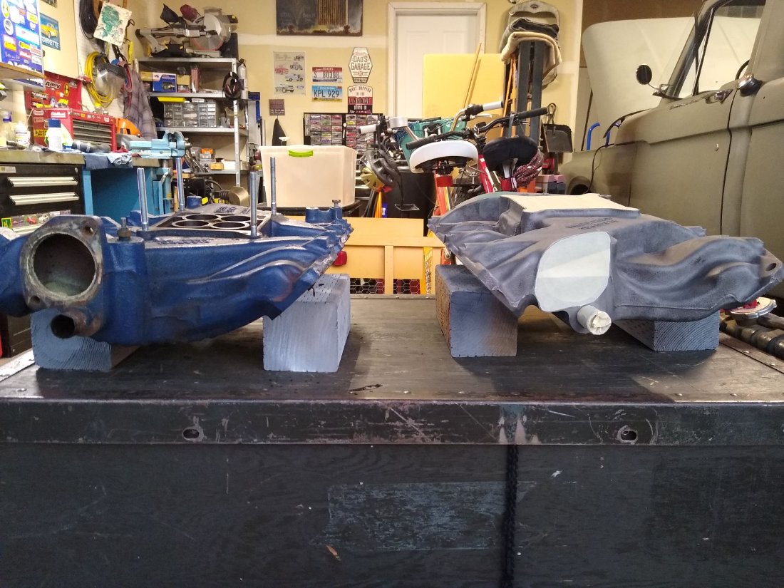

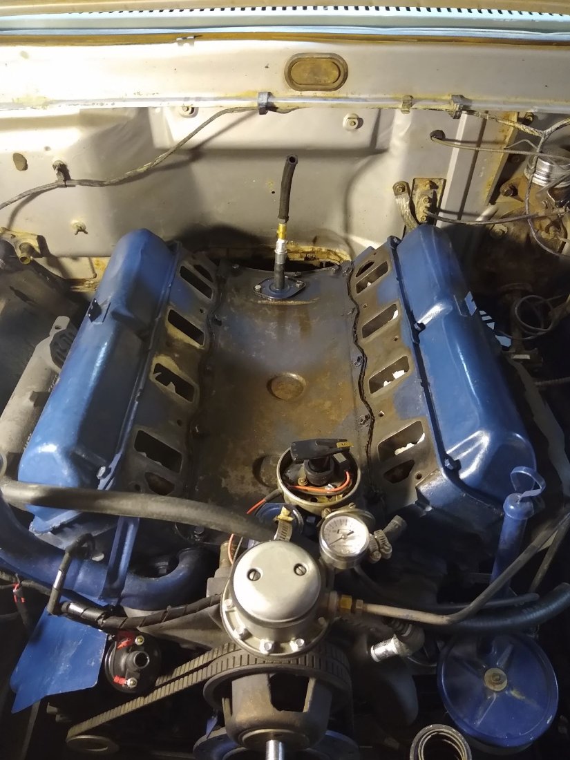

Anyway, I figured there was no time like the present to move forward with swapping my '64 "low-rise" intake with the '58 "high-rise" intake I scored recently. Here it is mid tear-down:

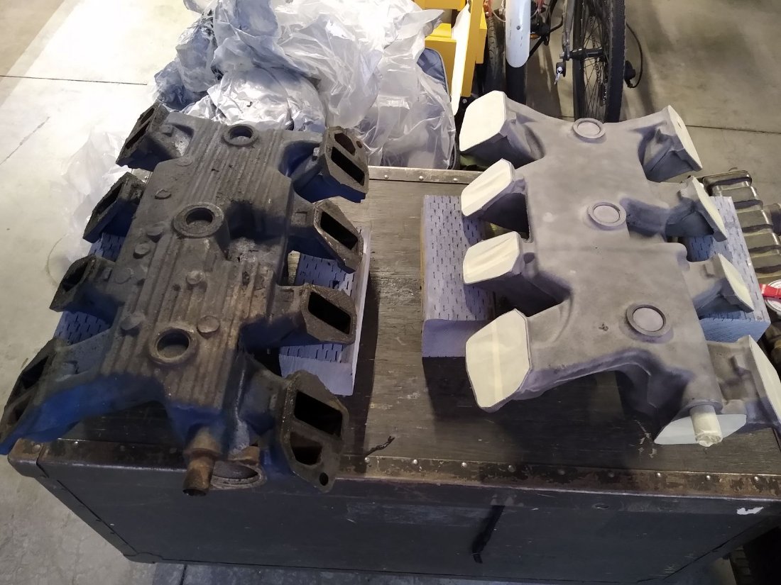

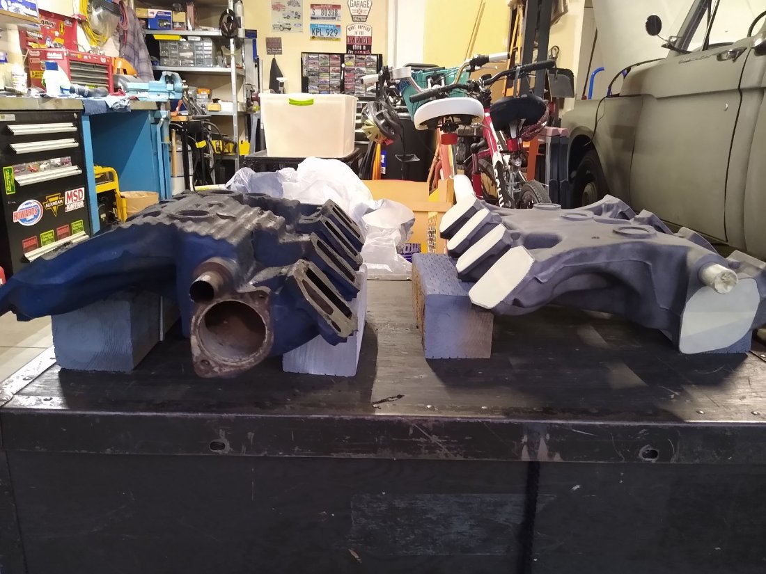

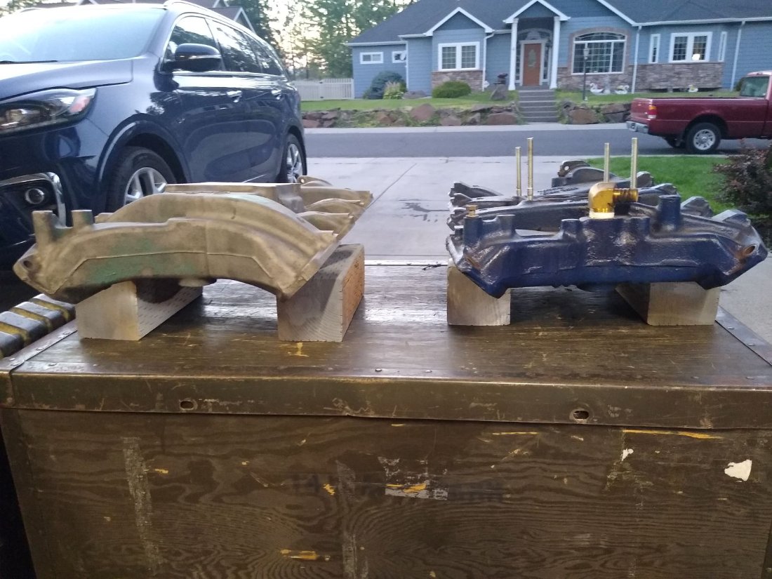

Here are a couple pics showing the differences between the two. The later intake sits much lower in the valley of the motor, ports are the same size, but the heater connection and water temp sensor ports are swapped and the threads are different sizes. The highest ports in the '64 intake are about the same height as the lowest ports in the '58 intake. In the lowest ports of the '64, the mixture from the carb has to travel back UP to the intake valves. Crazy.

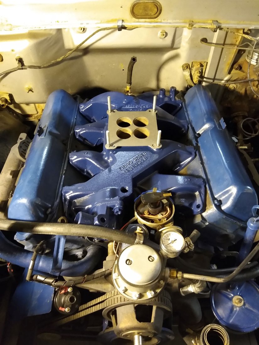

Not shown is how the later manifold moves the carburetor towards the firewall about an inch to center the primary venturis on the engine. According to literature of the day this was supposed to make the engine more efficient but I feel like it was probably more of a packaging consideration with the lower hoodline of the later cars. Here's the intake removed and cleanup underway:

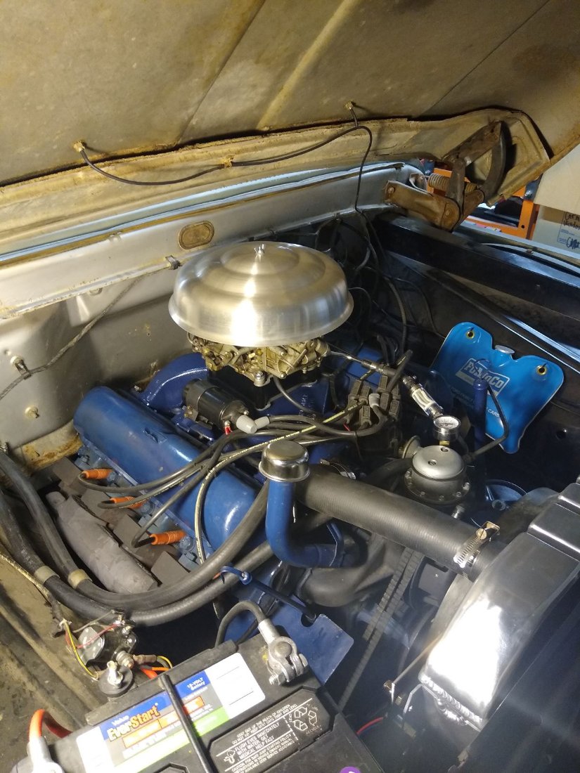

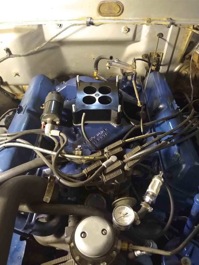

Lastly a couple mock-up shots just to see how everything will fit. I'm going to run a 1" open spacer on this manifold (the old setup used a 2" four-hole spacer) because in my experience it should improve low- and mid-range torque vs. no spacer or a four-hole spacer.
Re: Early Intake Manifold Score
Post by Chris430 » Fri 11. Sep 2020, 06:59
Look's good. Makes me want to get on mine. I also think it was the hood line. Lincoln dropped the hood line for 61 causing the 61 and up starter movement and the squished intake manifold. Look's like an FE thermostat housing was modified to work.

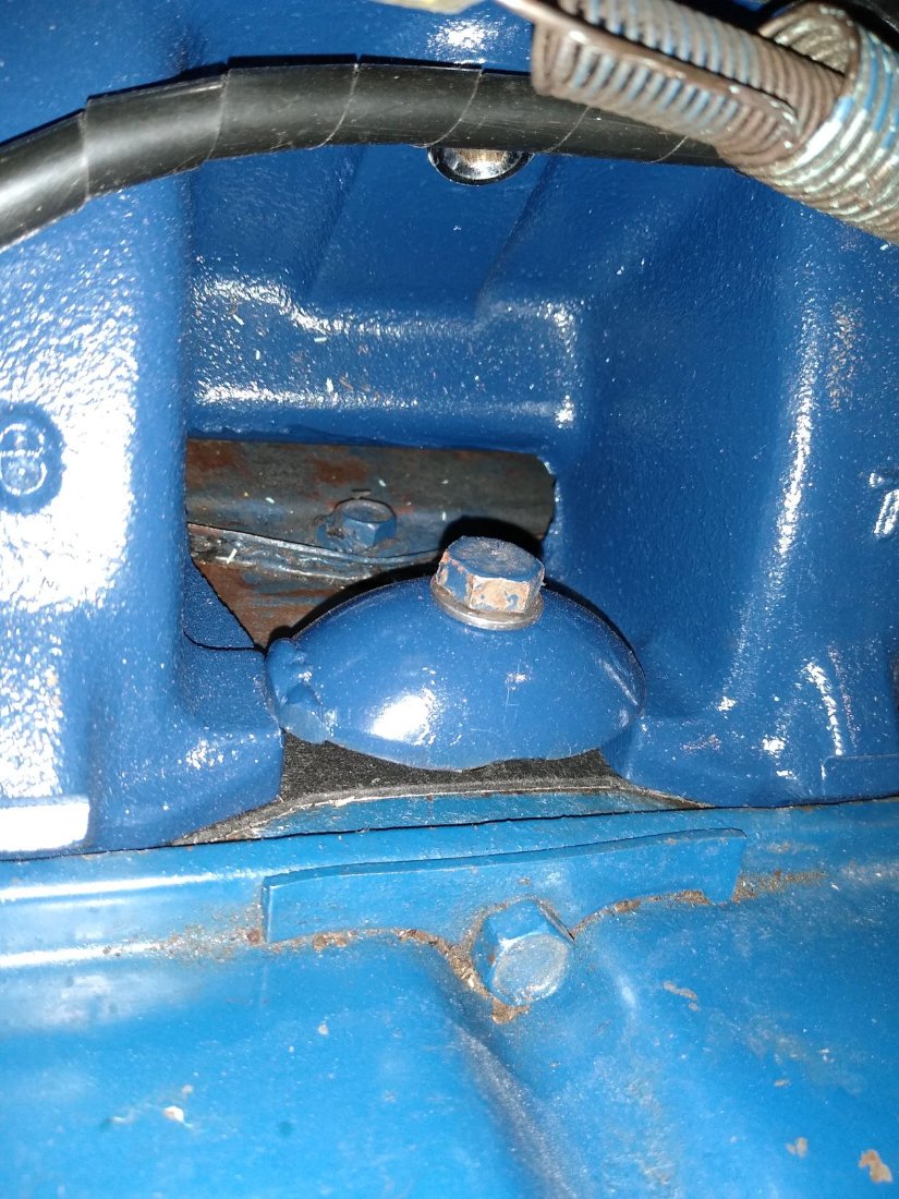

- The manifold spreader thingy's that the bolts pass through to clamp it to the cylinder head are different sizes. I didn't get the ones off the '58 and the '64s are shorter. About three fit well enough to torque to spec, the rest I welded a bead on one end to make them longer. See pic below. Not my favorite solution but functional since I may never come across the correct parts.

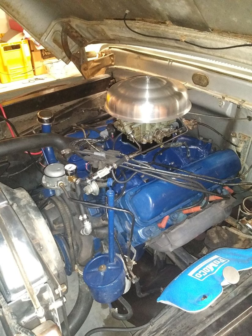

First here's the new intake with the 2" spacer that was on the original manifold.

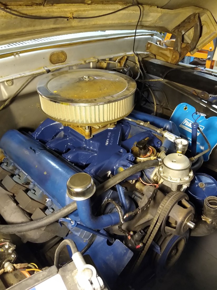

Here it is setup with the 1" open spacer I originally planned on running—still waiting on the new radiator here. The open spacer ended up being all top end power and caused soggy throttle response on the low end. The swanky new air cleaner has a flat base for reference. The crusty old chrome air cleaner was about a 1" drop base.

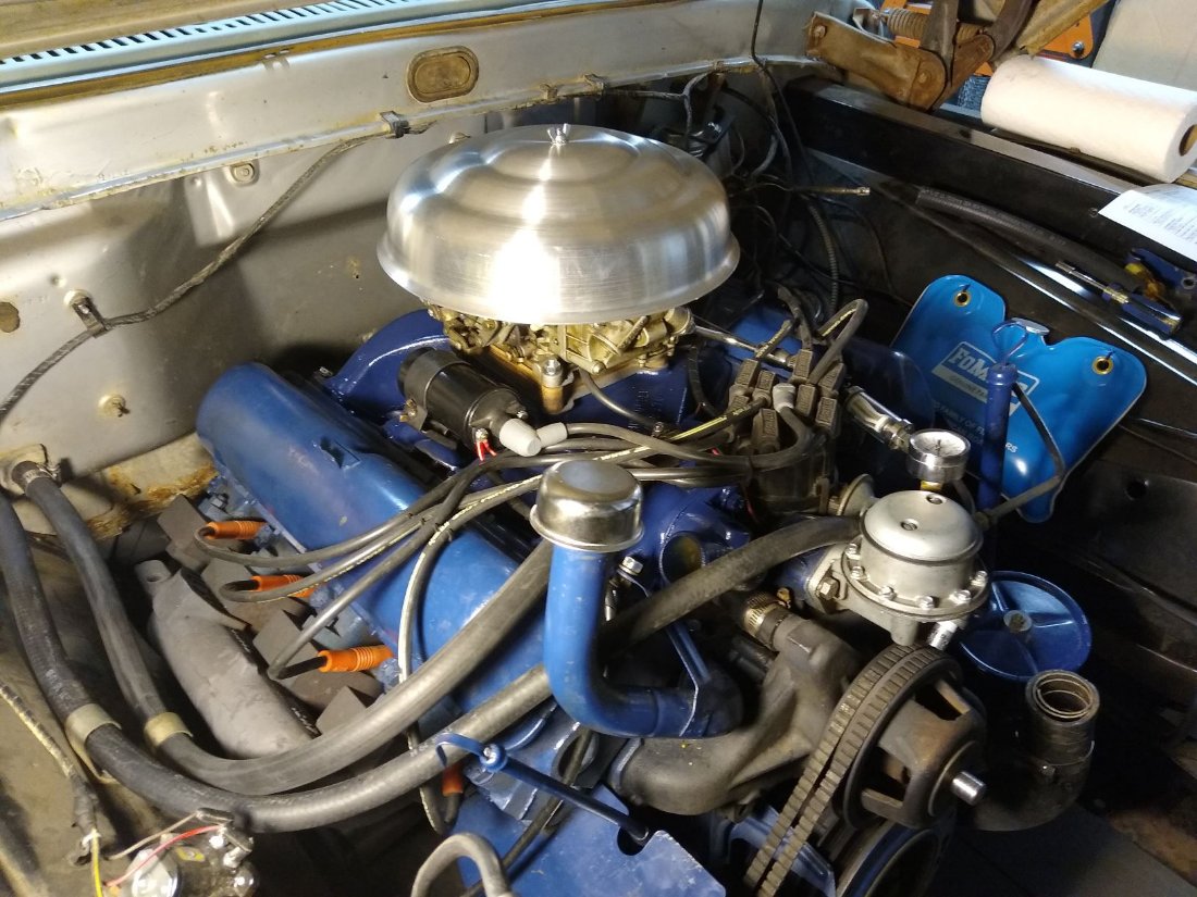

Here it is with the 2" four-hole spacer back on it. This is a tall setup (the air cleaner is about 3" high) so it's getting close to the underside of the hood now. This setup has instantaneous throttle response at any rpm, great power everywhere, and I can loaf it down to about 10 mph in high gear. With the old intake setup, 15-20 mph was about as slow as you could go in high gear before it fell on its face. Not that that's important, but it is indicative of the improved efficiency of this setup in my opinion. It's a blast to drive now, merging is fun but it's very easy to overspeed. I'm sure I've surprised a few people with how quickly this beat up old truck pulls away from them now.
Here's the modification I had to make to bolt the early manifold on using later hardware.
