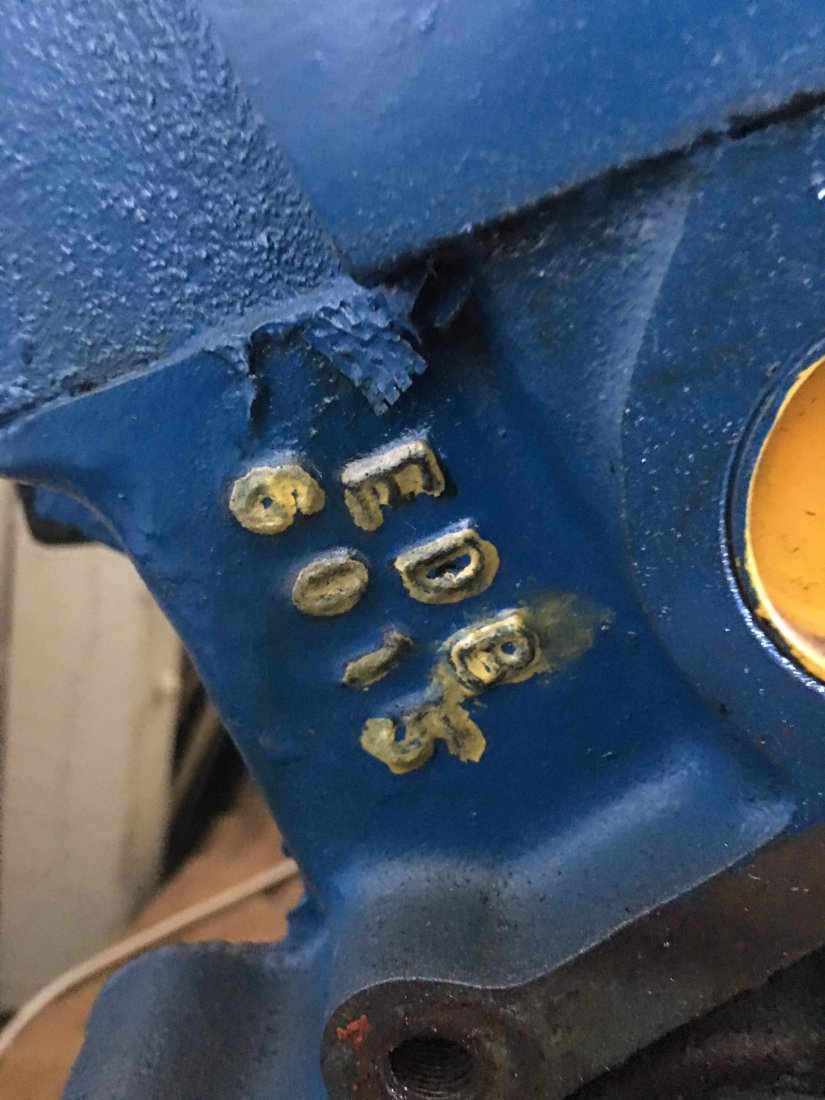

Hi and thanks for entering your forum, I have a casting number that makes no sense at all!
EDB 6015
I have been trying to search on this number, and all I get back is that it is a Y block
It is not a Y block, have anybody got an idea about this number??

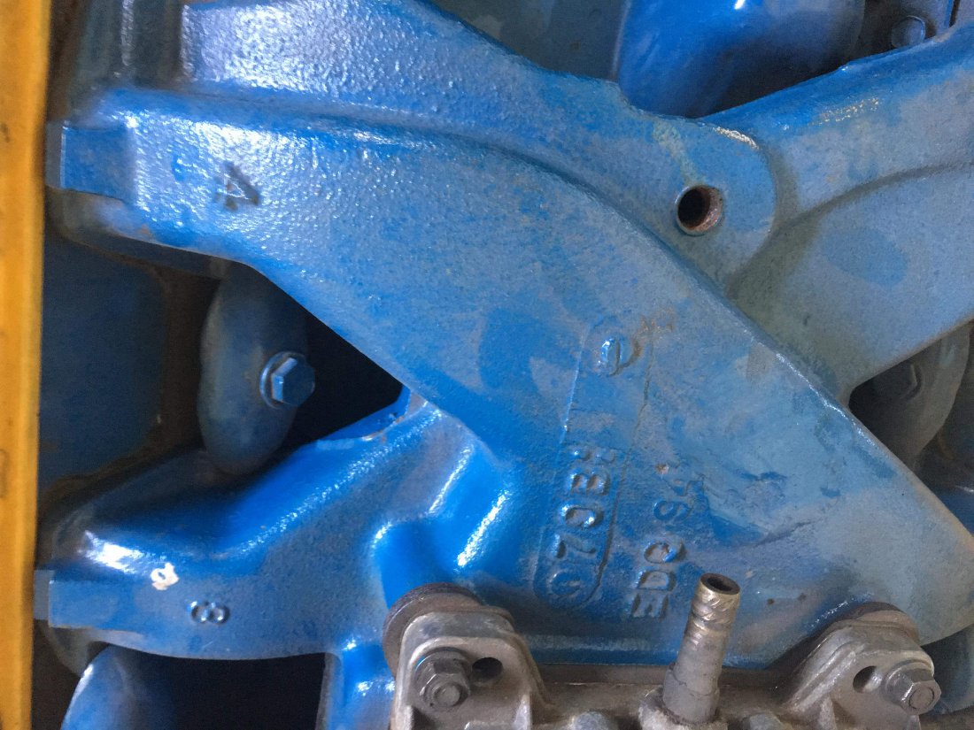

Re: Casting number EDB
Looks like your intake is dated October 12, 1957. If that block matches it is an early 58 which was just before the "box car numbers" 575XXXX. I have heard of some 430 blocks going .120" over and stroked with Jahns pistons. My 1960 - 65 blocks have been good for .015 to .080" over. Maybe yours is one of those extra thick blocks?
