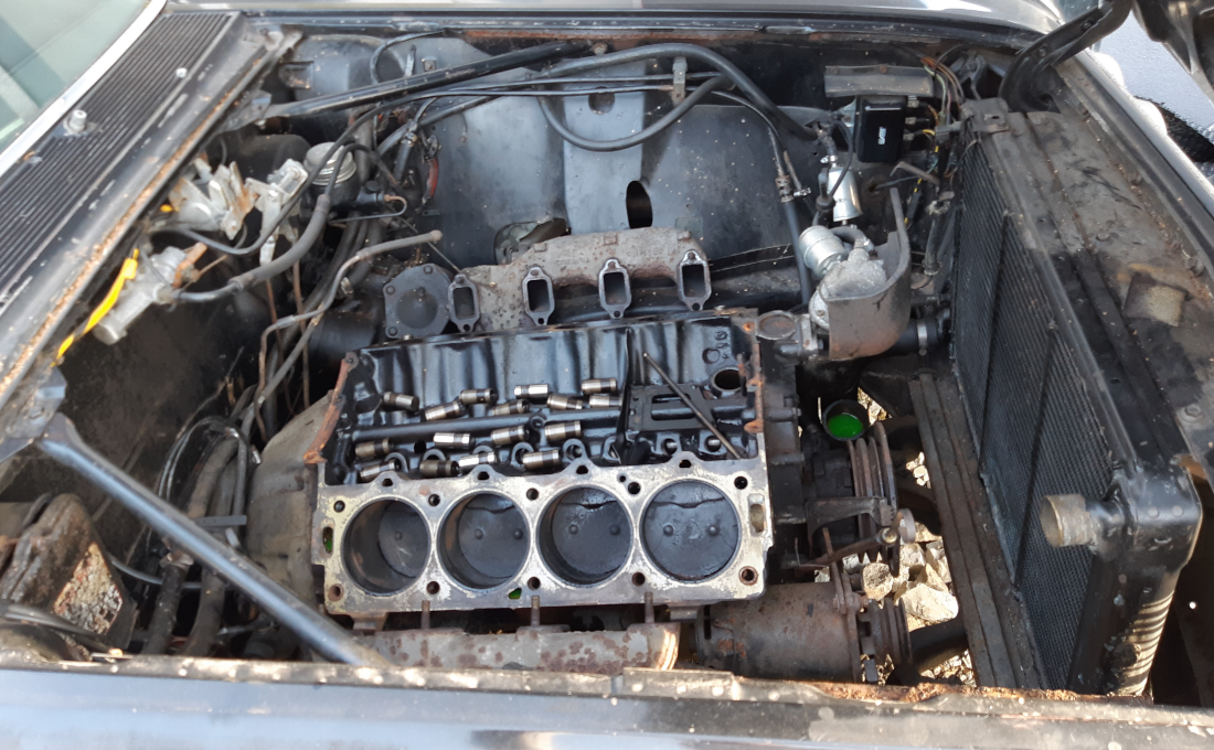

Thanks Chris430 for comprehensive information. Starting point for rebuilt was not sufficient lubrication at valve train, finaly we have found oil passage were blocked. On this occasion I will rebuild it to stock. Presently we do all required measurement. Reading attached posts on stock pistons I think will keep original one. Here is the picture before engine removal.

Post by Cafar » Thu 27. Dec 2018, 10:01
This is it.

Post by Chris430 » Wed 2. Jan 2019, 20:19
Looks like a normal 58-62 430. Do you still have the 2 barrel? If you want a 4 barrel and by chance you have C6VE (462) heads I have a 462 intake you can have for shipping. I am pretty sure it will not seal on any early heads, has ro be 462 small port heads. Same goes for 63 4 barrel, if I still have it.
