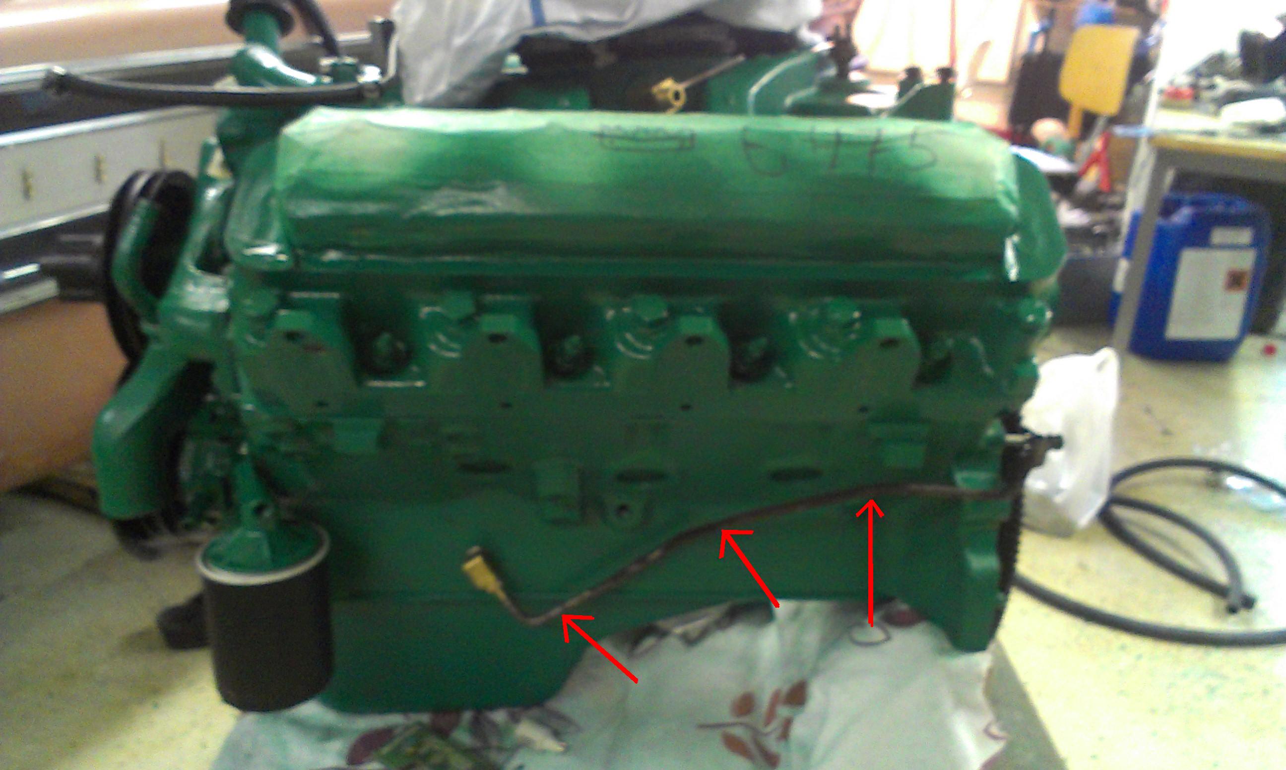

Here is the picture with the pipe marked...

goes to the vacuum wiper motor. do you still have the vacuum pump on the bottom of the oil pump

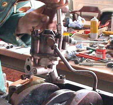

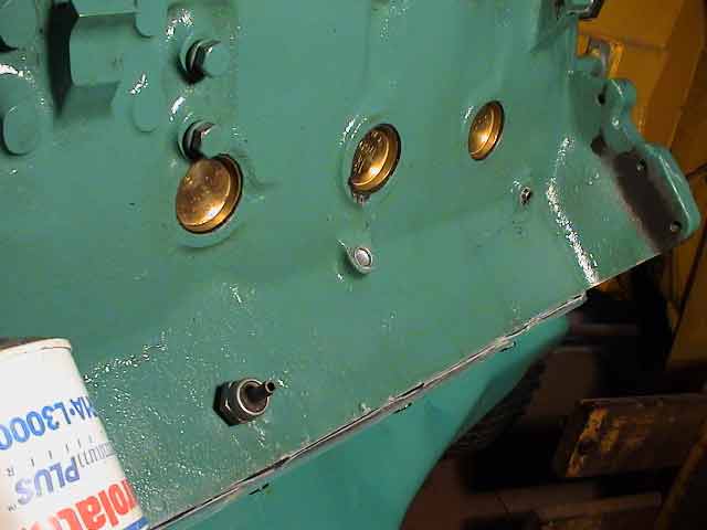

Like he said. I think it was also supplying the car's unique central ball joint lubricating system. Not sure if this is s.th. that I read in the driver's Manual. These pics are made a long time ago, so I might miss on details. The first photo shows the nippel where the rubber vac. hose gets attached.

Simply block the nipple if you're not using a vac. pump. The nipple would normally inhale air w. the vac. pump connected. If no vac. pump is installed air (oil steam) is escaping out of the crankcase. Not ideal if you have the nipple connected w. a hose to the vac. canister or other devices. This oil steam could als be drawn all the way up to your brake booster if it shares the same vac. path. Just block it and take a few spins and watch your tail pipe.

Glad it solved the problem. The nipple and the vac. pump thing has nothing to do w. the crank case ventilation. Blocking the nipple won't do any harm to your engine. Since there is no vac. pump attached it's simply a hole in the wall.
