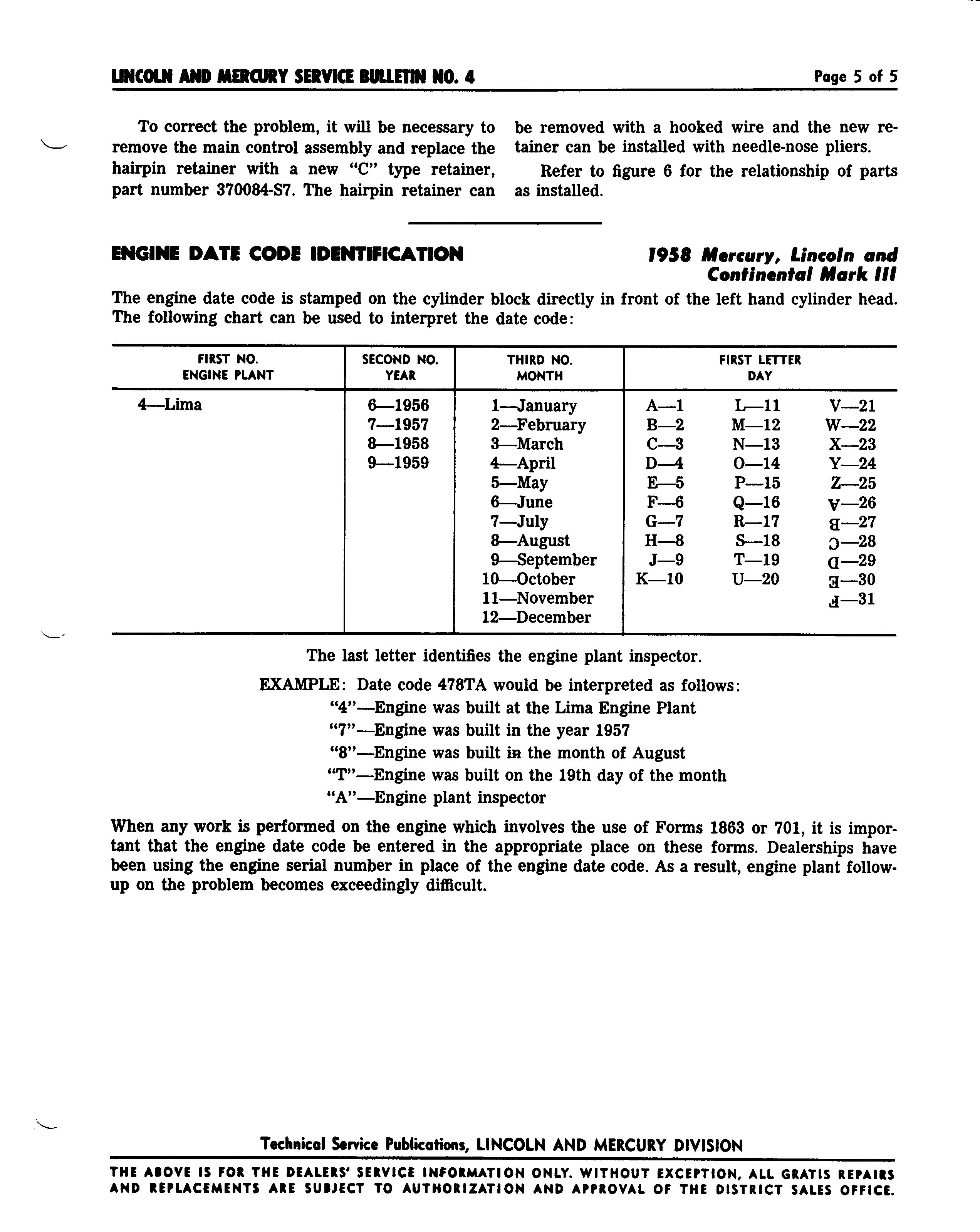

I doubt that it would be coded B9 since the 410 was only used for the 1958 year Edsel.
Here is a scan that might help at least for the 430.

The Sommerville plant ended production in October of '57. I don't believe that there is anyway they could have put a '59 date coded engine in your car at that plant. In all the books I have they refer to B9 as being a '59 part number.

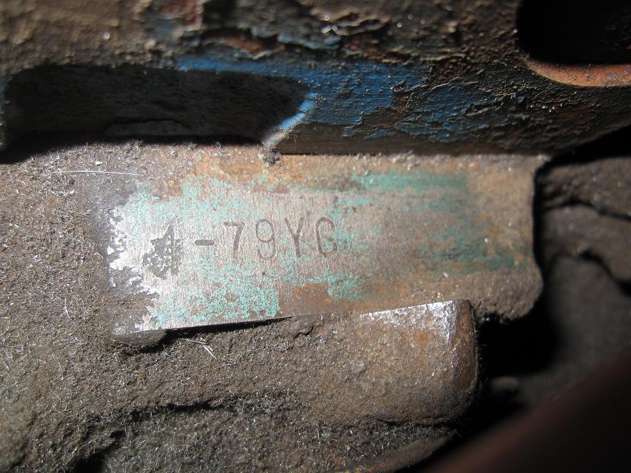

I would check the car's build date off the vin plate and compare against the engine final assembly date. That will tell you how many months difference you are looking at and if the chronology makes sense. In my experience with 1958 430 engines, they were final assembled ~2-4 weeks before the car was assembled. You can also decipher the date codes of the engine parts (block, heads, intake) and should find that they were cast ~1-4 weeks before the final engine assembly date.
Enigne final assembly stamp- just in front of left cylinder head.

The final assembly date stamp is:
L210 4-95 v v
And the castnumber is:
B9ME-6090-B
95 F:1
11
And the cylinder heads is casted with the same castnumber and another same number but with diffirent letters in the end:
B9ME-6090-B
And then the difference:
95 P on one of them
95 T on the other one
And it seems it had a less seriosely overhaul because I found aluminum foil over the whole line but just on the parts that can be dismantled...
I've realized the enginge has been swapped, but it doesn't means so much to me for the moment, it's maybe easier to find parts to the 430...
