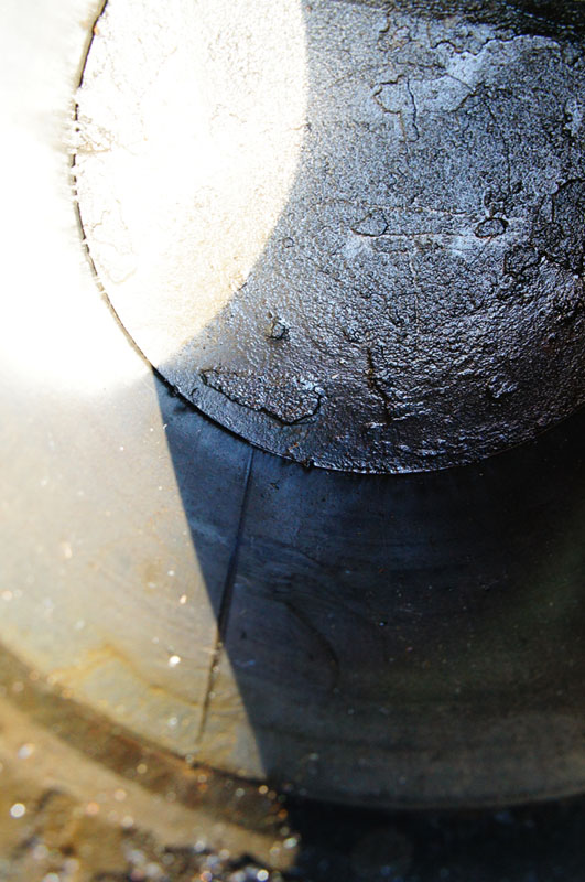

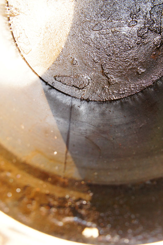

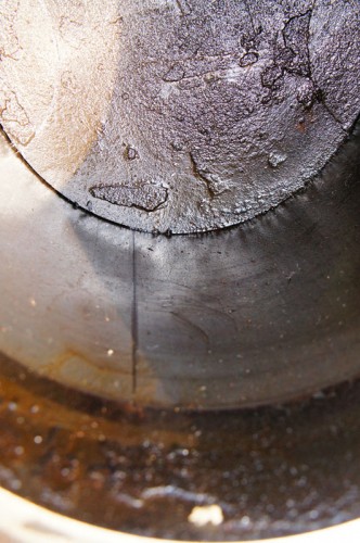

Post by 63lc58mk3 » Wed 28. Mar 2012, 22:48
Here are some pics.

Post by Theo » Thu 29. Mar 2012, 00:26
What do you think, is it a piston seizure or does it go deeper like a crack? A crack wouldn't be that straight, but you never know.

Post by 63lc58mk3 » Fri 30. Mar 2012, 00:08
It doesn't look like a crack, is it possible that a broken ring could've done that?
Re: '58 Block
Post by Theo » Fri 30. Mar 2012, 01:25
In some cases, where the bore is miked O.K., it can be sufficient to just hone the bore. I assume that your block has seen quite some mileage, so boring and honing would be your option I guess. Again, it's better to let a machinist inspect the block.
