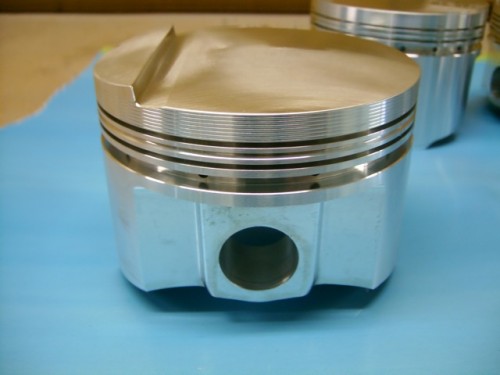

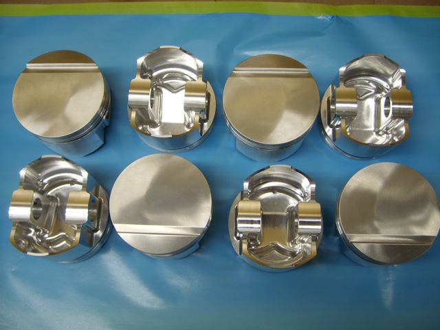

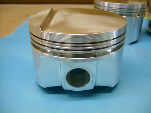

Progress is starting again!!!
The Pistons are in. These are the second attempt.
Looks good. Please let us know if they measure as needed once you do a mock up. Hope they made them correctly this time.
How much did they charge for the pistons and rings? I would also appreciate if you can tell me compression ratio you ended up with. Thanks
