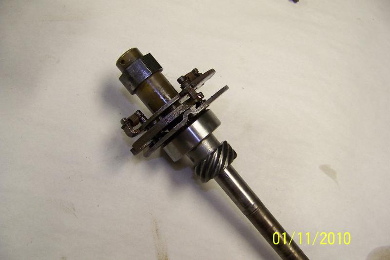

A couple of pics of the mallory dual point distributor... on the marine engine, the tachometer is not electric, but mechanical., so there is a tachometer drive off the distributor. I don't know if that is the case on the automobile engine...
Marine mallory dual point distributor detail... tach drive

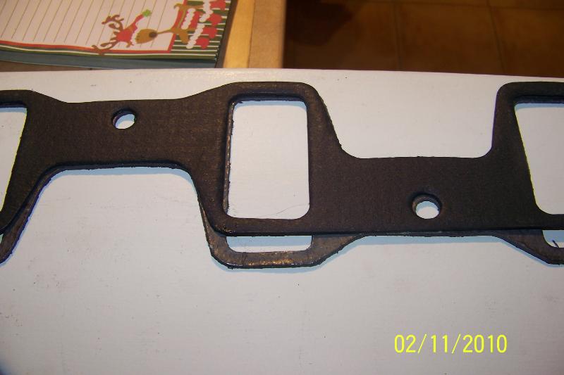

So here is an interesting little issue.... One of the things that is confounding about the MEL engine family is how much change there was between years. It certainly would have been a problem for aftermarket companies as well.
Here is a comparison between a FEL PRO intake gasket set I bought a few months ago, and a NOS 1958 Mercury intake gasket:
Intake gasket comparison: larger is 1958-59 430 engine

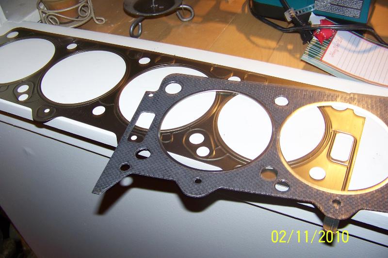

Look at the difference in the size of the ports!!! Needless to say, the super marauder intake and the 1959 heads I am using take the larger gasket. I also obtained a NOS 1958 head gasket which appear to be cadmium plated, and is steel.
modern replacement head gasket & NOS head gasket 430
I measured both head gaskets and found there is a difference, albeit uncompressed, of .0010. Looking at the way both gaskets compress, and the thinner part of the steel head gasket, I would estimate the compressed difference is somewhere around .0015 .... I can't compute what the compression effect would be, but it would be there.
