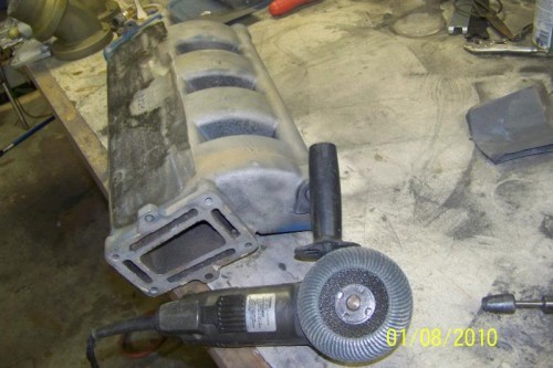

Some updates, I have be remiss... I took apart my water cooled exhaust manifolds, glass bead blasted them, then primed them with a two part interlux primer. The primer contains phosphoric acid, so it bonds to the bare metal. This was followed by two coats of primocon by interlux, an underwater metal primer... excellent stuff. The zinc chromate in the etching primer makes it appear yellow. The primocon is the silver.
- Chris Craft manifolds in primer
I used a sanding disc on my grinder to sand out casting marks and get a good finish on the manifolds. Fussy, but I think it's worth it in the end...
- 430 marine exhaust manifold
Here is a finished manifold, a little paint touch up to do, but looking good. I substituted stainless 316 cap screws for the original steel ones, and left them bright.
- finished marine 430 manifold
