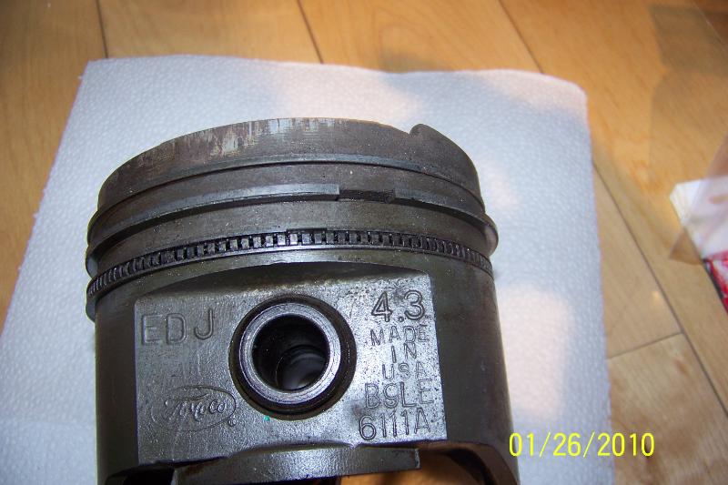

1959 430 cid MEL Piston casting numbers
Piston: EDJ B9LE
Piston: EDJ B9LE
Piston picture:

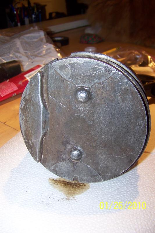

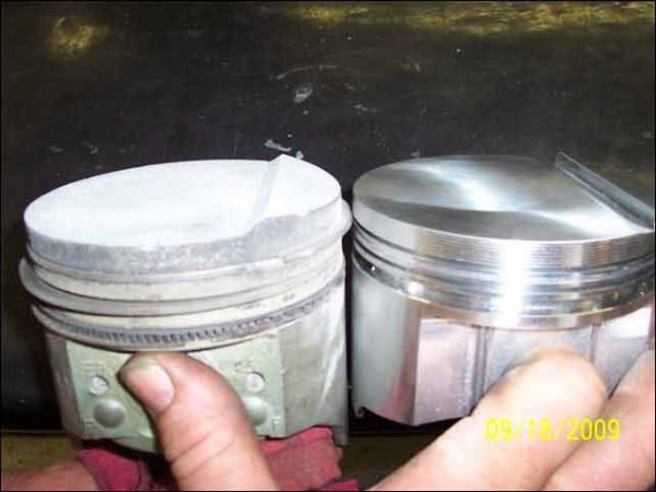

Interesting photo. If you look at that piston top and the one I posted out of the Colony Park, they do look different. I've contacted my restorer to see if we have a better photo with the numbers on it. Someones thumb is covering the numbers on the posted photo.
Your piston
My piston out of my Colony Park (left piston)
Your piston

Well we have poor results on the pistons. From the new pistons we received we only had a 9.625 compression. We are now going back and getting another set from a different supplier. Guys when this is done hopefully it will save some of you the time and trouble we have been going through. Delays, delays, delays... It looks like we'll have completion sometime this summer of the restoration.
Sorry to hear about your new pistons not being correct in compression ratio. Spending mucho $$ and getting second best sux. Who went wrong? Did you provide the piston manufacturer with numbers based on measurements taken or did you send in an orig. piston?
Anyway the 9.625 :1 compression of the new pistons seem to be usable with todays fuel quality. You won't have ping problems typically associated w. higher ratios from 10:1 and up. Also keep in mind that many aftermarket street cams are designed to work with ratios of 9,5:1. Short duration high lift street and RV cams are the ones that propel old dinosaurs from one traffic light to the other.
