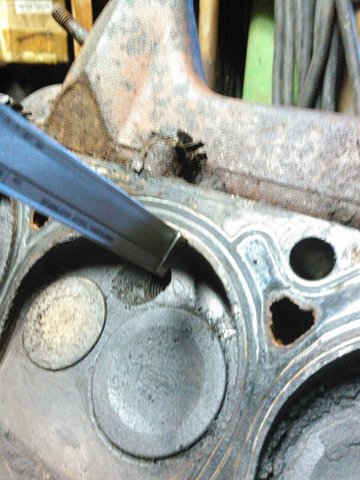

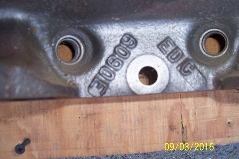

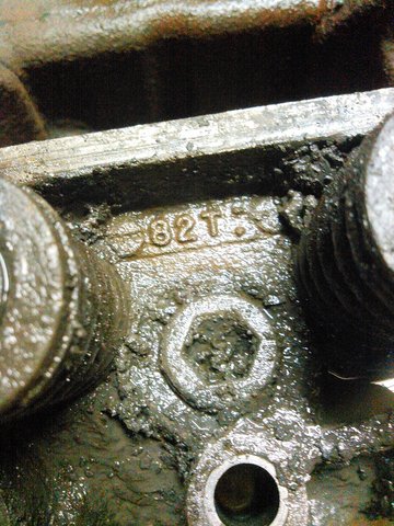

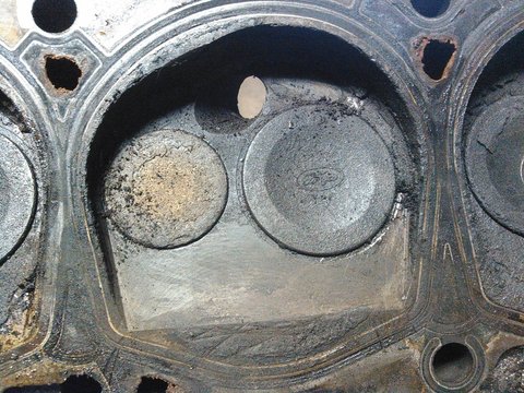

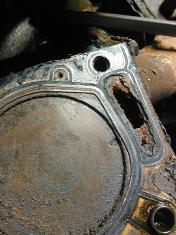

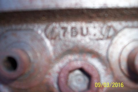

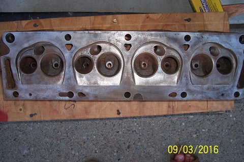

Straight cut 58 332 head and the 59 Thunderbird head with the unshrouded exhaust valve. I have seen three different 58 Thunderbird 352's with this combustion chamber shape. My 2v 332 and Thunderbird 352 were both 74.5 cc's.
Five 1958 332 2 barrel photos:
Three 1958 Thunderbird 352 photos:
edc heads 003-1.jpg (42.1 KiB) Viewed 12890 times
edc heads 002.jpg (29.85 KiB) Viewed 12890 times
