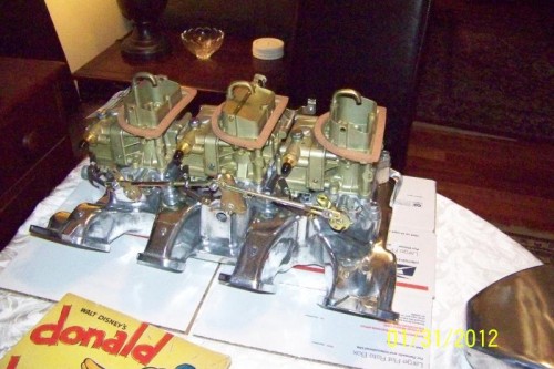

Well, just a little soft update... Joe Bunetic has my intake manifold and is building my tripower and linkage right now. I'm looking forward to seeing his work...

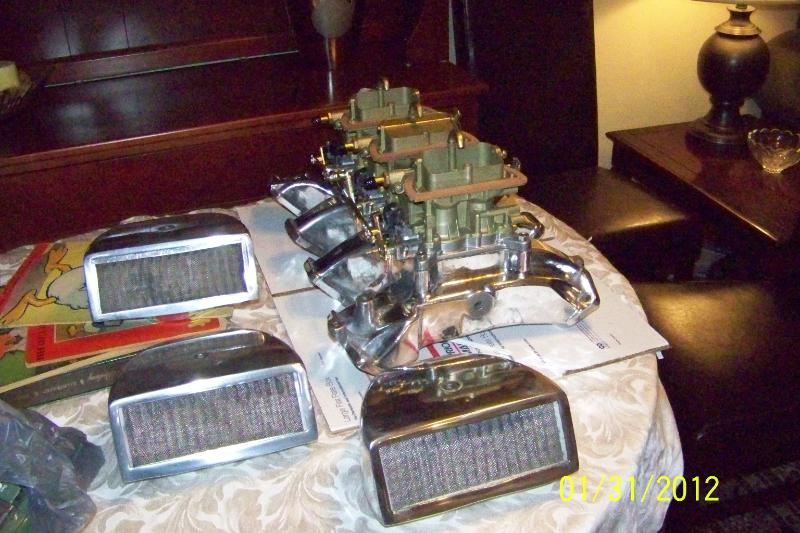

Joe Bunetic was busy over Christmas with his family and the usual, and I was in no hurry particularly to get my intake with the carbs built, but here they finally are. Also shown are the Nicson Beehive marine flame arrestors.... note that spacers will have to be made to offset the breathers so they fit... but I love the look. Man, Joe does very very nice work.
Re: Chris Craft 430ies
Absolutely beautiful. When you get a chance please send me his address. It's now time to get my Parklane set up going....

Joe is an interesting guy... very modest about what he does, and very fussy. He sent me photos before he sent the assembly back, and told me he assembled them, and didn't like the color, so he took them all apart and had them recolored...
