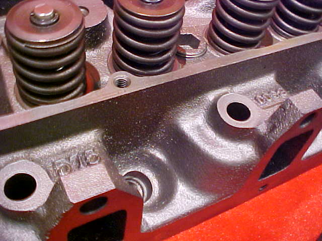

I know the 1958 cylinder heads will of course match the Super Marauder intake ports but what about 1959 cylinder heads??? I know there was a drop in hp etc. but are the heads a match to 58??? Also, what kind of casting numbers am I looking for on the heads for 1958? B8LE??? Not sure, thanks a lot. I found an entire 1959 430 and 58 or 59 heads from Beep above. Just want to make sure '59 heads will match the '58 intake.
John Lyman
Re: 430 heads on a 462
As long as it is from a 58/59 4V, you are OK. There was a very early 430 head that had larger valves but these would be hard to find. The casting nos. will be either the earlier seven numeric sequence or possibly B9ME (59). I do not have the casting no. index for the heads.

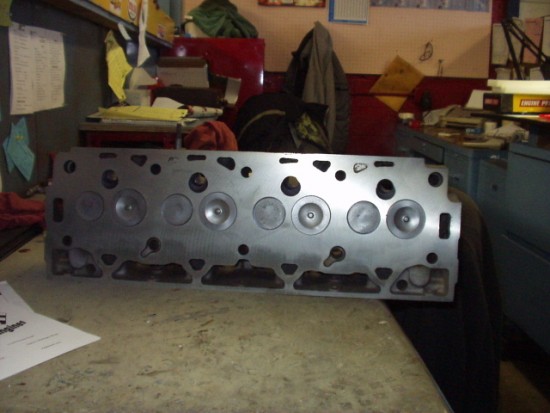

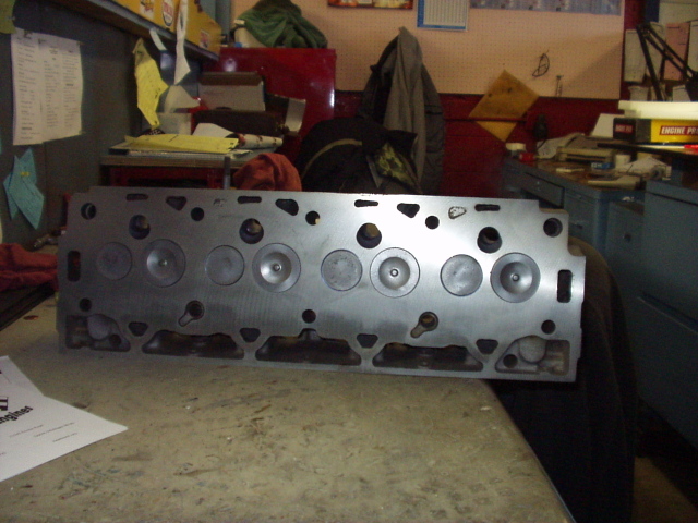

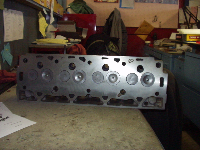

My next question is about combustion chamber in the heads:
What should I expect my 462 to do with flat cylinder heads as found on the 1958 cylinder heads? The stock 462 is already at 10.25:1 compression. After talking to Beep about the heads he is going to sell to me, he mentioned that the early MELs 1958-60, there may be a rise in compression. In 1961 the heads were detuned slightly for less compression at 10.1:1 with slight combustion chambers cut into the cylinder heads (I assume). This is also found on the 462s (not sure how much of a difference but we all know 462s had 10.25 compression. If I swapped to 58-60 heads with no chambers I would without a doubt be over 11.0:1 compression. Beep informed me that a 1962 or newer engine will get approx. 11.0:1 compression with 58-60 heads (I assume he means '62-65 430 motors as be mentioned they have 10.1:1 compression.
With this information...what can I expect my 462 to do? I agree with Brian Estrada (through an email about pistons) that these engines can use a little less compression to run better on pump gas. Over 11.0:1+ would be pushing it wouldn't it? And I am not really sure where the compression will be. Also Beep mentioned that all 2V and 4V barrel 430 engines have the same heads and I would think the same. Hope I did not confuse anyone; if I did I will try to fix it! Feel free to leave your thoughts on this as I would like to buy some heads soon and get hopping on the rebuild. Thanks

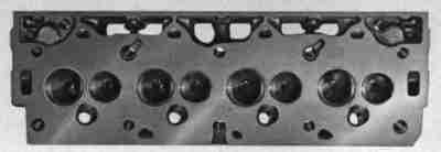

The only heads that have chambers (that I am aware of) are 63/65 430 4V as the piston dome shape was modified to create more of a swirl effect during combustion. Do your 462 heads have chambers?
CR was controlled more by piston dome shape than cylinder volume (I may be wrong here as CR was lowered I assume for the 60/62 2V).
The early heads will be flat. So therfore with stock 462 pistons, you should see no increase in CR as it was factory assembled.
If anyone has documentation or a photo of any other head than the 63/65 430 4V having chambers, please share it here.
