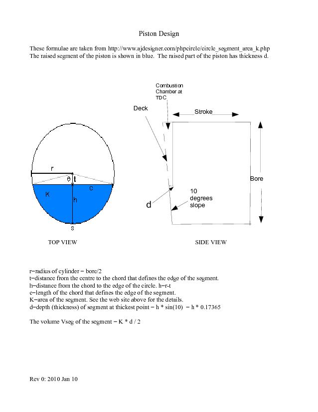

In the process of assembling the appropriate measurements for my custom pistons, I asked my dad to come up with a diagram that would be useful, and typically, he came through in spades..
Thought you guys might be interested.
Once the deck height is established on the intake and exhaust side, and the other relevant measurement are there, here is a spread sheet that will help determine not only the size of the combustion chamber, but also the compression ratio of the engine. Brilliant. I can not determine based on the step size exactly what the change is in compression ratio, and order accordingly. Thanks Dad!
Nice drawing. The piston manufacturers have computer programs that calculate all these things in milliseconds. Do you have the figures at home? Intake side block height and exh. side block head etc.? We might work out a formula to math it out. Just for fun.
