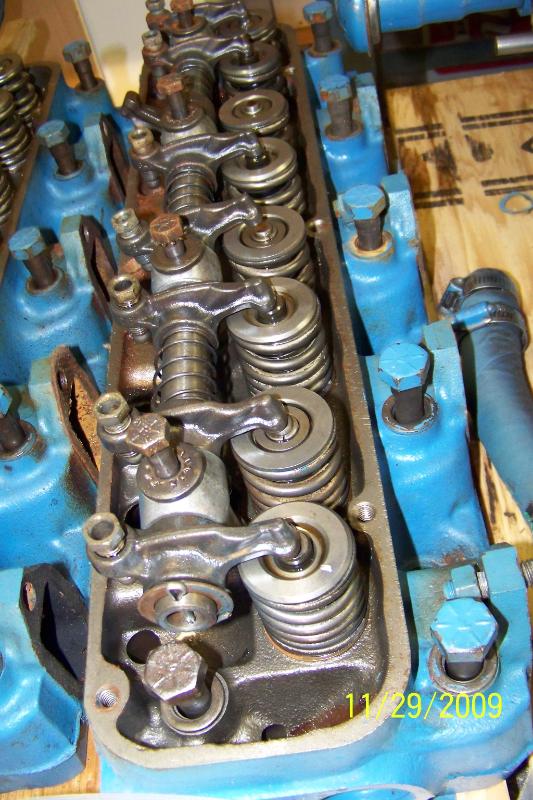

Yeah, I would also like to know a few things.
1. How long is the rocker arm shaft in length?
2. Peter, can you remember in which direction the head gaskets were installed? Can you give us a close shot that shows which direction and which side of the gasket was installed on the block. (Water passages)
3. Can we see a close photo of the transmission bolt pattern?

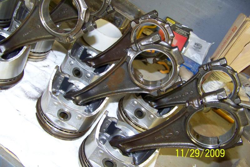

I will post some more pics... as the engine has to come completely apart. This engine was rebuilt with .020 pistons, but they are flat tops, from either Egge, or Kanter. I plan on changing them to .030 Wiseco like the ones Shelby showed us. I will be sure to keep the forum updated. I don't see why the timing set would not work, but as usual, the marine engine is my area, and not the car..

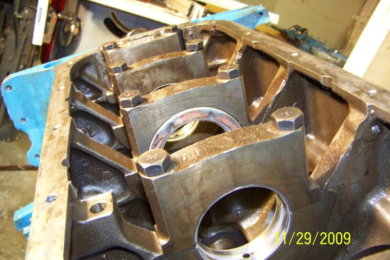

So here we go again... some shots of the block, just for those of you who have not torn down your 430

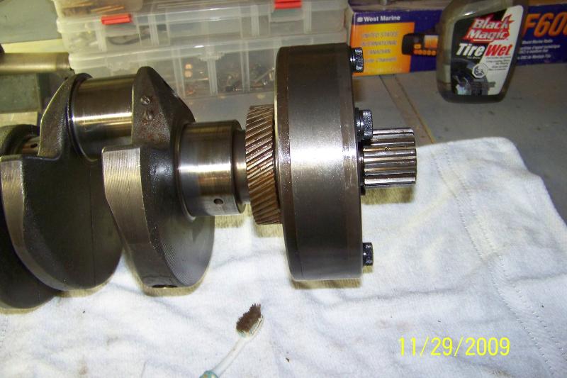

This is the flex assembly on the marine engine, it is inside the machined housing on the timing gear end of the crank..

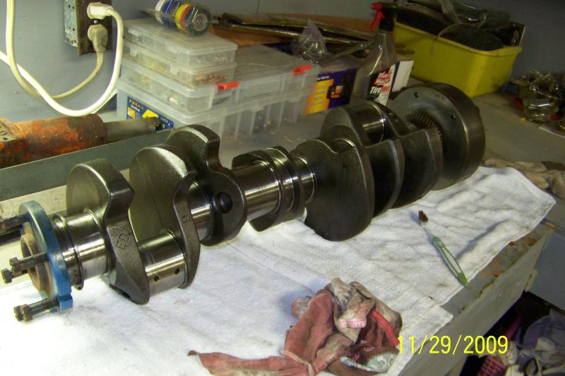

Rods and pistons, which in this case are Egge flatties, .020 over. They are being replaced.

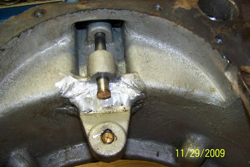

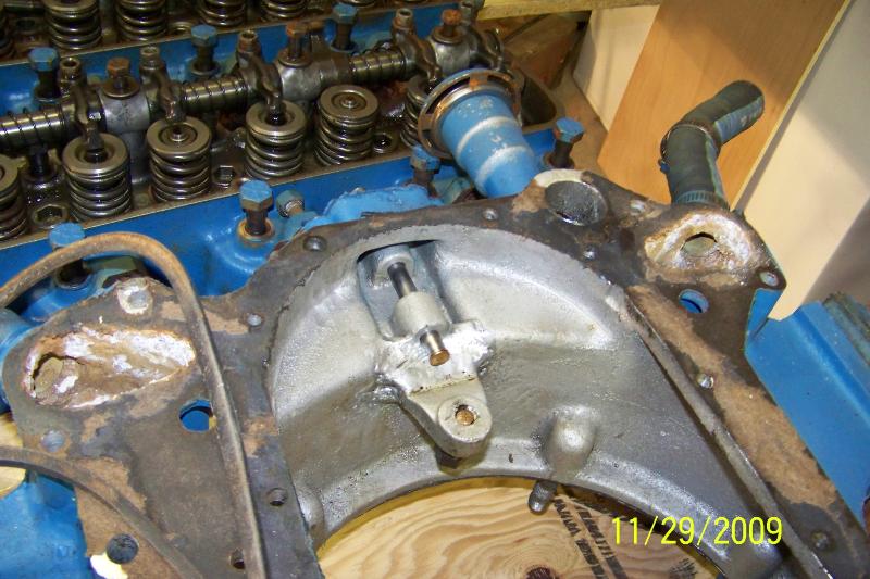

Here is a bad thing... on the housing that holds the fuel rod, instead of finding the right fuel rod, they chopped off the tab on the housing, and inserted a rod that has a circlip sort of end, then had to weld the tab back on. Wrong.
This housing is on the timing end, and incorporates a couple of the cooling galleys.... and also forms the timing cover seal

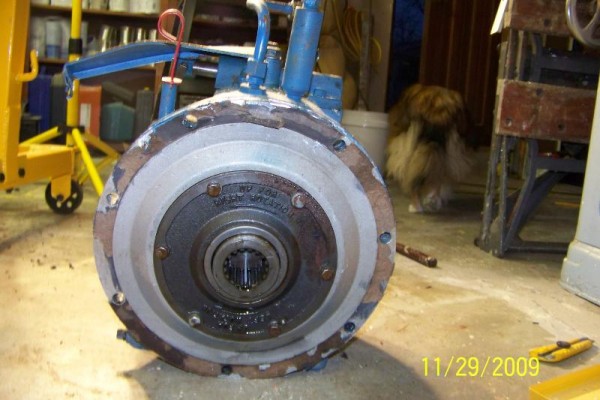

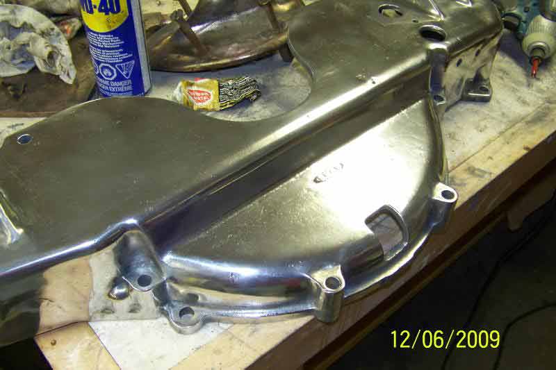

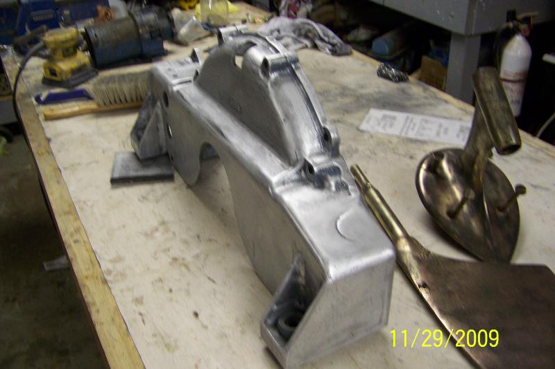

This is the flywheel housing. It is cast aluminum, and like the 'back' housing, I am going to polish it. I have started to take the casting marks and scrapes out of it.

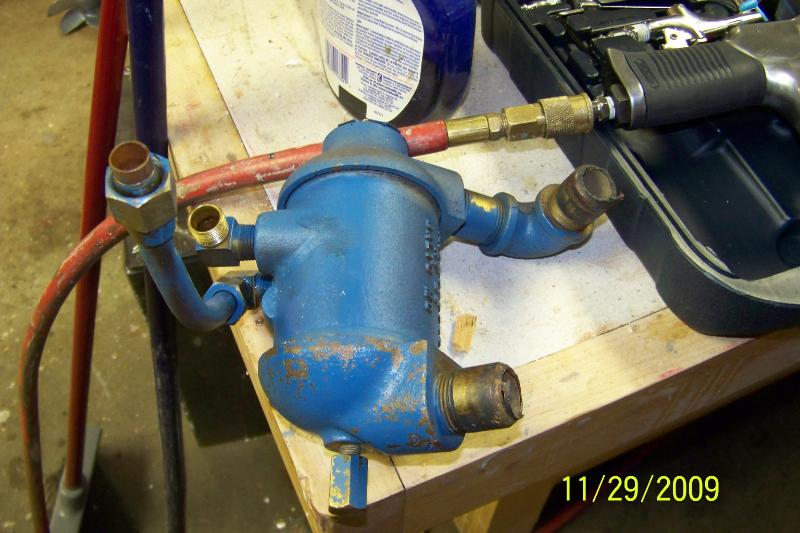

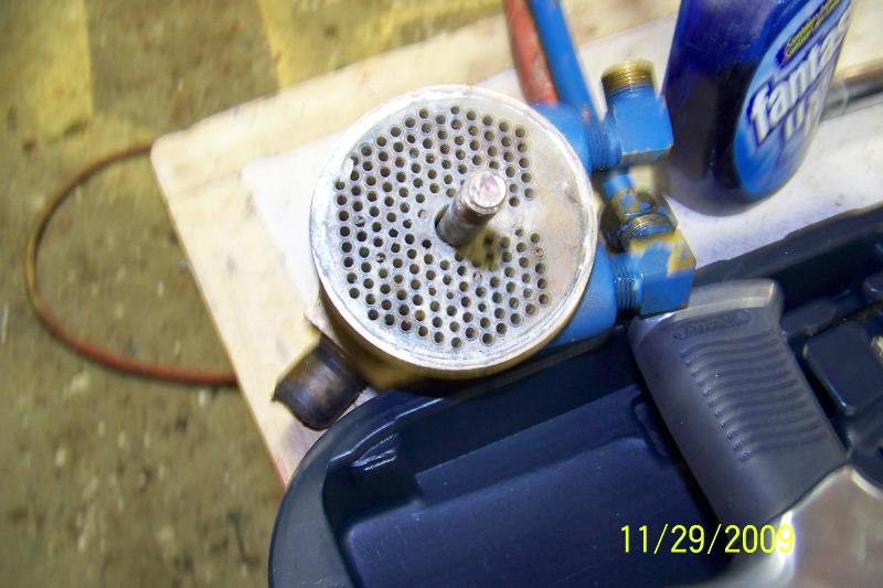

This is one of two solid bronze cast oil coolers, one for the transmission fluid, the other for oil. They interrupt the fresh water line, so they get a massive amount of cooling for such a small cooler. Made by the Gass mechanical corp, Baltimore.

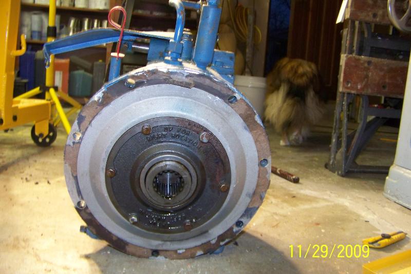

This is a transmission, which forms the final seal around the timing gear end of the motor.
