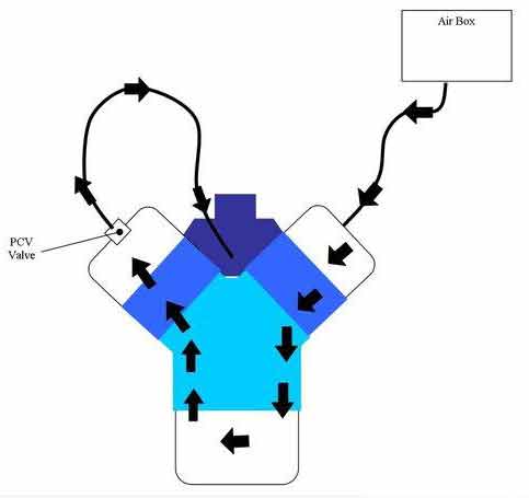

Anyway, here's the way I eliminated my 62 T Bird's road draft tube. Using Shelby Cobra covers things went easy. One bank draws fresh air from the inside (Clean air side) of the air cleaner housing right into the pcv valve which sits in a rubber grommet in the valve cover. The opposite valve cover is connected to the carb spacer by an other rubber hose and a 90 degree tube fitting in a grommet. So basically the crank case gets vented by filtered air which is drawn by the carb spacer connection.

The way I read your description, it sounds like it is plumbed backwards.

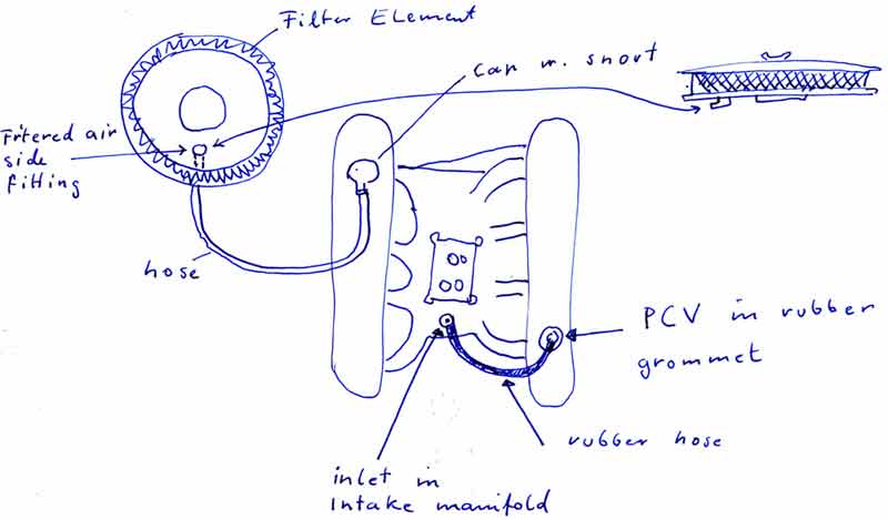

Hmmm, I don't know if it is backwards. I went to the garage to see how I did it. It's been almost 20 years ago so I have to correct my first post a little. sorry. In my installation air is drawn by the intake manifold instead from the carb base. That's because my phenolic spacer didn't have a provision for that. It's the same principle anyway. Here's a cheesy drawing of how I plumbed it up.

Looks good to me , except for the manifold hookup, obviously it worked fine for you, but on some engines you could have issues with uneven fuel distribution. PCV is almost always hooked in to a central point where all cylinders get an equal share of the metered vacuum "leak". Also the Moon valve covers do not have any knock outs , and if someone is contemplating drilling a hole in stock covers, you should have a baffle in place so you do not vacuum up oil ,on the valve end at least.

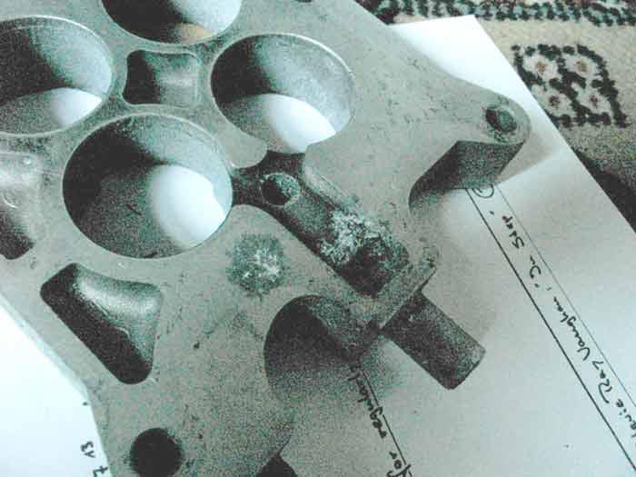

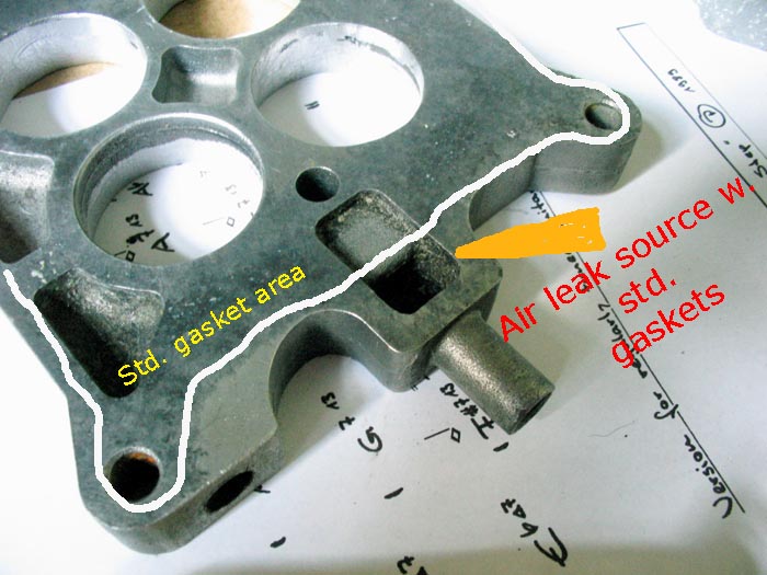

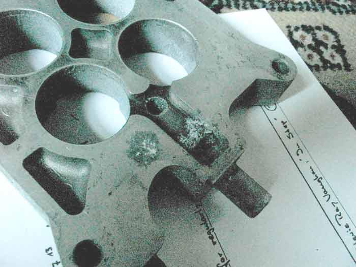

Went to my garage and took a look on a few left overs. My orig. 62 T-Bird spacer (see pic) only routes to the secondaries. I had a serious air leak when I purchased the car 20 years ago. I replaced the carburater gasket several times w/o any change until I realized that the spacer was routed in a way that it makes the usage of an original curved Ford gasket mandatory. You usually don't look under a carb base.
The other FoMoCo spacer I found (not sure what car) is doing the same thing from the rear as well. However at least it tries to duct a little more efficient. Yeah, old cars are les than perfect. We love them as they seem to be similar to ourselves.Ha Ha.
