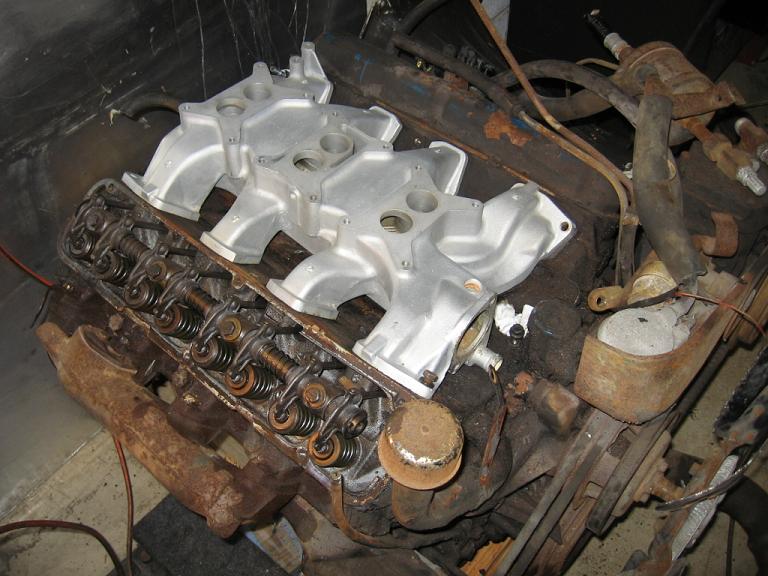

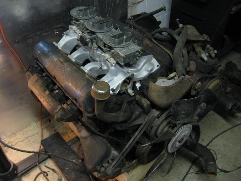

Well...its done! I have carb pad measurements. Now the 3x2s is pretty dead on but the single 4V was rough since the pad is so low it actually bumped the straight edge up a tiny bit for the 'A' measurement. The intake ports literally are in the way almost the entire way across the front but there was one narrow section that was about level with the pad. NOTE: When taking the measurements I measured from the bottom center lip of the valley pan which is budded up to the top of the block. I had to do it this way since there is a valley pan. If this is not the correct way to measure the carb. pad height then please let me know. I also measured the Intake Ports for both intakes. I believe I followed KULTULZ directions! Hope this helps WerbyFord!!!KULTULZ wrote:
1967 Lincoln Continental 4V Carb Pad:
* A: 7.70 cm
* B: 15.00 cm
*Carburetor Pad Heightt= 11.35 cm
1958 Super Marauder 6V Carb Pad:
* A: 11.00 cm
* B: 16.70 cm
*Carburetor Pad Height= 13.85 cm
1967 Lincoln Continental Intake Port:
* Width: 2.9 cm
* Height: 5.4 cm
1958 Super Marauder Intake Port:
* Width: 2.9 cm
* Height: 6.6 cm
Quite a bit of difference in height between the two. I am going to ask another question even though I am not doing this but am curious...What would I expect the 3x2 intake to do on the stock 462 heads? There would be a lot of wall pounding on the cylinder head. Not sure what would be the benefit for that. Also, why did Lincoln make them smaller? I just wanted to get some of these answers in one place if I can. Thanks
Here is a new photo of the intake on the spare engine I took the measurements off of. I might yank the cylinder head off tomorrow to get a closer look.

Significant difference. The intake would not work properly on the 462 heads.buddy67lincoln wrote:
* Width: 2.9 cm
* Height: 5.4 cm
* Width: 2.9 cm
* Height: 6.6 cm
The runners were reduced in size as the early MEL was considered a performance engine whereas the later LINC (61/68) was more of a production engine and the smaller runners are for more low end torque and fuel savings.
