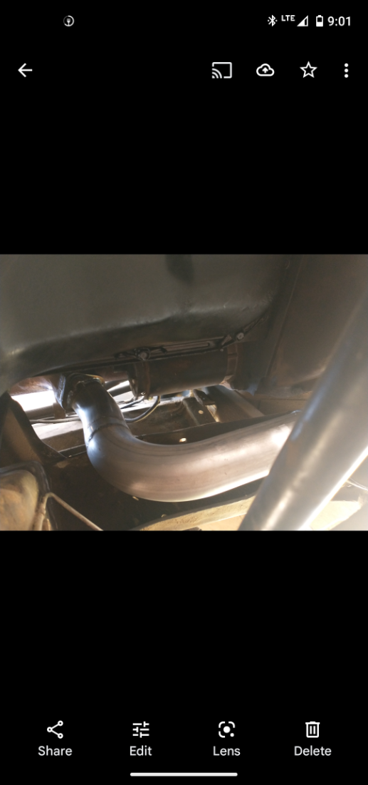

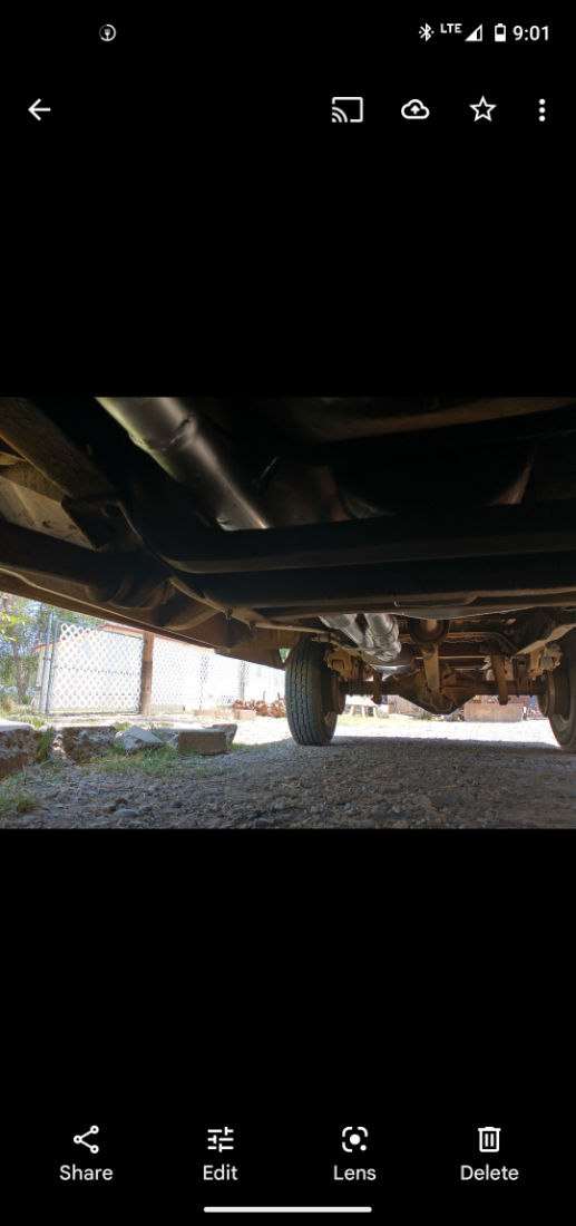

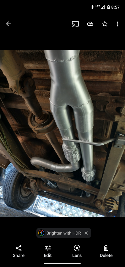

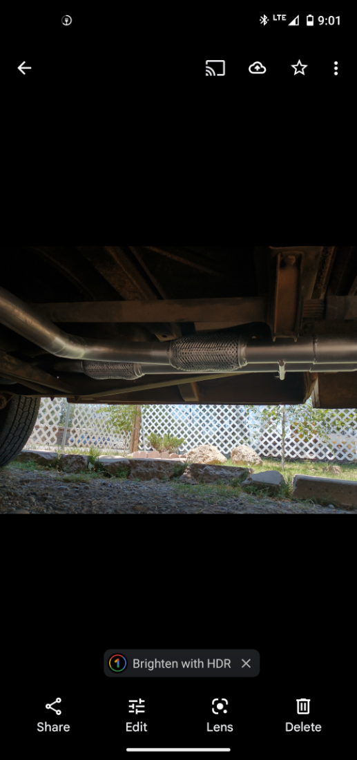

Got my exhaust done on the Edsel / Mercury exhaust manifolds. They fit the truck well, the exhaust man was able to jog around the starter Bendix. Also had to cut a corner off of the driver side engine mount to make way for the flange. I used the factory 63/64 352/390 Galaxie engine which allowed the FE engine perches to remain in the factory location. The mesh extensions are a little insurance for the crack prone manifolds. Nice having a quiet truck again.

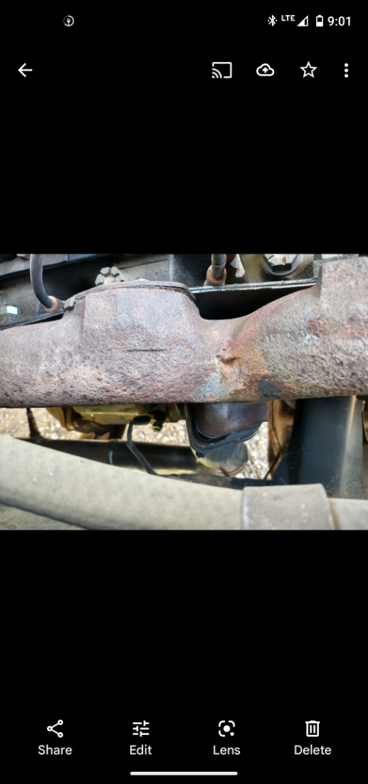

Hey Werby, Message sent. These manifolds were for a 58 year modelnand the exhaust outlet is 2.25 ID. A hand full of folks I found all had cracked manifolds like this. I heated the right side a dull cherry color and braised the crack between the stop holes. So far it has about 3,000 successful miles including an 8 hour trip on it. The 59 Lincoln exhaust were cracked and scrapped long ago. I'll post the 64/65 Lincoln manifolds when I get back to them. The Lincoln's were of the same rear dump design but did have different casting numbers.
EDIT: I am not a skilled welder however I have been able to get by. Out of all the manifolds I remember working on, many of them FE, I have not worked with a softer metal than that of the right side manifold. Although these weren't a date matching pair of exhaust manifolds I have found others say the driver side was the first to break.
