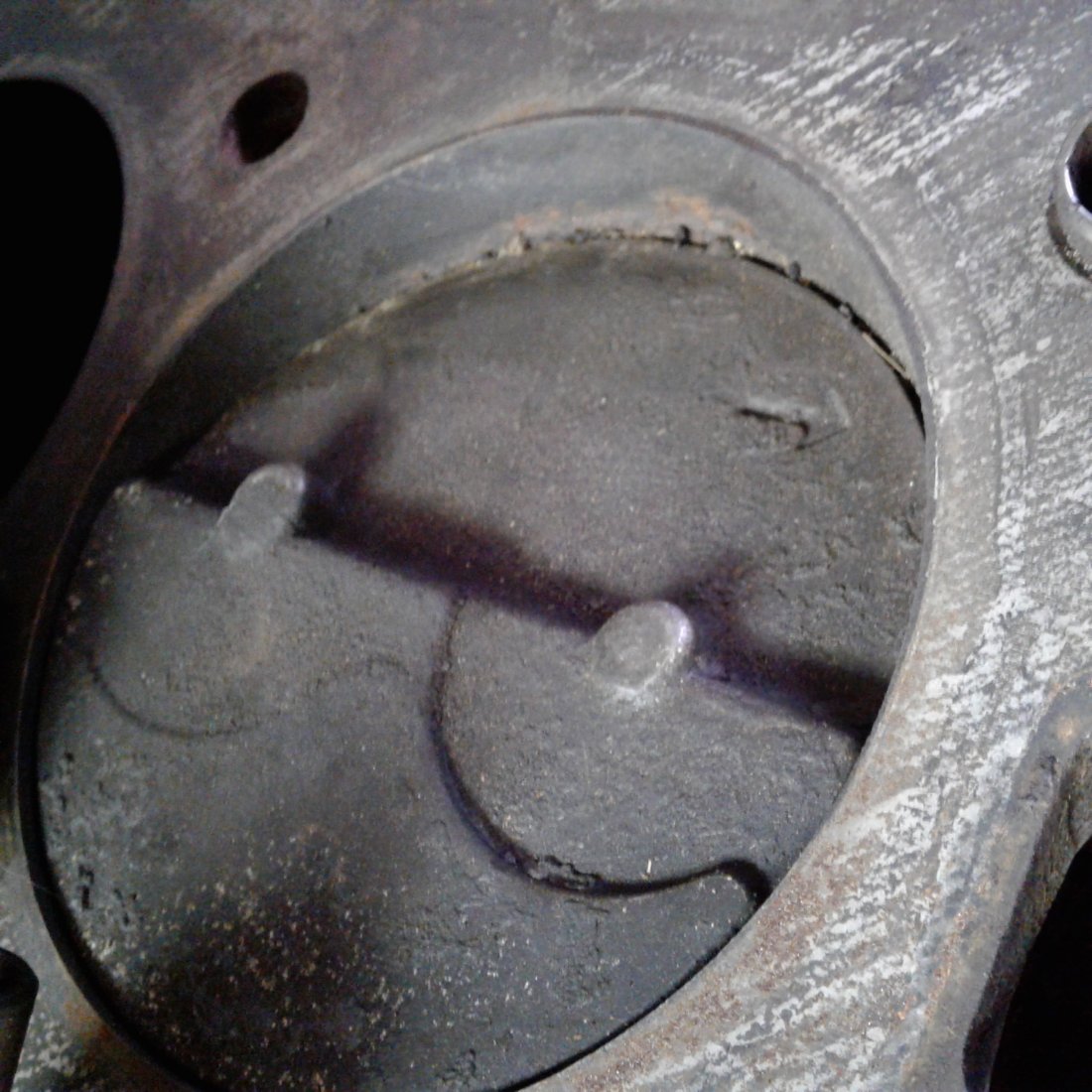

If you have a 1963, 1964 or 1965 430 your original heads will have a small combustion chamber. 1958-62 430's and 1966-March 1968 462's have the smaller step pistons and no combustion chamber in the head. The 430's step will be slightly larger. Pictured is a 1965 430 head and piston.

From what the previous owner has said it is probably a '58-62.We would prefer that it is.
Then it will be true 'angle block' Ford V8.Like the Chevy 348 and 409.
It might turn out to be a later one.
It was a pullout that the former owner took home from a body shop where he saw it.
Said it was too good to junk so he got it.Never did anything with it over the years and gave it to us.
So.When we open it up.Check the HEAD.That will be the difference.First time we have heard of heads with
what looks like a little relief around valves.
Thank you Chris.

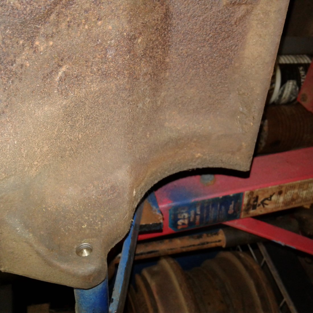

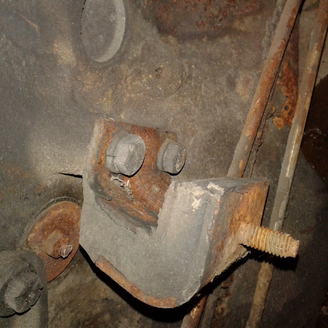

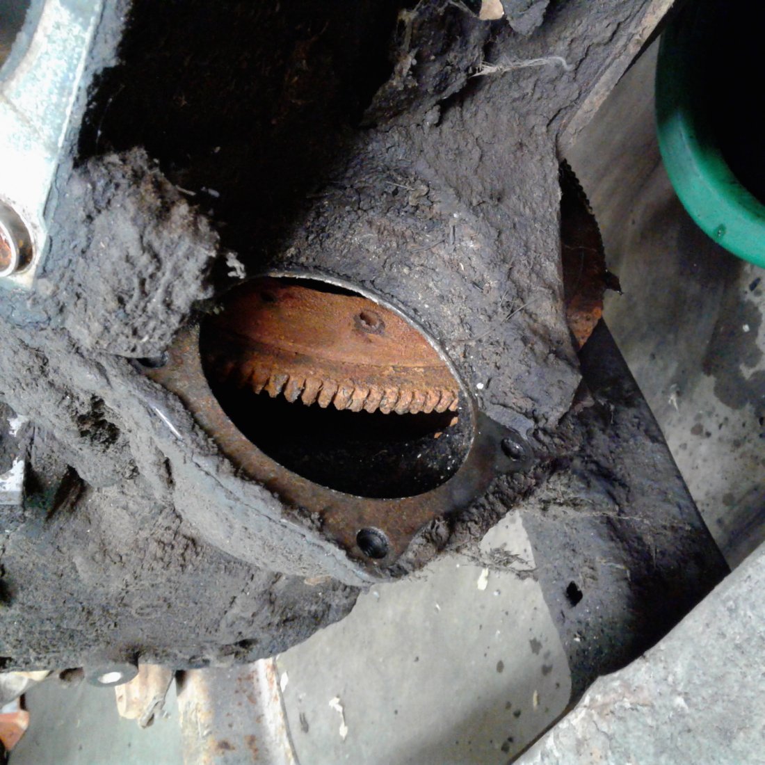

No problem. I am currently working on adapting a 65 MEL to a FE/FT bellhousing. If you have a 58-60 block you will have the FE bellhousing. (See pictures below) If your block is a 1958 it will NOT have the middle side engine mount bosses. 59-68 have these engine mount bosses. 1961-68 blocks have the relocated starter. As pictured 61-68 4 bellhousing bolts and both dowls are shared with the FE. There is no bolt below the starter.
