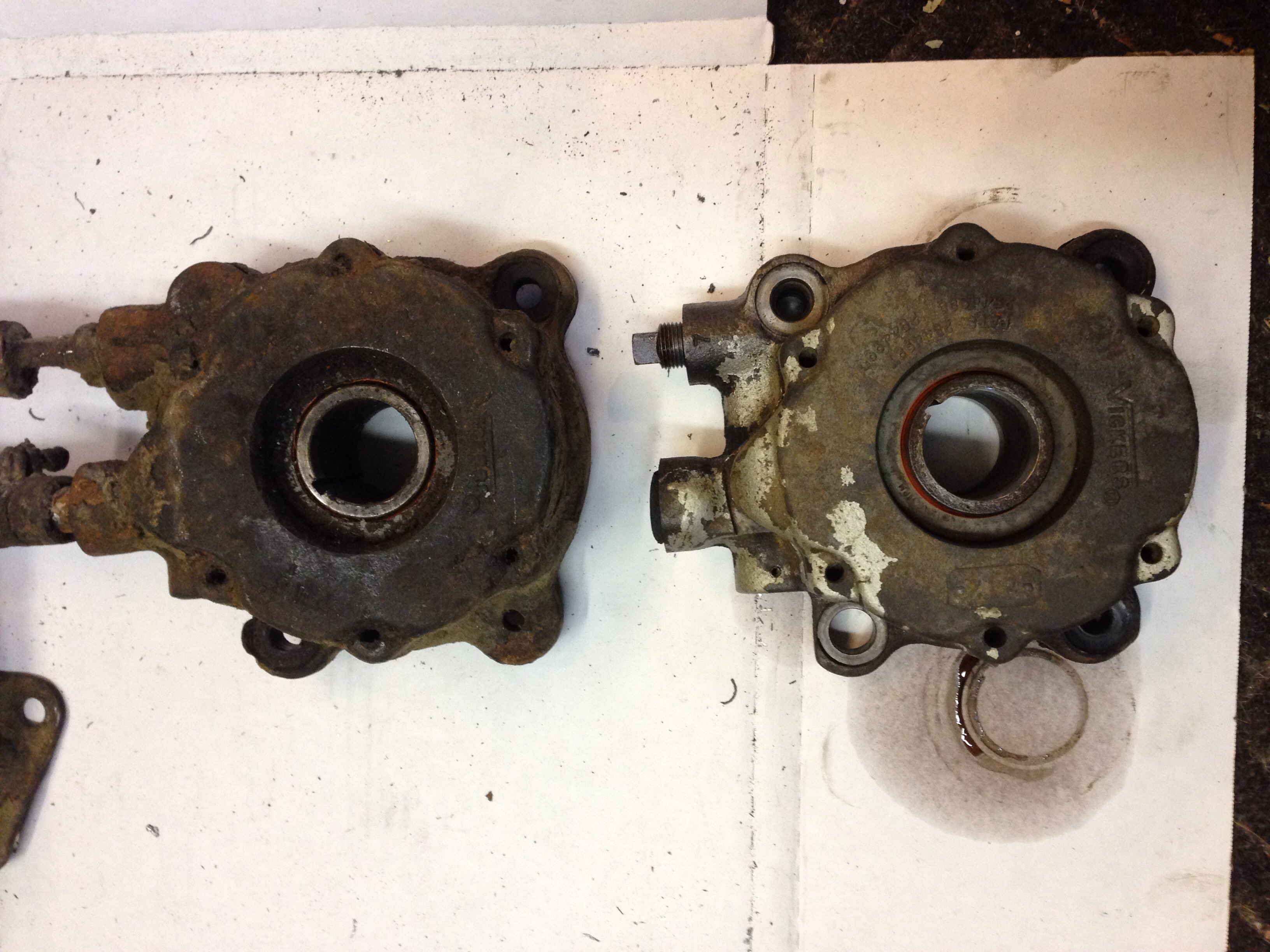

My name is Shawn. I'm new to the forum and I hope someone may help shed some light on an issue I am encountering with my 59 mercury Montclair w/383. I've just finished tearing my 383 down and reassembling it and my focus has turned to the power steering pump. I wanted an extra pump on hand for my own satisfaction so I located one from a yard in California which the fella claimed it was off a 59 mercury w/ a 383. The issue is this one he sent me has 2 mounting bolts with insulators and two other insulators. My original one has 4 mounting bolts with insulators. And this is what my mercury manual shows and tells me.

I have since learned the pump that was sent to me( the dirty one) is off a 58 mercury 383 so the 4 bolt design I have must be 59 mercury only. I have seen a 59 lincoln 430 and the pump has two attatching bolts. Still wonder why mine is different. I'll have to keep searching I suppose.

The below pump from my 63 Lincoln is like the two bolt/two alignment dowl you were sent. The second picture down is a 59 Lincoln power steering pump that is a independent bracket mounted Eaton unit. I know where another 59 Lincoln is that I might buy and part out. If I buy it I will let you know which pump it has.
