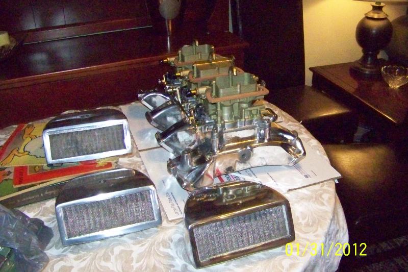

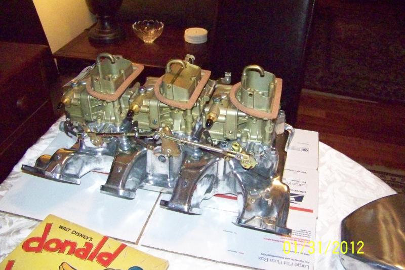

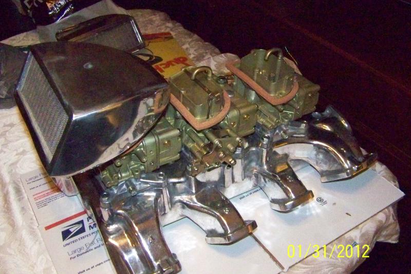

Joe Bunetic was busy over Christmas with his family and the usual, and I was in no hurry particularly to get my intake with the carbs built, but here they finally are. Also shown are the Nicson Beehive marine flame arrestors.... note that spacers will have to be made to offset the breathers so they fit... but I love the look. Man, Joe does very very nice work.

Post by Shelby#18 » Tue 31. Jan 2012, 16:21
Absolutely beautiful. When you get a chance please send me his address. It's now time to get my Parklane set up going....
On another note, I sent you an email about the spark arrestors.

Post by Chris Craft crazy » Tue 31. Jan 2012, 16:41
Joe is an interesting guy... very modest about what he does, and very fussy. He sent me photos before he sent the assembly back, and told me he assembled them, and didn't like the color, so he took them all apart and had them recolored... :o
