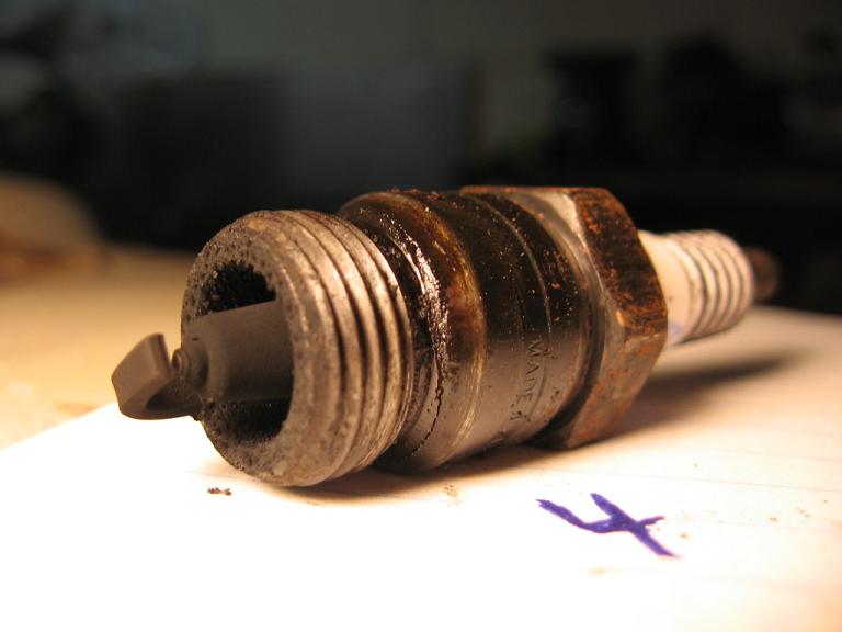

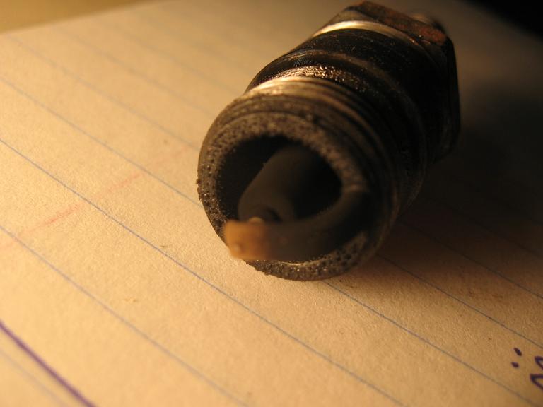

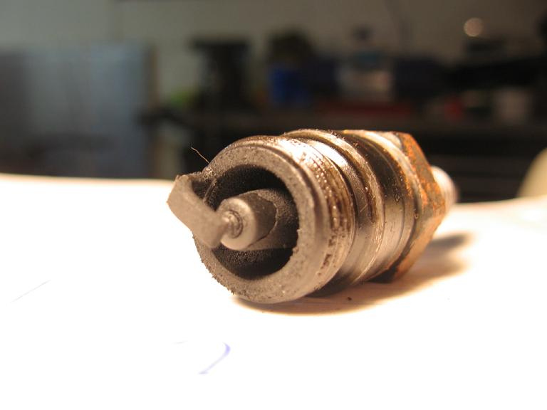

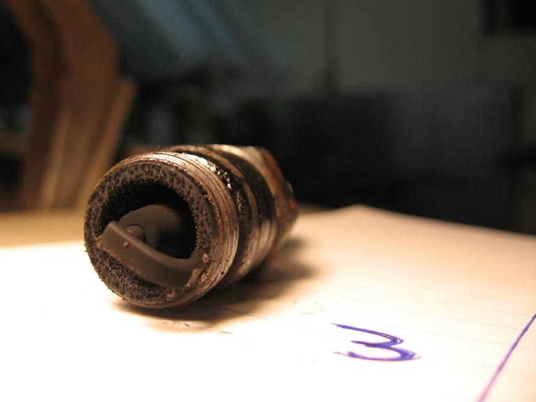

Here is the results of my spark plugs. They were replaced so this is only 2 miles of driving illegally down the street and a lot of time sitting at idle in the driveway. Lots of black crystals so it must be oil. I read the 1967 Service Manual so it could be rings I suppose??? These are 1-4 cylinder spark plugs. Let me know what you think. Thanks

#2 looks like being exposed to a lean mixture, the rest looks like either too fat mixture or burning oil. Both conditions might be the case too. #3 and #4 look smeared with oil in the thread.
I'm not an expert with plugfs and it's hard to diagnose while being distant.

Not a problem. I will figure it out through a friend who is a better mechanic than I am. I just wanted to post what I found. There is oil on the threads like you mentioned especially on #4. Can't wait to pull the engine out and see whats going on in there. Thanks for the helpTheo wrote:#2 looks like being exposed to a lean mixture, the rest looks like either too fat mixture or burning oil. Both conditions might be the case too. #3 and #4 look smeared with oil in the thread.

They appear to be fuel fouled to me- too rich of a mixture or the mixture not being burnt fully-
http://www.gnttype.org/techarea/engine/plugs.html
Oil on the plug threads is usually from an oil leak such as rocker covers.
