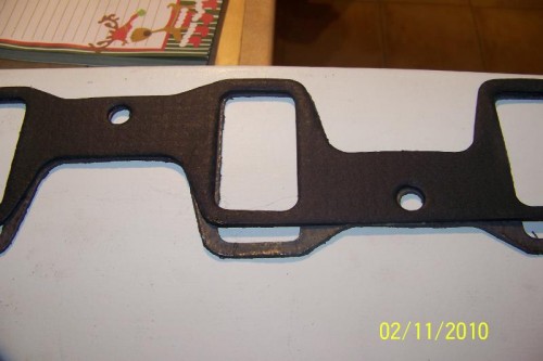

I'm not sure, The 462 heads I have are '67 units and they raised the port floor quite a bit. The '65 heads I have are like the early head ports. If the intake port is also raised on the 462 intake it might leak on an earlier head. Otherwise it will bolt up.
I'm not near the parts to compare, perhaps someone else has already? Photo courtesy of Chris Craft crazy

From memory... you can use 63, 64 and 65 430 intake & heads as a set. The 66 and 67 462 intake & heads have a different size runners. So, the runners in the 462 heads are smaller than the runners in the 430 intake manifolds... resulting in an obstruction of the flow of the air-fuel mixture. Hence the tip to use 63, 64 and 65 430 intake & heads as a set.
