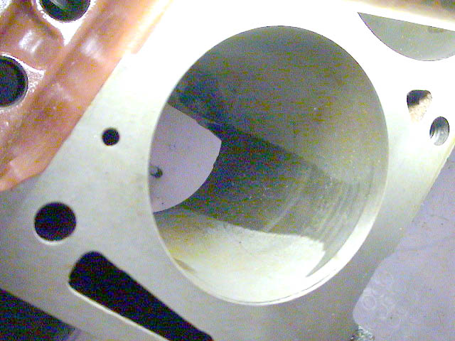

Core shift can vary from minor to exorbitant. Take a look at this FE block that I once built. The pic shows one of the bores after it was machined and bored w. my BHJ "block true" and "bore true" tools. All bores were shifted into various different directions.
If my memory serves me right this was done at 0.030" over. At this stage we took figures and determined that the bores would clear fine at 0.040" final bore and hone.
Only at this "pre" final bore and hone stage you should order the pistons according to the targeted final size. After the pistons arrived they were marked by numbers from one to eight so every individual bore could be honed according to each pistons size.

Post by Theo » Sun 6. Mar 2011, 12:47
Just in case I wasn't clear enough. The above photo of the bore is one of the bores that have been bore true bored to 0.030" over. The dark area is where the cutting tool didn't touch the wall due to core shift. To get the bore completely bored round, we determined that it would take an other step, up to 0.040".
