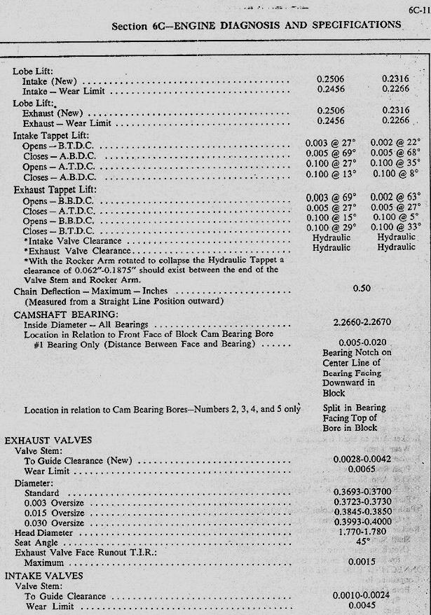

The next thing i did was get my degree wheel and 1in dial indicator out and check what was there.
The only reference i had was an intake opening of 22 BTDC in an old Mitchell Motors manual. i checked most of the cam manufactures and none listed the MEL specs but most of the stock/oe timing of similar size engines of the time spected out from:
Intake Valve Opening @ 18-24 BTDC
Intake Valve Closing @ 55-65 ABDC IC @.006
Exhaust Valve Opening @ 55-65 BBDC
Exhaust Valve Closing @ 18-24 ATDC
It seems a reasonable total around 250 degrees or so. What i came up with was very close but a little shorter with
Intake Valve Opening @ 16 BTDC
Intake Valve Closing @ 55 ABDC .........@.006
i also checked at .050 and came up with
Intake Valve Opening @ 13 BTDC
Intake Valve Closing @ 28 ABDC
wich is very close to the specs given on this site.
On the exhuast i got
Exhaust Valve Opening @ 32 BBDC
Exhaust Valve Closing @ 13 ATDC
and that seemed close enough for the valve timing to be acceptable what gives ?
