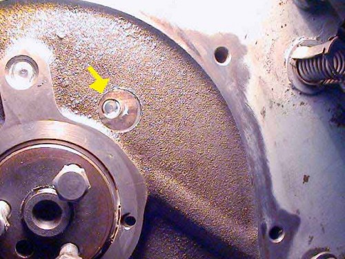

I had to go through my own records to recall a few details about plugs. As you can read and see im my MEL engine build up story viewtopic.php?f=42&t=393
There are two plugs that can be easily skipped by accident.
I assume that you were talking about this plug?
Some machine shops ignore it for a simple reason. Too much time involved to remove and to reinstall.

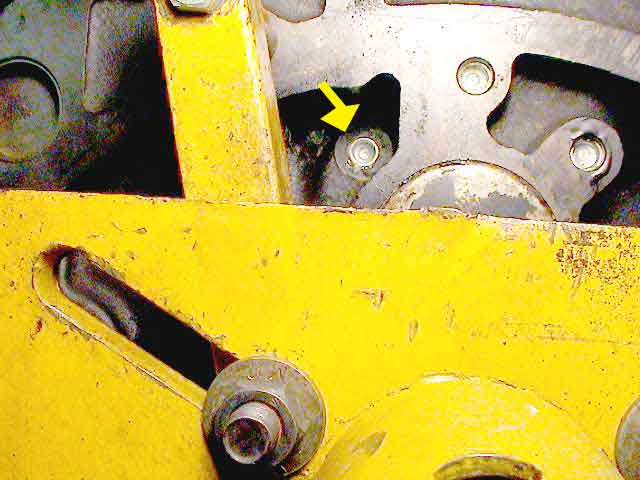

Please take a look at the second photo for an other plug that might get skipped in the process.
Installation seems tricky but is a lot easier than you might expect. Installation of these plugs should take place right after the block cleaning process and right before you put that biest on a stand.
With the engine standing upright on its' bell housing surface the plug seen in photo 1 can be positioned and driven in a lot easier. The same goes with the rear plug (see photo 2) and with the engine standing on its' timing cover surface.
I hope this is going to reach you by time.

Yes, that is the plug, the one in the front , behind the distributor hole. The rest of the plugs were tapped for 1/4 pipe plugs, all except that one, which seemed to be forgotten alltogether! I build a ton of FE's professionally, and they have the same setup, except that hole is tapped from the factory on the FE's. The engine still showed oil pressure during priming, (60lbs) because of the lifters filling most of the hole and very cold oil, but would have been significantly lower after start up and warm up. It did tempt me to tear down the engine and see if everything else is fine. The distributor also covers up about 90 percent of the oil gallery after installation but that would still bleed by a lot. But anyway a new plug was installed all is back on track!
