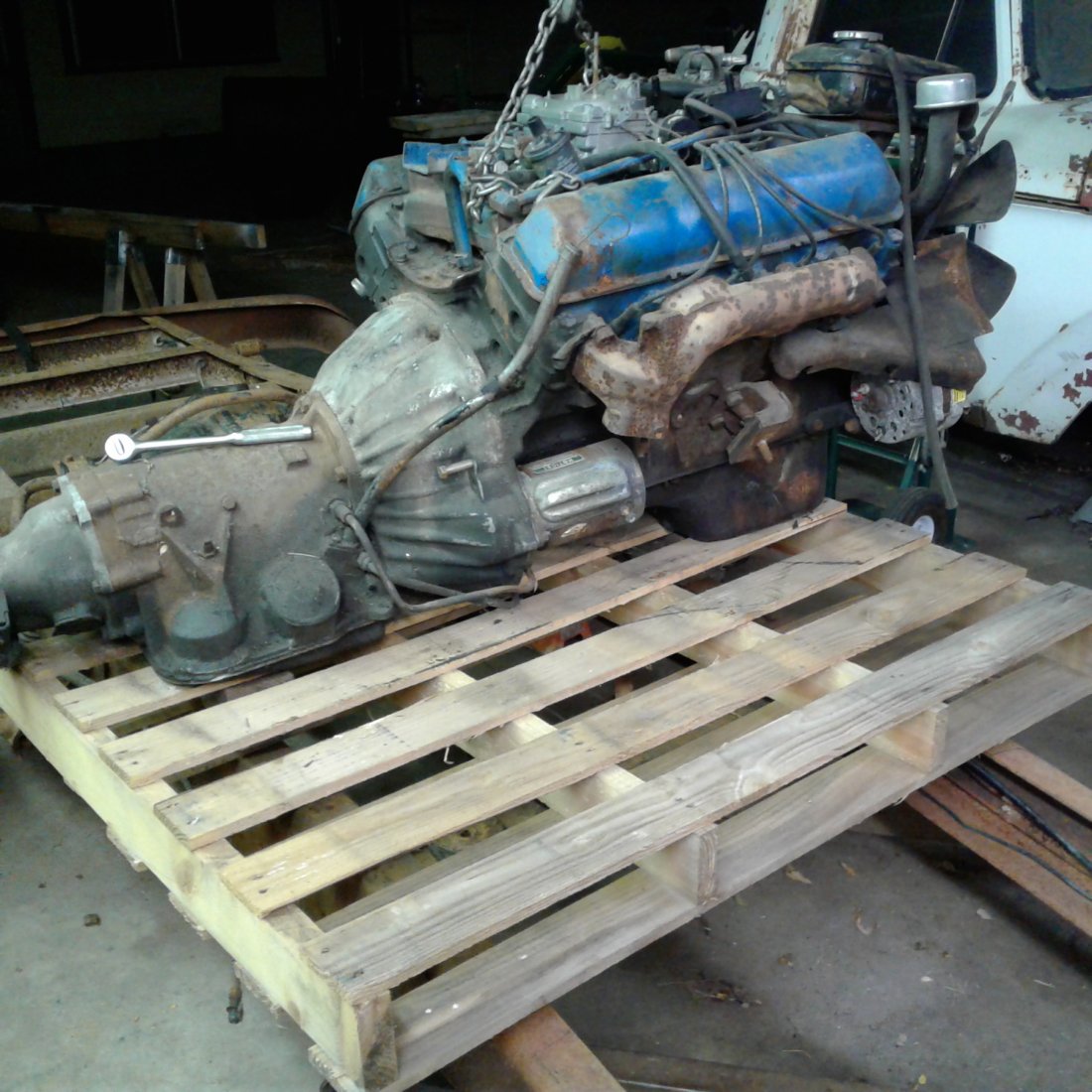

Finally starting to piece this thing together a little at a time. Cranked and ran the 430 about 2 minutes at a time. No signs of it hammering the best I could hear over the open exhaust.
Swapped in the 63/64 Galaxie FE engine mounts and broke the Cruise-O-Matic loose.
I have a 66 F-100 chassis that I am using for mock up. The 65 F-100 and F-250 2 wheel drives shared the same frame. As far as I know so does the 66, at least all the important areas are the same as the 65.
One snag is the starter location. The 61-68 430/462 MEL dropped the starter 2" to clear the new chassis. I can make a bracket to catch the Lincoln and FE bell housing bolts and mount a Chevrolet starter in or cut up a couple of donor bell housings and place the Ford/Lincoln 3 bolt starter in the right place. At one time I had a 65 430 mated to this FT bell housing. There was room with the FT bell and flywheel, should be the same with the pickyp parts. In any case the block/bell spacer plate will need to be modified. The FE pick-up flywheel is larger in diameter than the 61-68 MEL. The FT is even bigger. Since the two left side, two top and both Lincoln dowls are the same as the FE the stress on the new starter pocket will be minimal. Pictured are an FT bell housing and the parts donor cast iron automatic bell from a 59 MEL. They will be the fabricated pieces if I go that route.

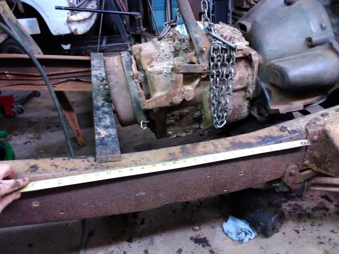

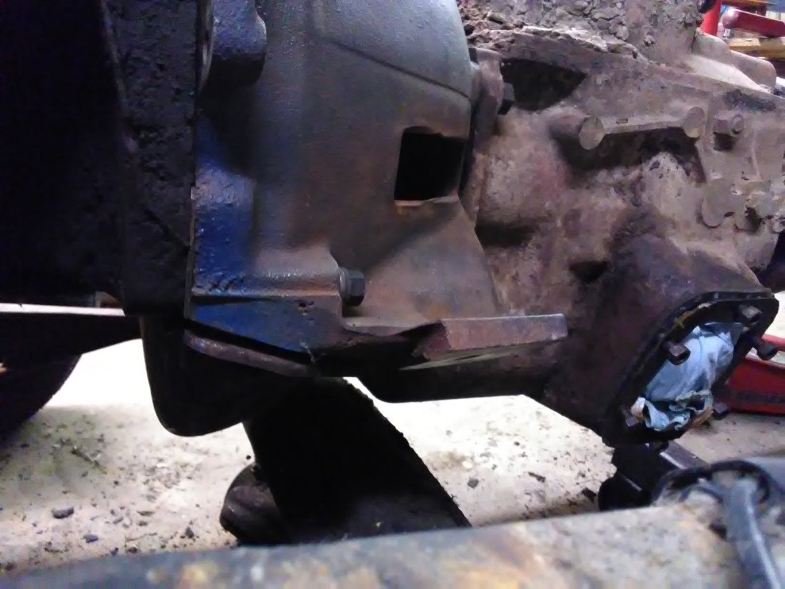

A little more progress. Here is a good look at the back of the block with an FE and FT starter alignment / spacer plate. Notice how the FT bell housing kicks the starter out at the bottom to clear the larger flywheel.
I have a C4TA-7505-G truck bell housing in place with the correct angle. A few measurements for anyone ruining about running one with a Clark behind a 2 wheel drive FE or MEL.

A few more pictures and measurements of a Lincoln 430 MEL, FT bell housing and Clark 250V in a 66 F-100 long wheel base chassis.
