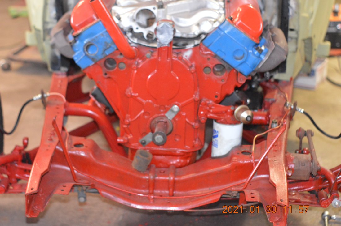

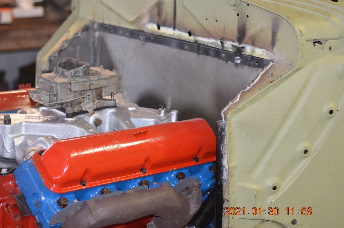

I put a 59 430 Lincoln in my 1937 ford coupe. It has a FE bellhousing and adapter to fit the 1995 Mustang T5 manual transmission. It will be street driven only. I have has it running to break in the reground cam(1969 428 CJ specs hydraulic). I do have a 6x2 weiand intake to install at a later date.

Nice. Is that long nose Autolite one of the early spread bores? As far as I know it was a one year carb.

I like it. What exactly did you use to make the T5 work with the 430?
Re: 430 powered '37 ford dirt racer
I used a FE, 390 ford manual bellhousing and then a 1" spacer plate that adapts the transmission to the FE bellhousing. works very nice and not suoer expensive either.
