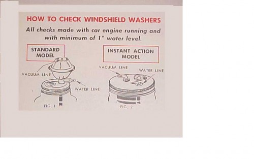

How to check windshield washers
All checks made with car running and at least 1" of fluid in jar.
1) No water Flow at nozzles
Remove water hose, press control button for 3 seconds and release.
If water flows from the pump outlet check washer hose and nozzles for blockage.
2) No water flow from pump
Disconnect vacuum line from pump. Check vacuum while pressing control button.
If no vacuum check the switch and vacuum line.
If vacuum is sufficient, the pump needs rebuilding or replacement.

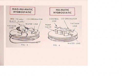

Washers used with Trico Co-ordinator
For Magnumatic Hydrostatic use steps 1 and 2 as above. You must also check the fuse and control switch on these models.
Disconnect Vacuum line and check for vacuum. If no vacuum check the line for obstruction or collapse.
Disconnect small control hose, and cap connection on pump with finger. Release finger, and recap, several times. Each time should bring a surge of water from the water hose connection. If no water, replace or rebuild the pump. If water surges from hose, check control and line running to the control.

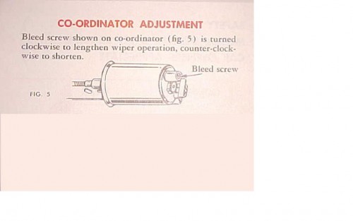

Co-ordinator adjustment
Bleed screw shown on co-ordinator (fig 5) is turned clockwise to LENGTHEN wiper operation, counter clockwise to shorten the running time.
Trico C-O washer with coupler type co-ordinator
To check pump action, use the same steps as above (fig 4).

Adjustment screw shown (fig 6) is turned clockwise to lengthen wiper operation, and counterclockwise to shorten it.
