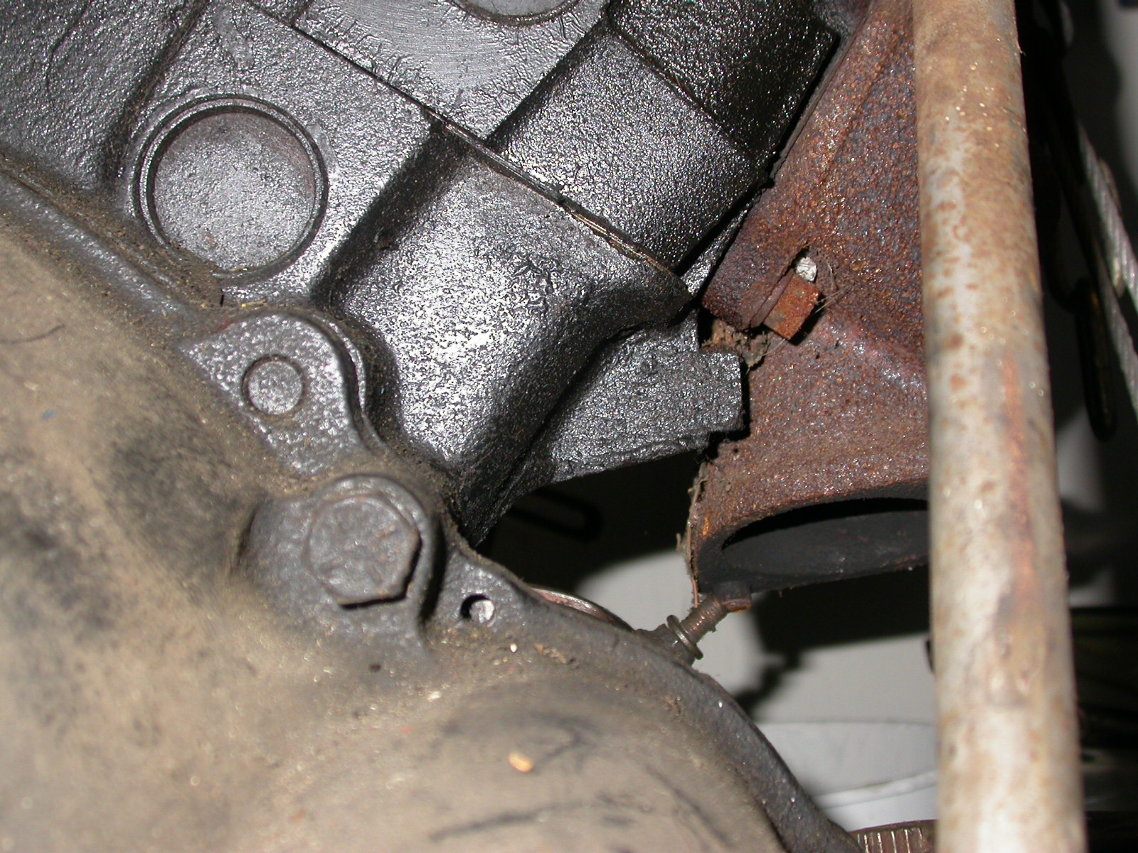

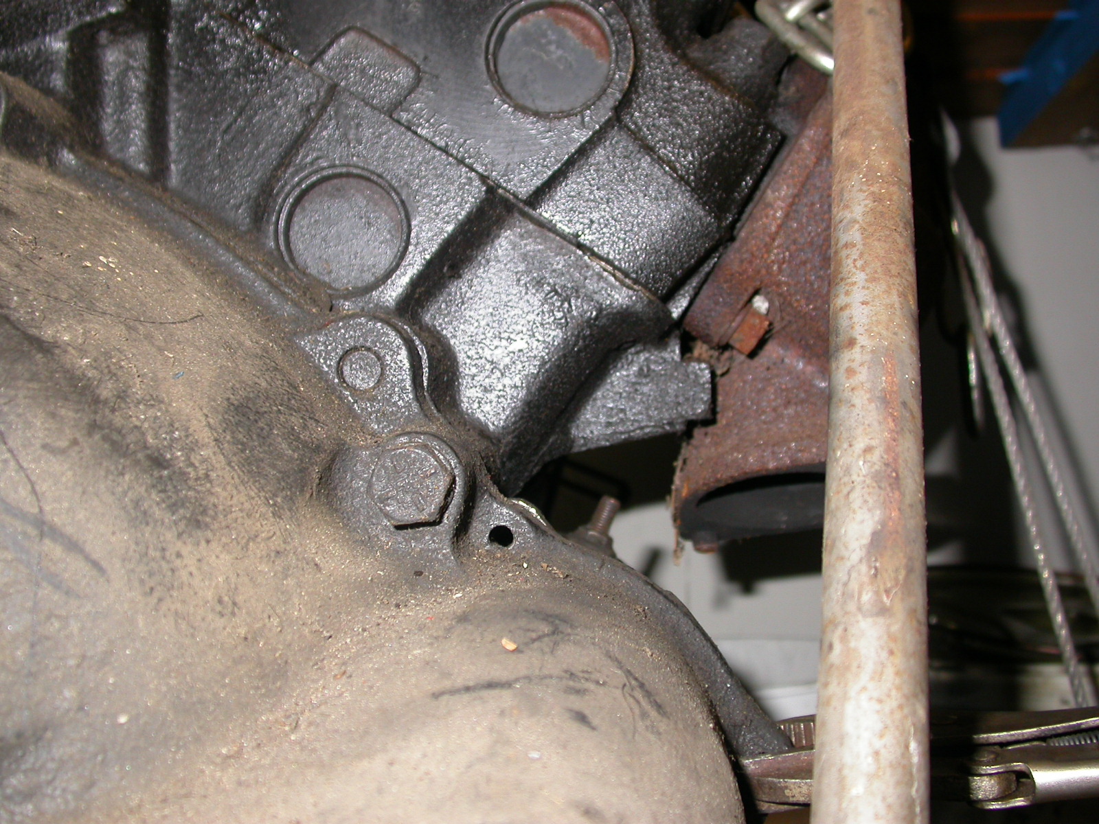

In order to remove the starter you will need to remove the motor mount nuts and carefully raise the engine.
Caution: when raising the engine make sure it does not hit the vacuum wiper motor
you may need to remove it.
Remove the passenger side motor mount.
Remove the Generator
Block up the engine with wood blocks.
You may need to loosen the exhaust system from the manifolds.
Remove the starter cable'
Remove the three bolts
The starter should come out by moving it forward.
You may need to tilt the engine slightly to clear the frame.

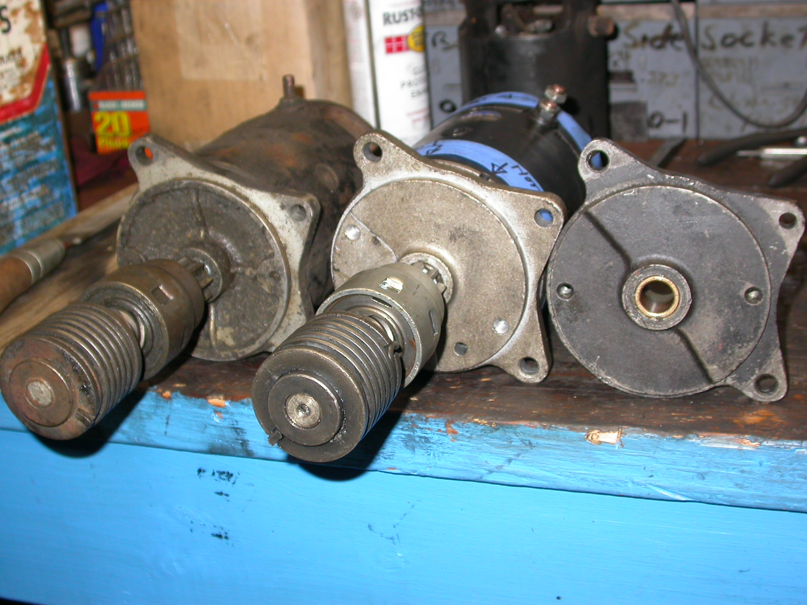

The new starter will need to be clocked or it will not line up.
This means you will need to change out the end plate with the correct keyway. Thats the only way the new stater will work. Check the condition of the bronze bushing. You my need to press the new bushing into the old starter end plate.
OR.....You can special order Part # 3117 ....this is a build to order unit using your starter for the 430 engine.

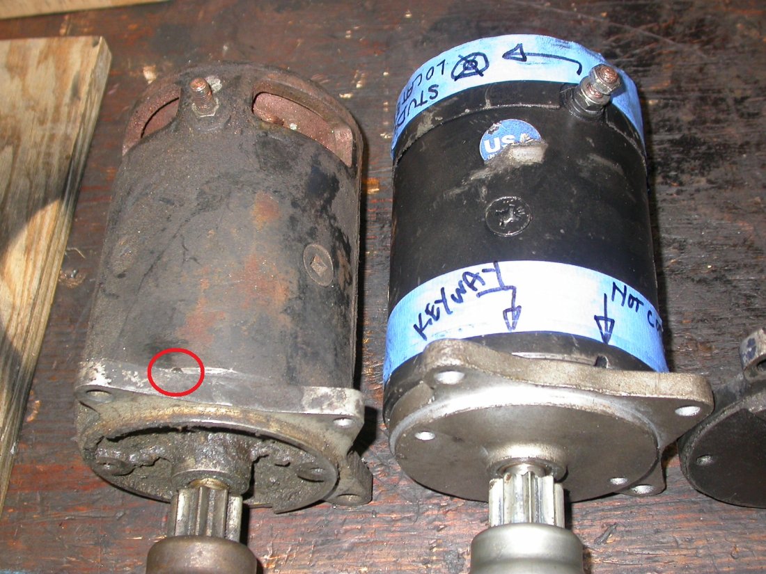

The end plate orients or clocks the starter correctly so the the stud clears the exhaust manifold flange.[/b]
Notice on the center starter and the end plate on the right, the two inboard through holes are about one inch apart or about 10 degrees from the key-way .....(part # 3115) Thats where the two long bolts hold the starter together.
Here is the actual key-way ... I marked on the starter just where the key-way should be. The starter to the left shows the correct location.....
In this illustration the starter part # 3115 "out of the box" IT WILL NOT WORK. The positive cable stud interferes with the exhaust manifold.

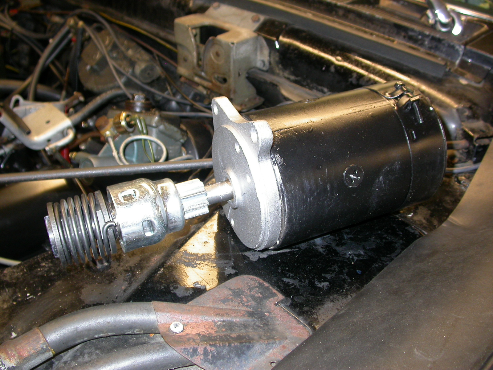

Here is the starter installed with the correct end plate. (starter part #3117)
