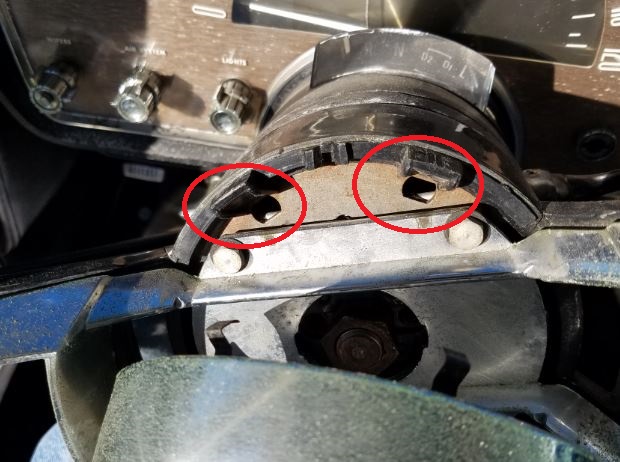

The cap is held in place by these (4) spring hooks.
horn 5.JPG (53.79 KiB) Viewed 23201 times
The spring hooks insert to these four receptacles.
