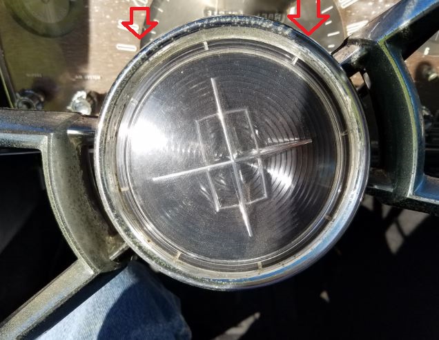

Press down firmly as indicated by the arrows and pull the cap towards you.

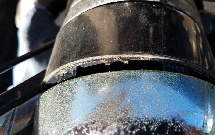

The cap will separate from the steering wheel. The spring hooks are very strong

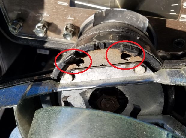

The hook will release from the receptacles.

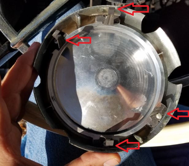

The cap is held in place by these (4) spring hooks.

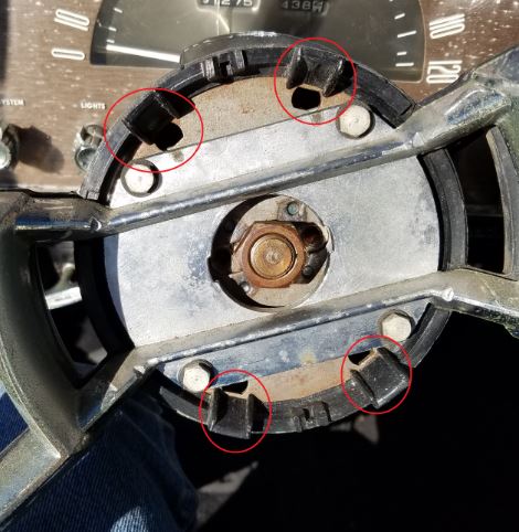

horn 5.JPG (53.79 KiB) Viewed 23195 times
The spring hooks insert to these four receptacles.
