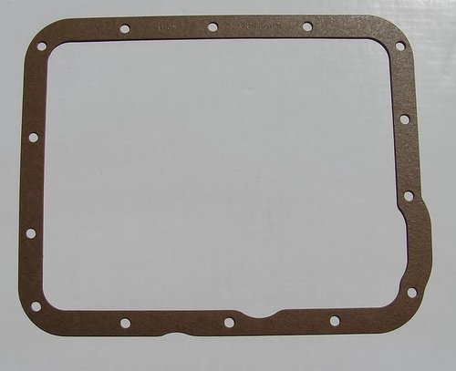

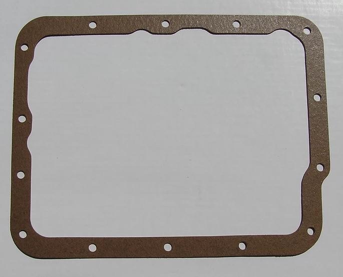

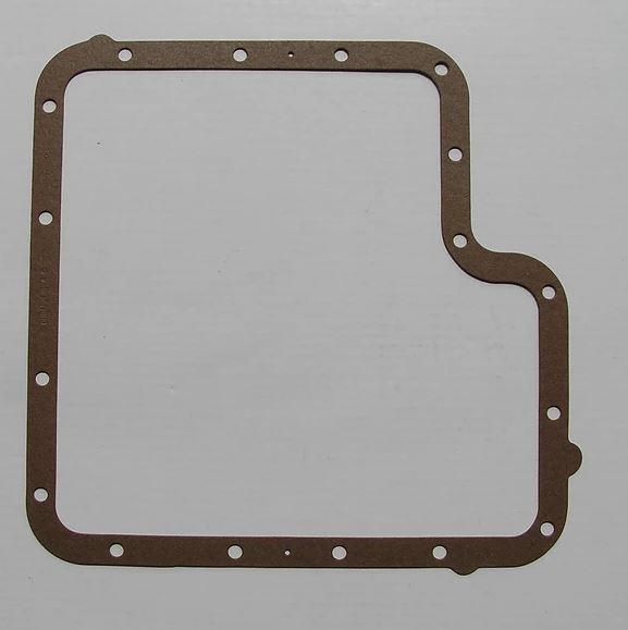

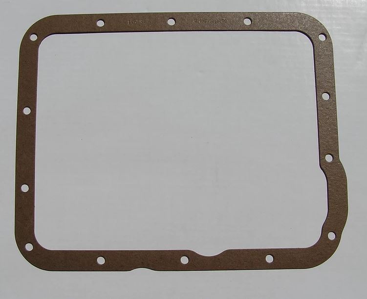

Pan Gasket Identification Ford, Lincoln, Mercury, Edsel
Fordomatic 2 speed 14 Bolts 1959 to 1964

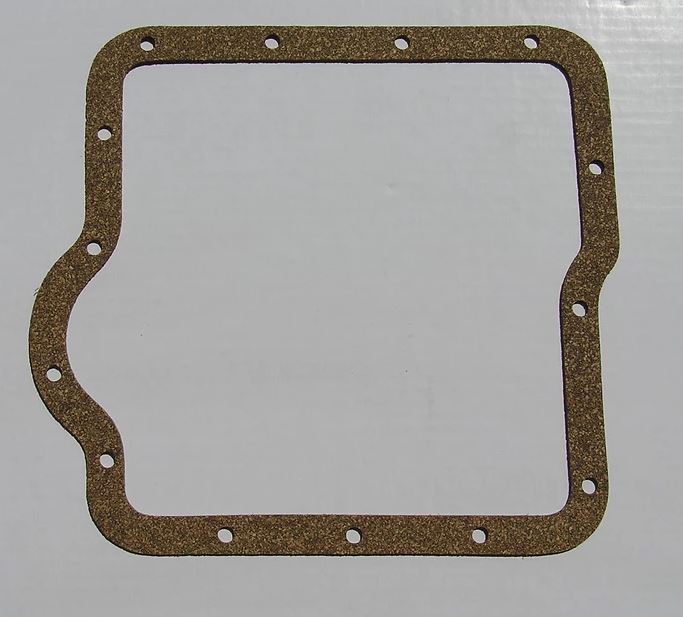

Small Case FMX 14 Bolts 1951 on
Medium Case 14 Bolts 1955 on

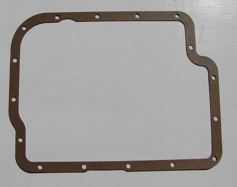

Large Case 14 Bolts 1958 to 1960

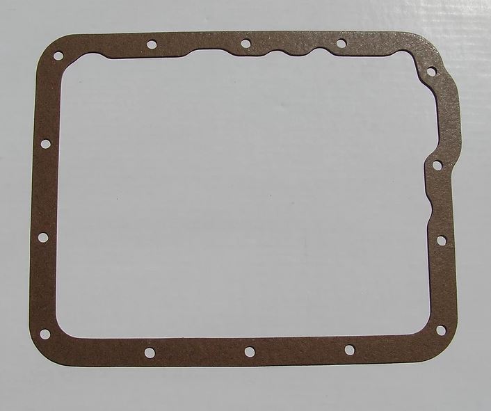

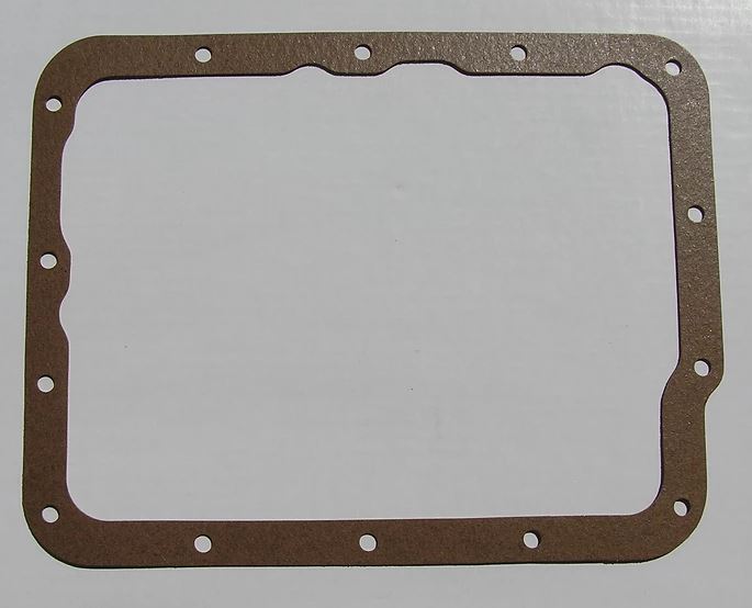

C6 17 Bolts 1966 on

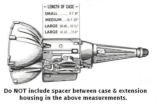

Cast Iron Ford Case Identification
Cast Iron Ford transmissions can be identified by the letter code on the tag which is located on the side of the transmission case. The codes shown below reference the letter codes from the case.
Cases can also be identified by the case measurement from front to back, not including the bell housing or rear pump section.
SMALL CASE = 9 7/8" Case Length (1951-1970)

MEDIUM CASE = 10 1/4" (1955-1972)

LARGE CASE = 10 7/8" (1958-1960)
LARGE CASE = 11 5/8" (1961-1965)
