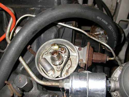

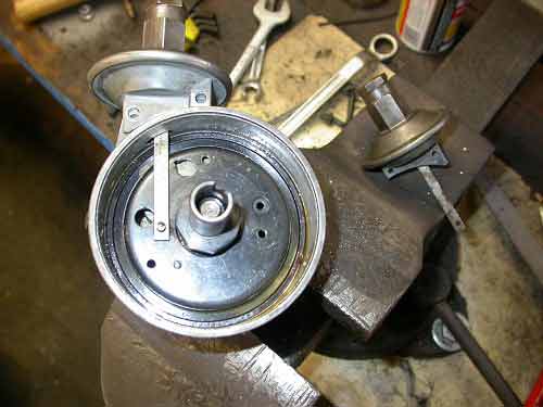

9- One more thing I noticed. In the distributor the vacuum advance will stick in the advanced position. Be sure the advance is working correctly.
This is problematic with the old style rotating plate with ball bearings. It will rust up and stick in the advanced position.
You will need to Remove the distributor and thoroughly clean it. Be sure the plate rotates smoothly.
The newer distributors actually pivot and that pivot point can break or get dislodged. Again a good cleaning and possible replacement of the plate will remedy that problem

I have two 59 Lincolns with the 430. Same issue. Here is what I did. The standard battery is 650 cranking AMPS. I replaced both batteries with a Group 31 HD truck battery. I also fabricated new battery trays and hold-downs. Next I made custom Battery cables 00 Gauge (2/0 AWG) Copper Battery Cables with an additional Cable from the engine block to the firewall. Rubber motor mounts insulate the engine from a proper ground. I added a heat shield on the battery tray and made a heat shield for the starter. I made a new cable going from the solenoid to the starter adding an insulated sleeve used for spark plugs. Not done yet. In the distributor make sure the advance moves freely. I noticed on one car the distributor was rusted in place. (See Above!) The early 59 had a plate riding on ball bearings whereas the later build 59 had a pivoting vacuum advance plate. Also make sure the Vacuum diaphragm in in working order. What a difference It cranks much faster. starts right up!
