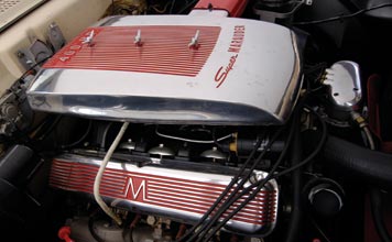

That's a cool looking air filter housing. Rare as hen's teeth, I take it?

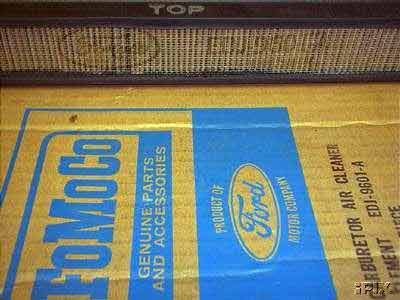

OK ......first things first
Dont pay a lot for your filters .....$89.00....NO!....$65.00!!! ...NO NO $35.00 ...NO!! $25.00 NO!!!!! :o
Go to a local truck stop ...They carry Baldwin Filters..... :idea:
Check out the site....Super Marauder Air filter IN STOCK!!! :D
Air Filter ........
Baldwin filter site...
http://www.baldwinfilter.com/
http://www.bfwebexpress.com/catalog.asp
and looked into some part numbers...
ACDELCO A87C
AIR REFINER ARP22
AMERICAN PARTS 1137
BALDWIN FILTERS PA632
CHAMPION LABORATORIES AF48A
FORD MOTOR CO. FDJ-9601-A
FORD MOTOR CO. EDH-9601-A
FORD MOTOR CO. EDJ-9601-A
FORD MOTOR CO. EDK-9601-A
FORD MOTOR CO. EDU-9601-A
GENERAL MOTORS CORP. 1554082
MOTORCRAFT FA48
PUROLATOR AFP22
PUROLATOR 6934425
STAY READY SRP-A22
WESTERN TOOL CO. WA22
Dimensions...
O.D. 9 23/32" (246.9) to 20 23/32" (526.3)
I.D. 7 5/16" (185.7) to 18 5/16" (465.1)
Length/Height 1 3/4 (44.5)
List Price: $38.33
Blue Price: $15.33
OK .....NOW KICK IT UP A NOTCH!!!!!!BAM!!!
Unit Price for Case: $10.73
Units in a Case: 6
Case Price: $64.39
