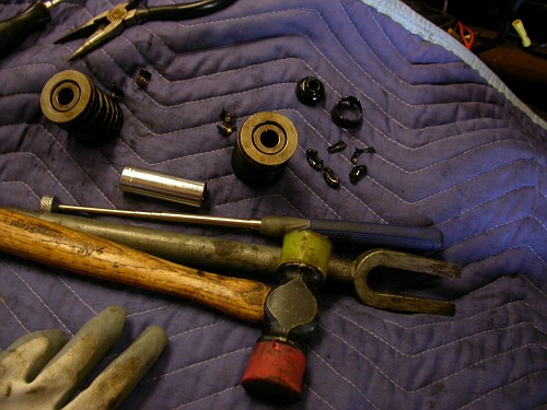

Special Tools/Parts:
1. Air compressor.
2. Compression gauge with an extension.
3. Valve spring compressor (optional) I used a Pickle fork for tie rod ends.

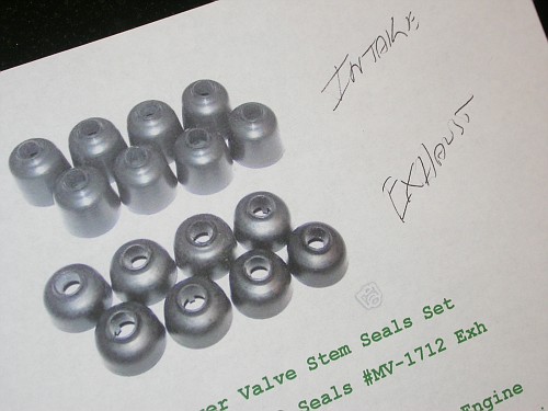

6. 16 valve seals 8 intake 8 exhaust.
7. Safety Glasses.
8. Magnetic wand.
9. Valve Seals Check your application
SEALED POWER MV1775
Inside Diameter 0.342
Overall Length 0.79
Inside Length 0.4
Outside Diameter 0.906
Type TS
Part Comment Umbrella type
Alternate/OEM Part Number(s): MV1775C
SS 13399 FEL PRO
Alternate/OEM Part Number(s): C4TZ6571H, E6HZ6571A

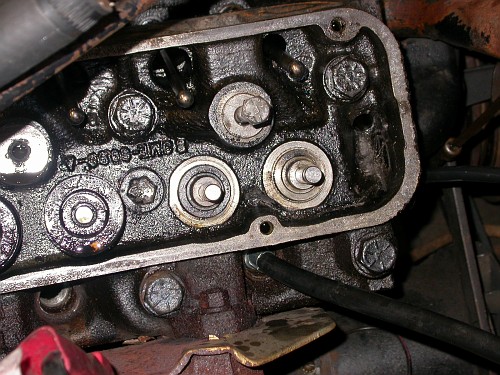

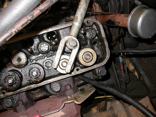

4. Gently rap on the exposed valve stem and around the keepers with a hammer and a deep well socket. This will loosen the keepers so when you actually compress the spring they can be easily removed. Without this "persuading", you may not be able to separate the keepers from the valve stem. It is helpful, but not necessary to have an assistant.

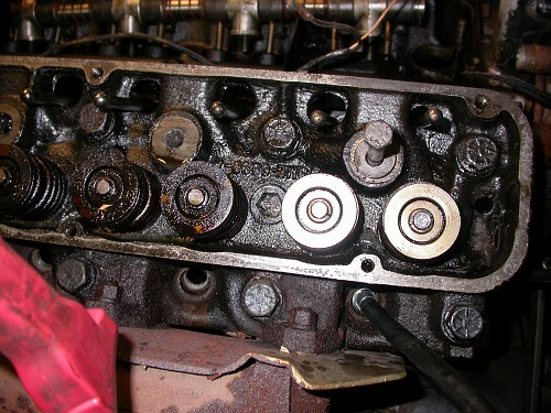

5. Install one of the rocker bolts along with the washer to the first threaded hole used for the rocker shaft support. Compress the spring using the pickle fork while grabbing or having your assistant grab the keepers. The more you compress, the easier it is to grab them. Be careful ... you don't want to drop a valve ...
The keepers are tapered, small and prone to easy loss. Make sure to keep track of them.

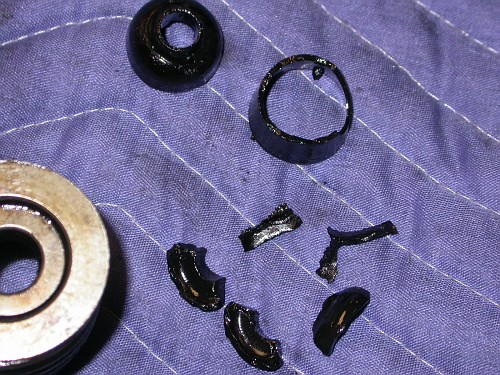

6. Remove the spring, retainer, and old seal or what’s left of it!
7. Do steps 3 - 6 for the other valves.
8. I cleaned the area with a shop vac and an old funnel over the vacuum hose, small end down. Works like an anteater snout.
9. Place the new valve seals over the valve stem then reassemble spring and retainer
10. Compress the spring and replace or have your assistant replace the keepers. Again, the more you compress, the easier it is to put those buggers on right. Repeat procedure for the other valve
11. Important. Make sure not to accidentally depress a valve as the cylinder may decompress. if this happens, you may lose the valve down into the combustion chamber. Also the engine will turn over when you pressurize each cylinder until that piston bottoms out.
