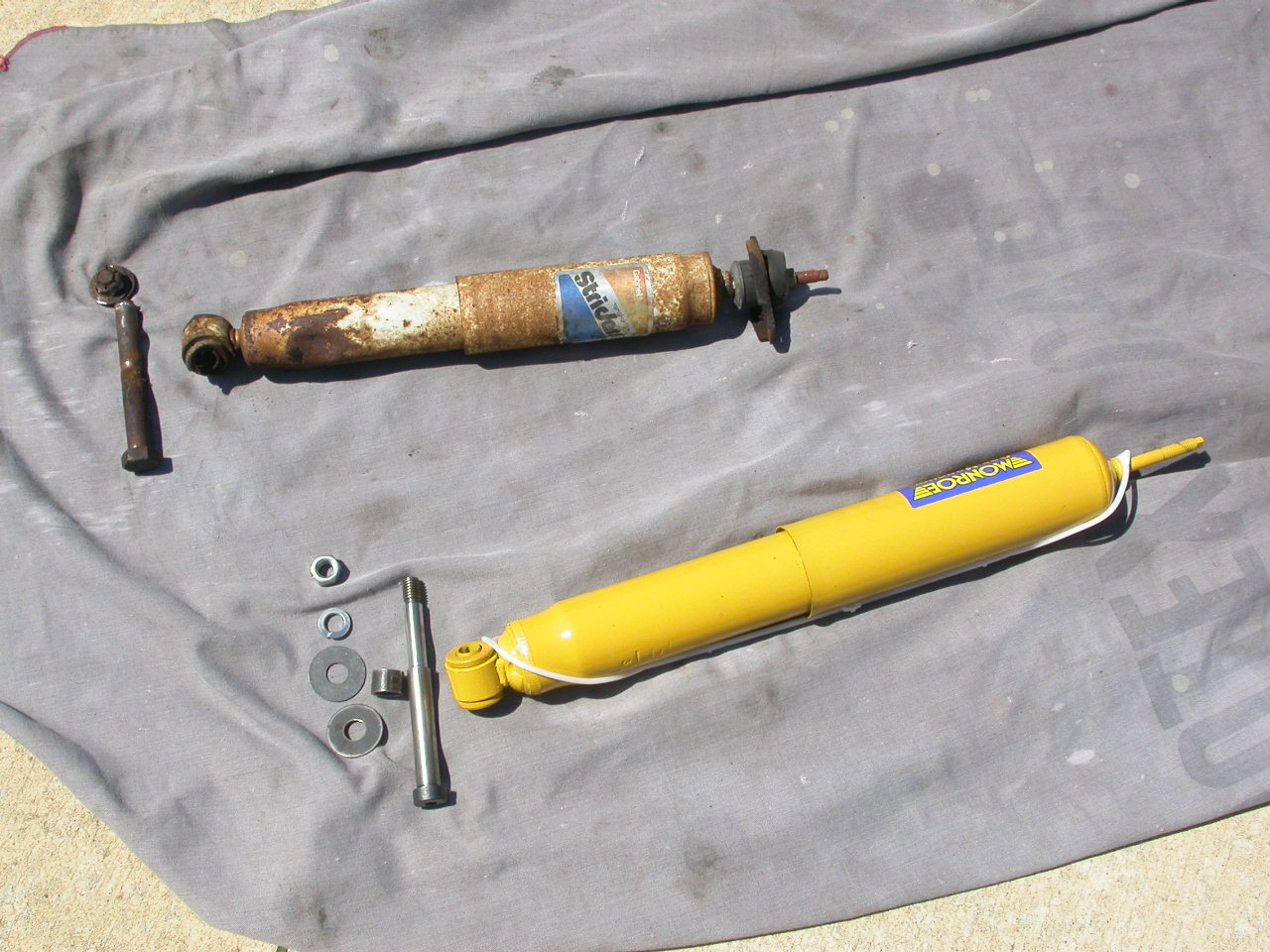

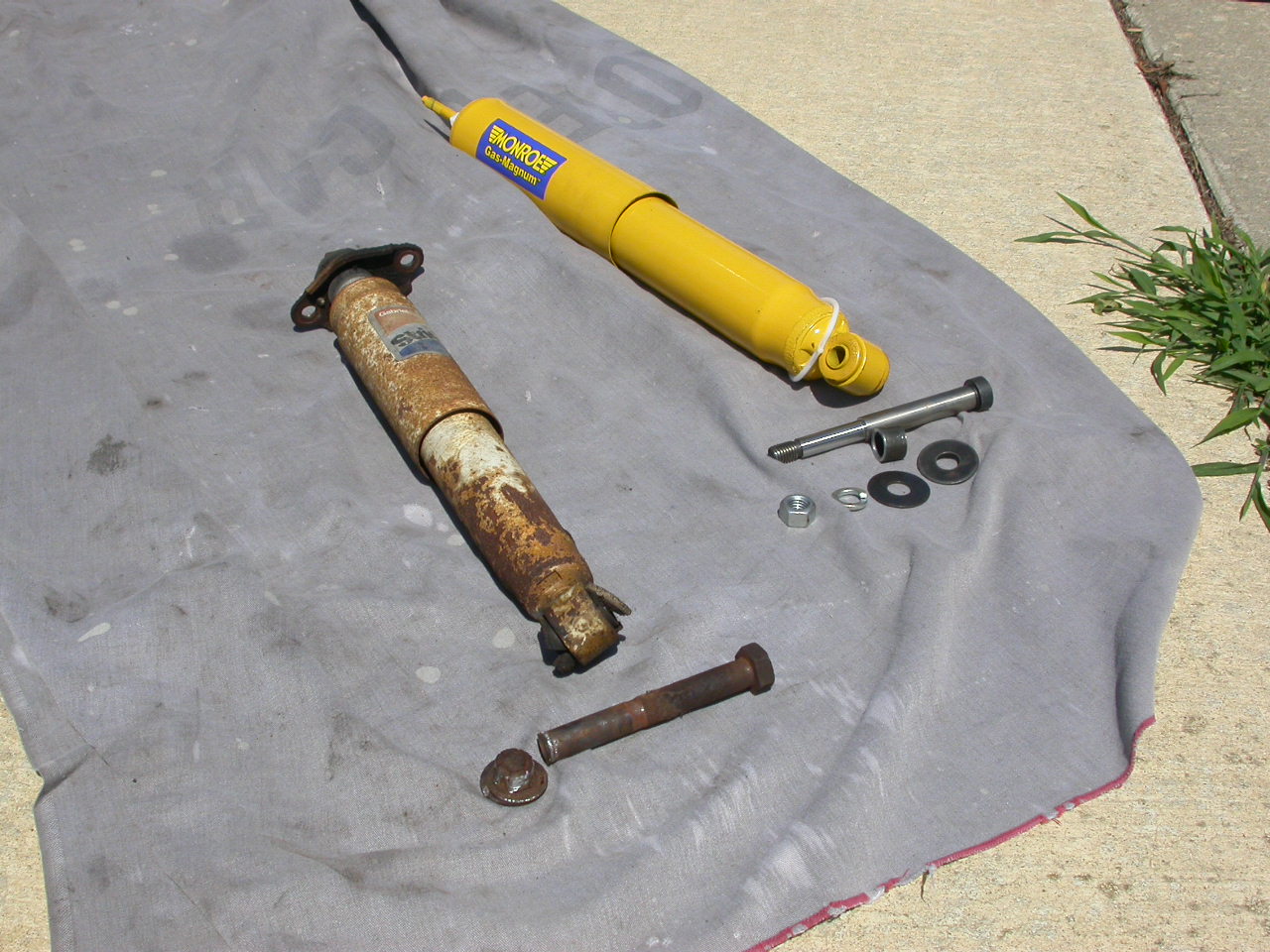

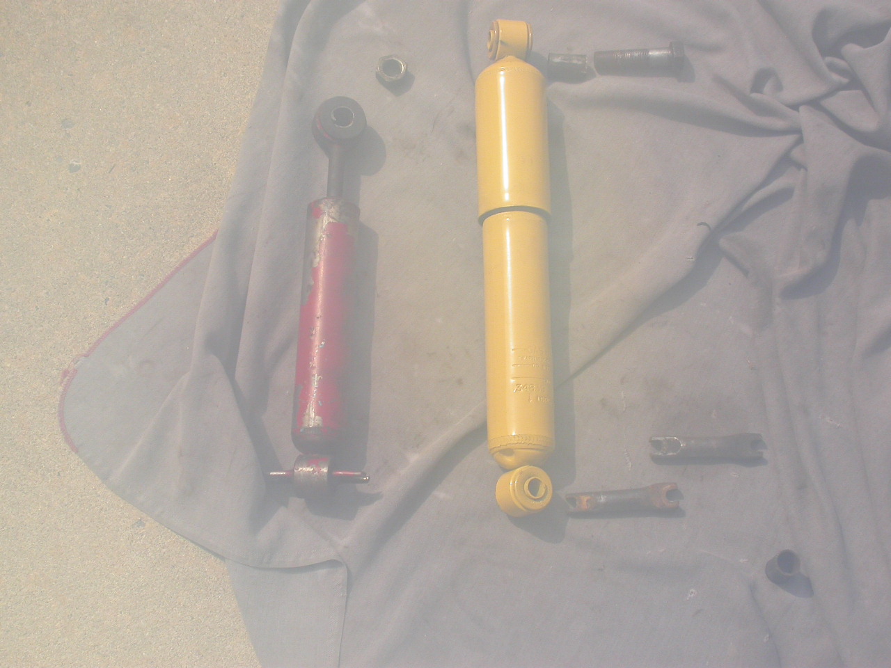

You will need to make some modifications for your application ……. Note the massive size of the new shocks!!

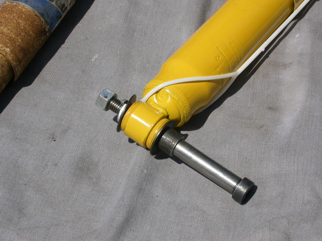

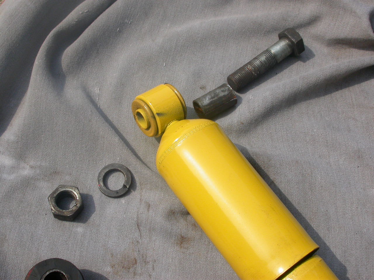

Rear shock Pre-install. I cut off the old mounting bolts and used aircraft grade shoulder bolts.
Notice the spacer made from black gas pipe. Did I mention self locking nuts.......

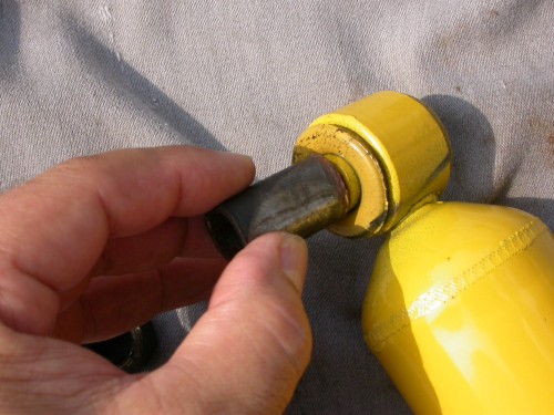

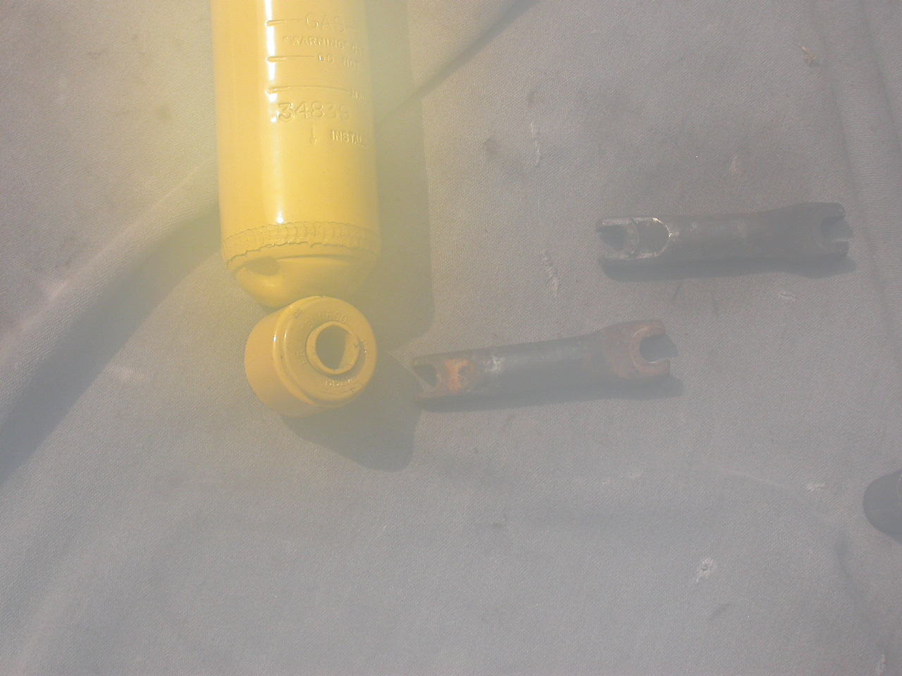

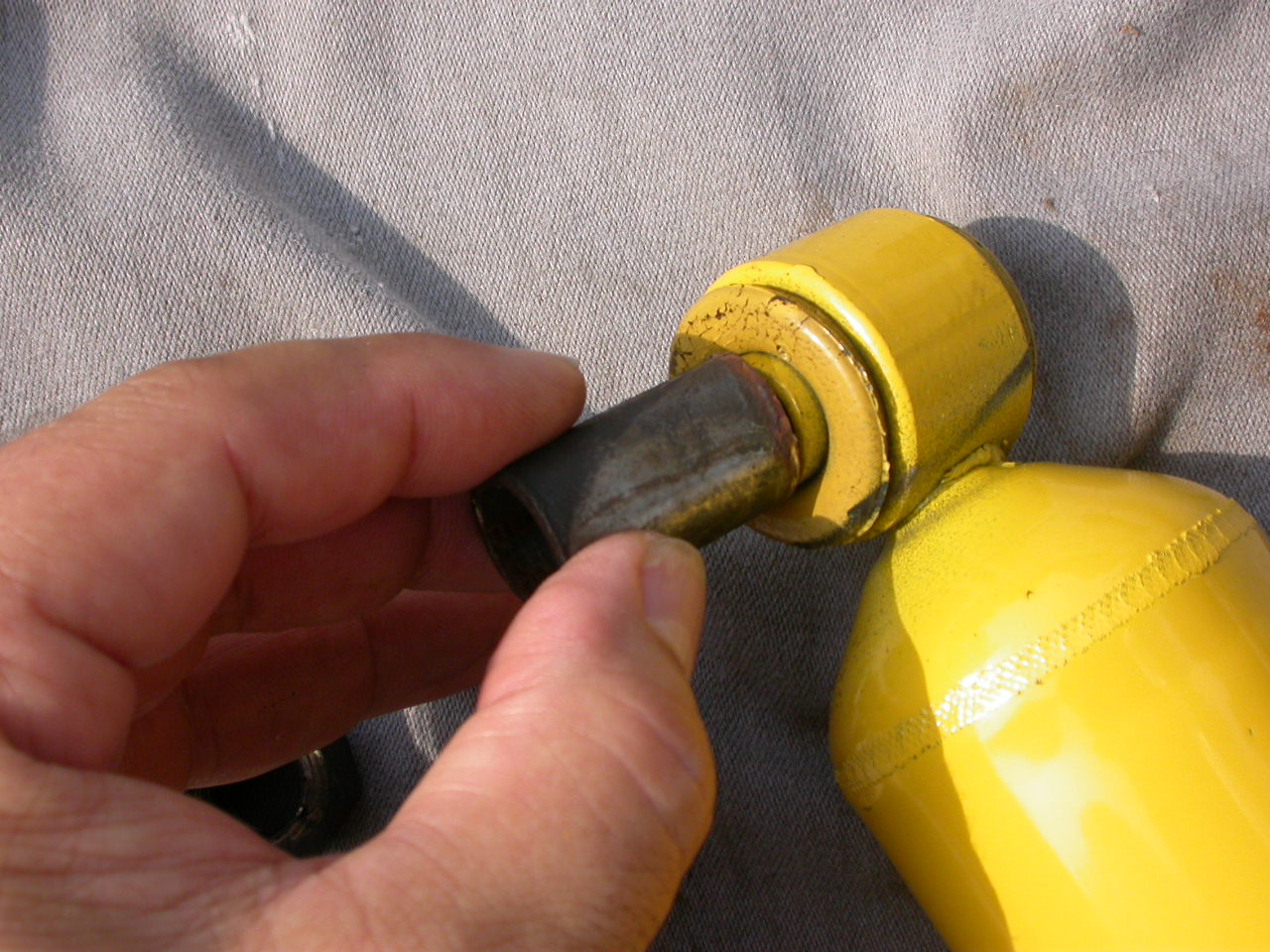

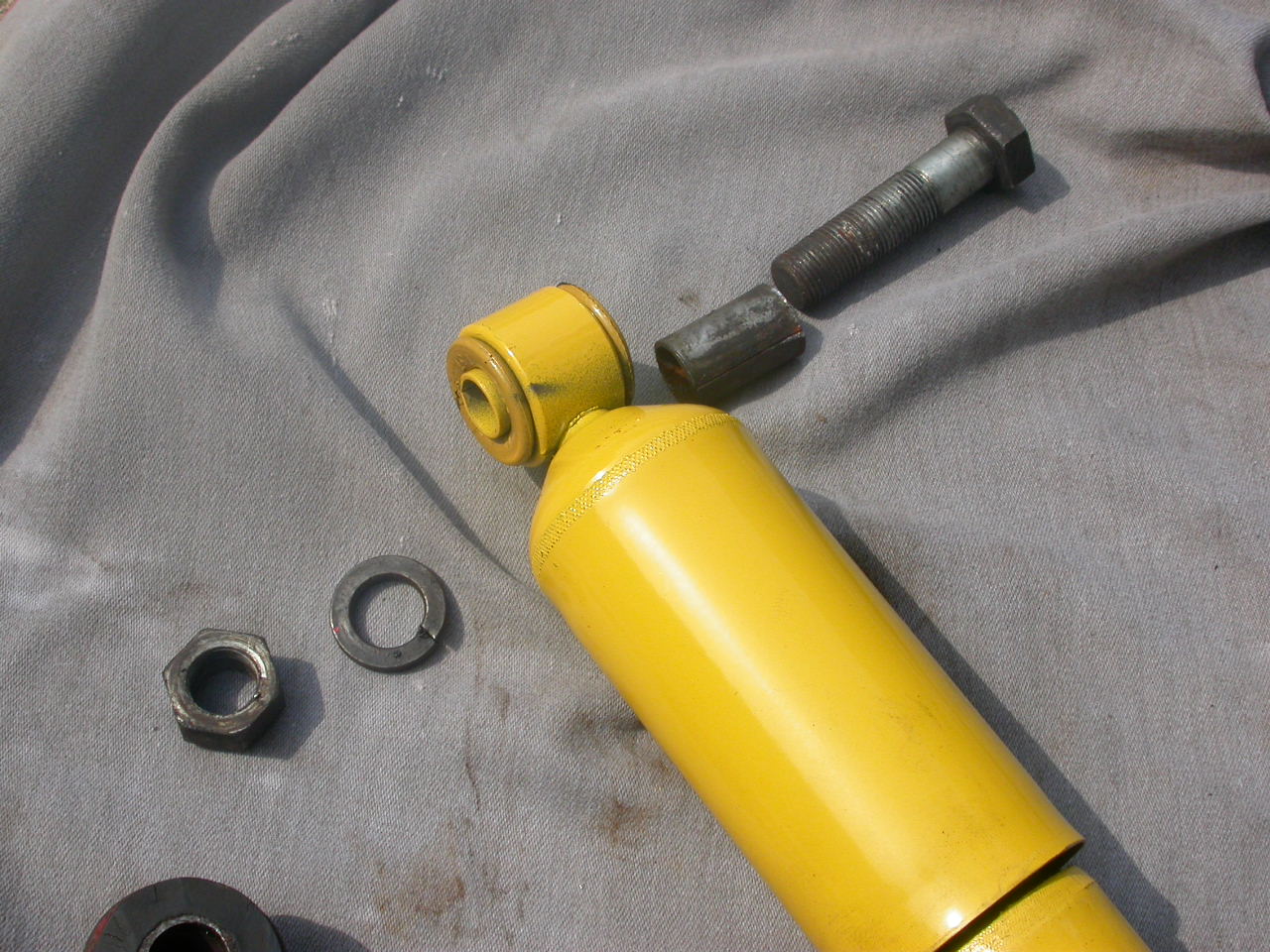

Front shock Pre install. I ground down the bottom mounting pin to slide through the shock loop as well as pressing in the old bushing at the top for additional bolt clearance.
Not shown: I ground away some of the dust cover so it would fit in the upper frame mount.
Armed with these part numbers you can now cross reference to your preferred brand and price range.
