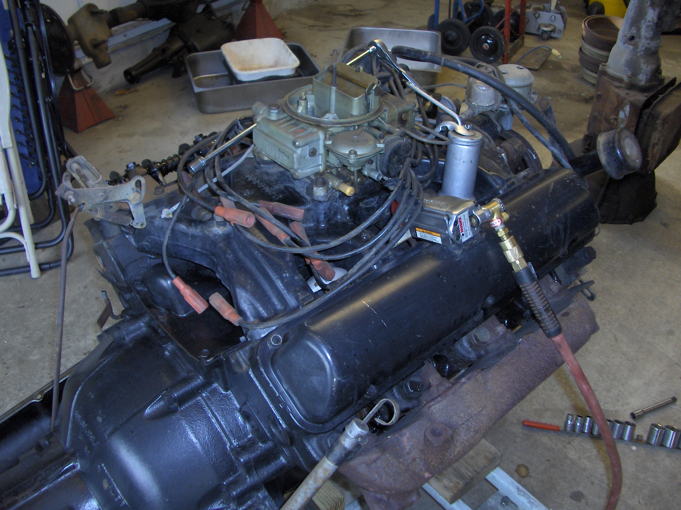

Squirt some Transmission oil or Marvel Mystery Oil into the cylinders. A few tablespoons per cylinder should do it. Turn the engine over by the crankshaft bolt using a breaker bar. If its free you can go ahead and carefully crank it with the starter. If it don't move, let it soak for a few days and try again.This may take several weeks.
Motor oil or Marvel Mystery oil works great

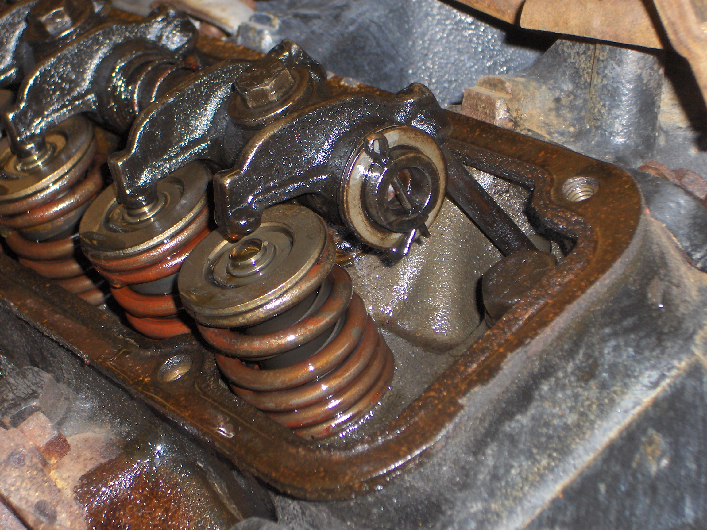

Its a good idea to remove the valve covers at this time and oil up the rockers and valve stems.
Oil the valve train

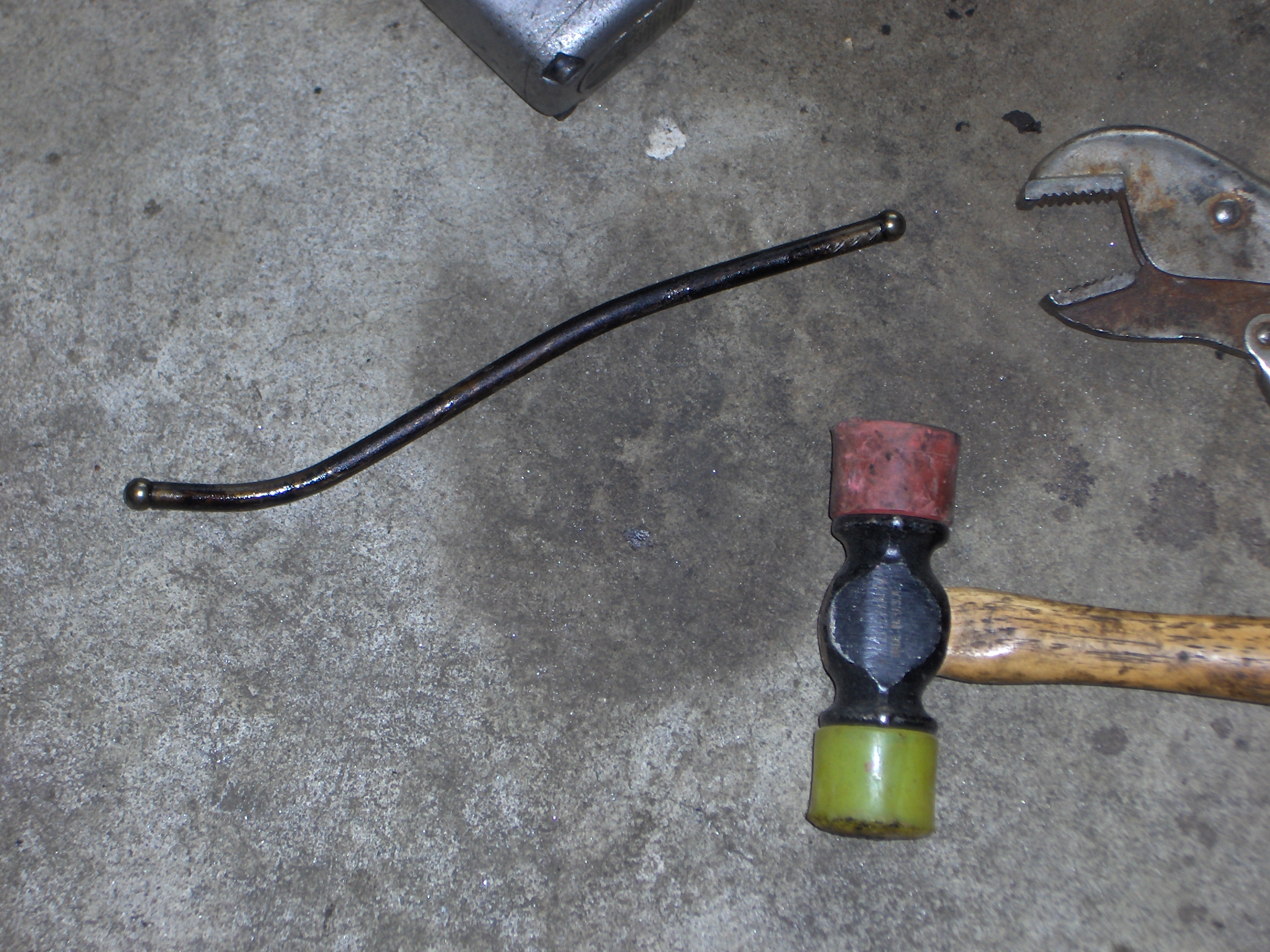

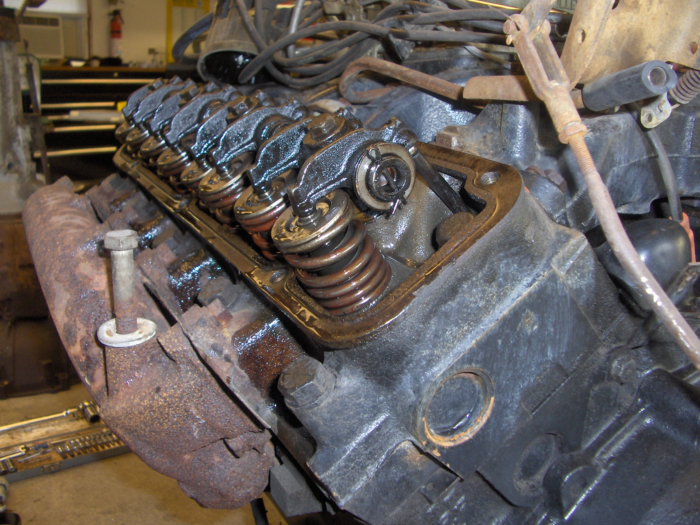

Looks like a stuck valve. Squirt a little oil on the stem and lightly tap it with a plastic hammer back and fourth. After a few minutes it popped back in place.
OK ..... and this valve needs a slight adjustment?
Golf anyone? Would this be considered a 9 iron?
Houston, we have a problem!
OK so it never goes as smooth as you would like......
This engine has a few problems from sitting so long.
I replaced the push rod with a straight one
