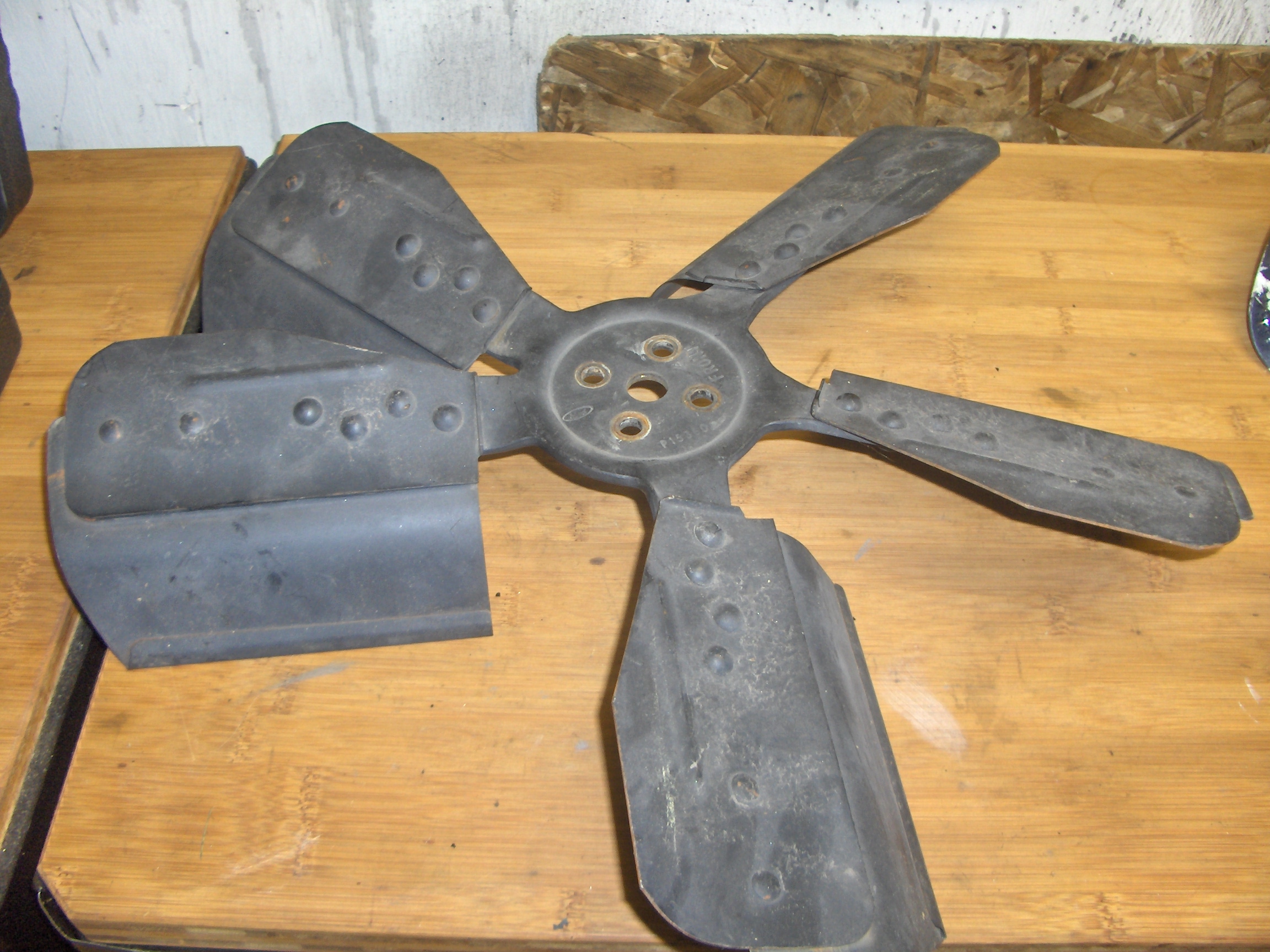

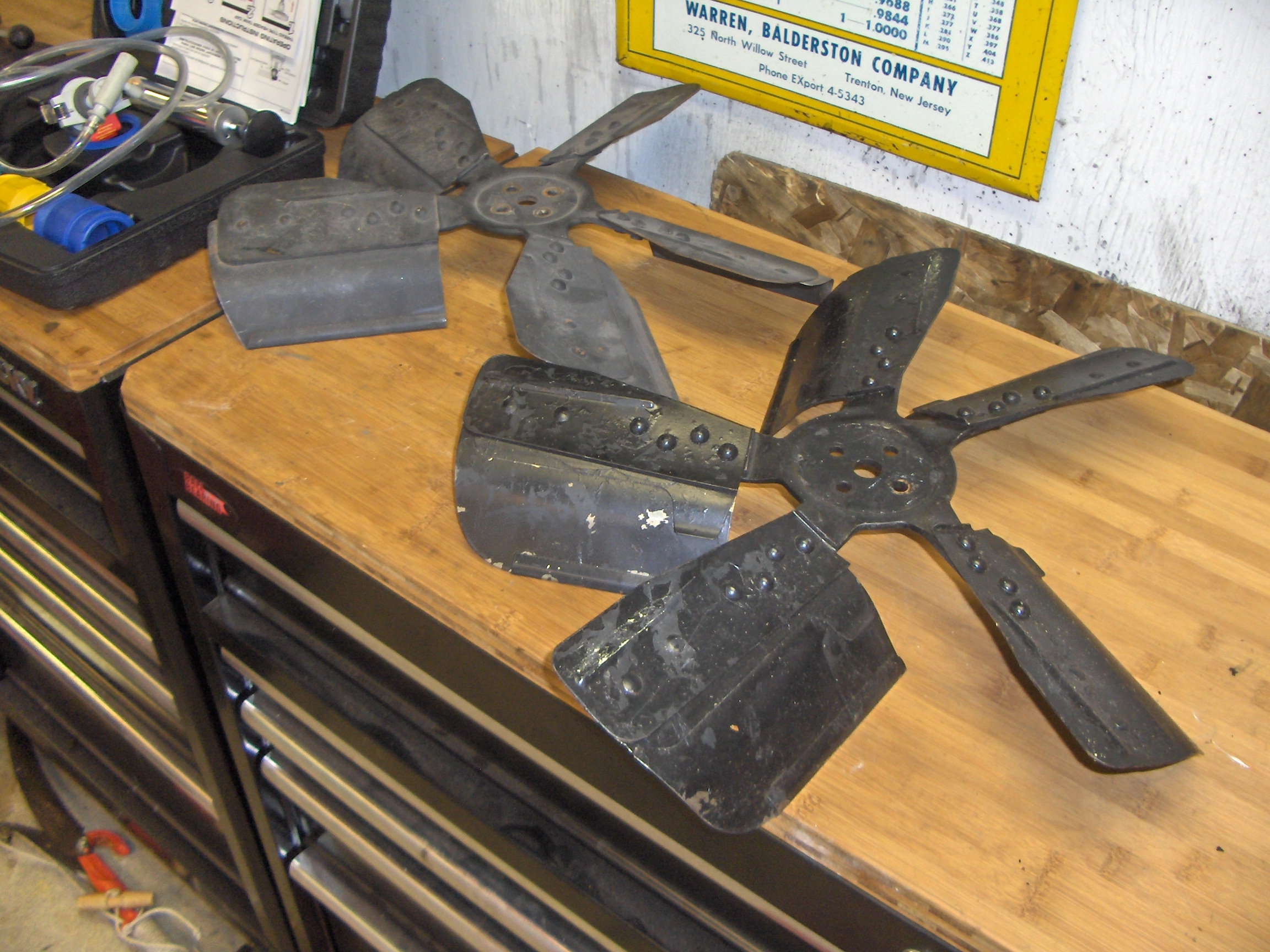

I recently attended a Ford Lincoln Mercury and Edsel swap meet. As I was looking for parts for another project. I came across a stack of FoMoCo flex fans $5.00 each. how could I resist. I picked up a few for the Lincoln. The original fan is only 4 blades.
When buying a used part check for defects, cracks, loose hardware, bent components...... its buyer beware.

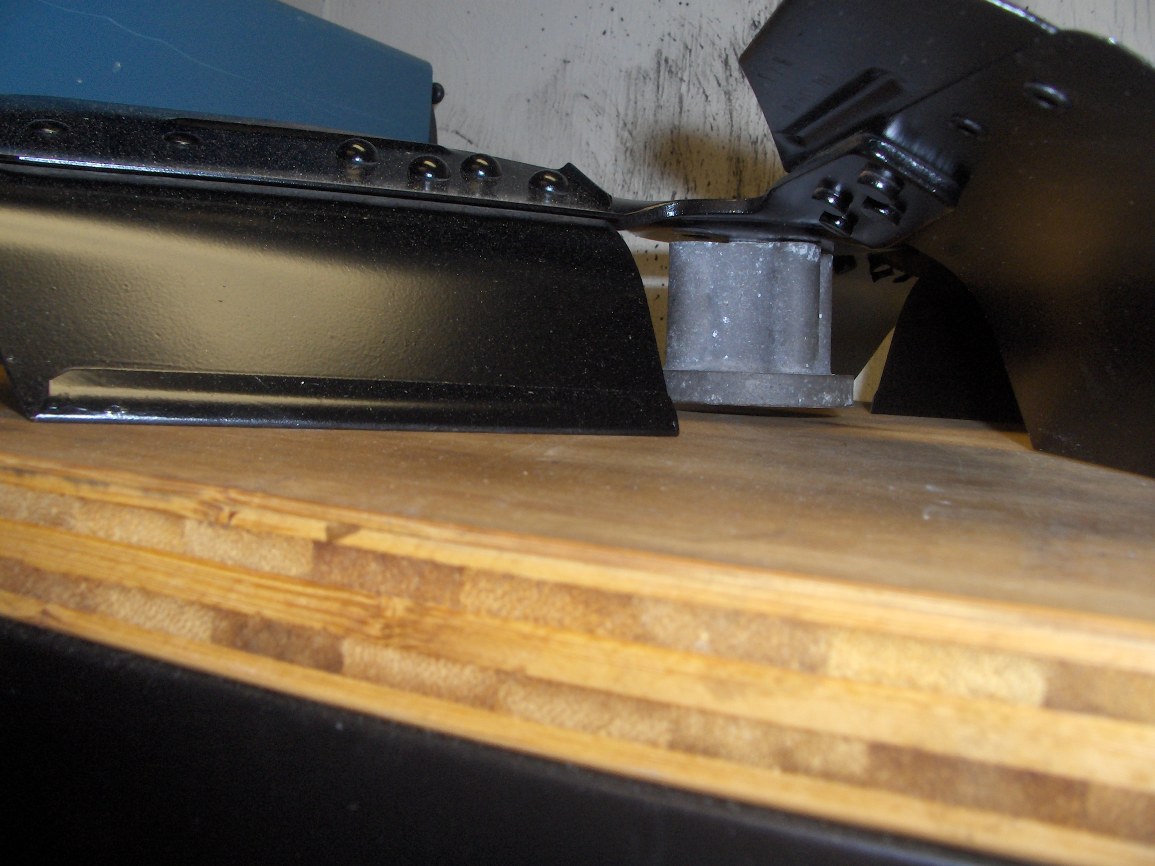

Yikes .!! this fan is way too wide!
Back to the drawing board.

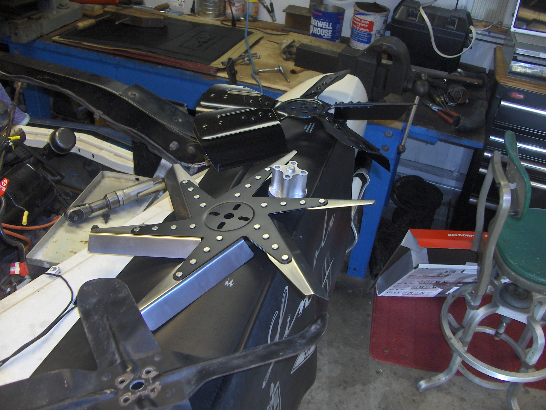

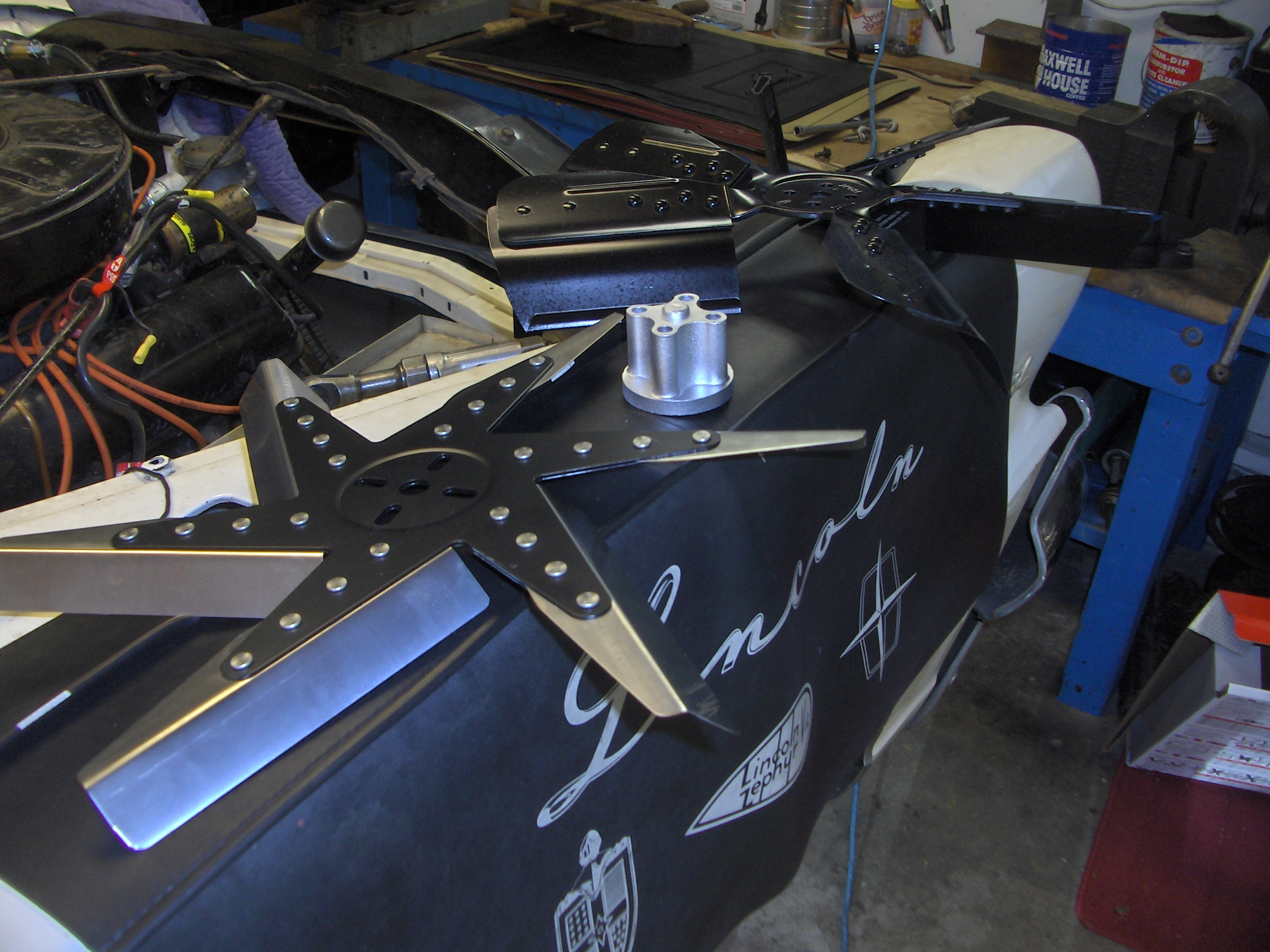

After some trial and error I selected an aftermarket fan. Stainless steel Deral flex fan #19118. This is a low profile unit.It measures 1 1/8 "wide.
Here are the 3 fans side by side.

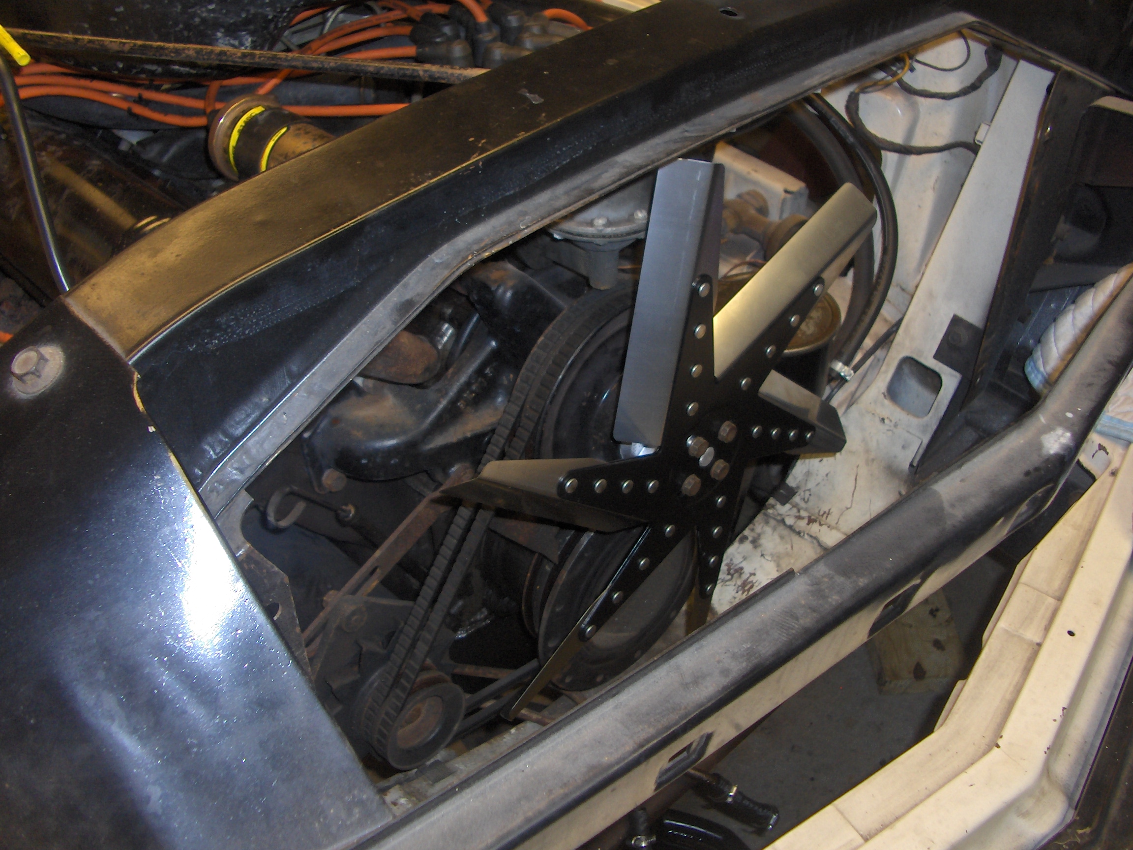

Here's the unit installed.
I had the radiator dipped and cleaned..... the car should run cool now.
