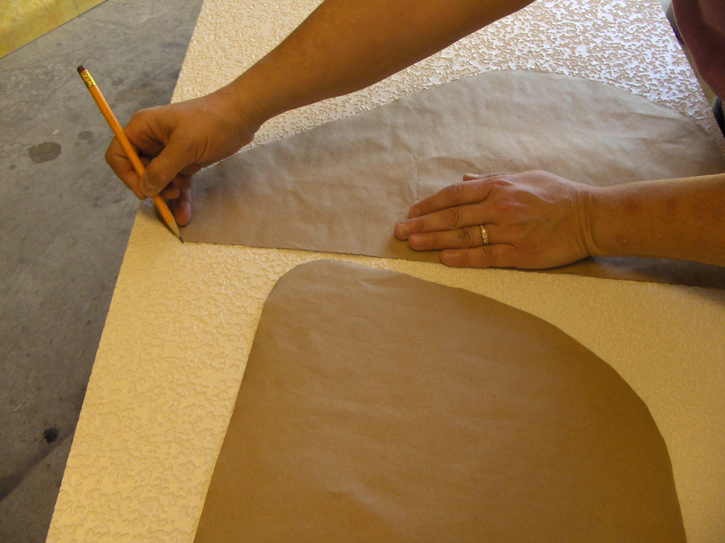

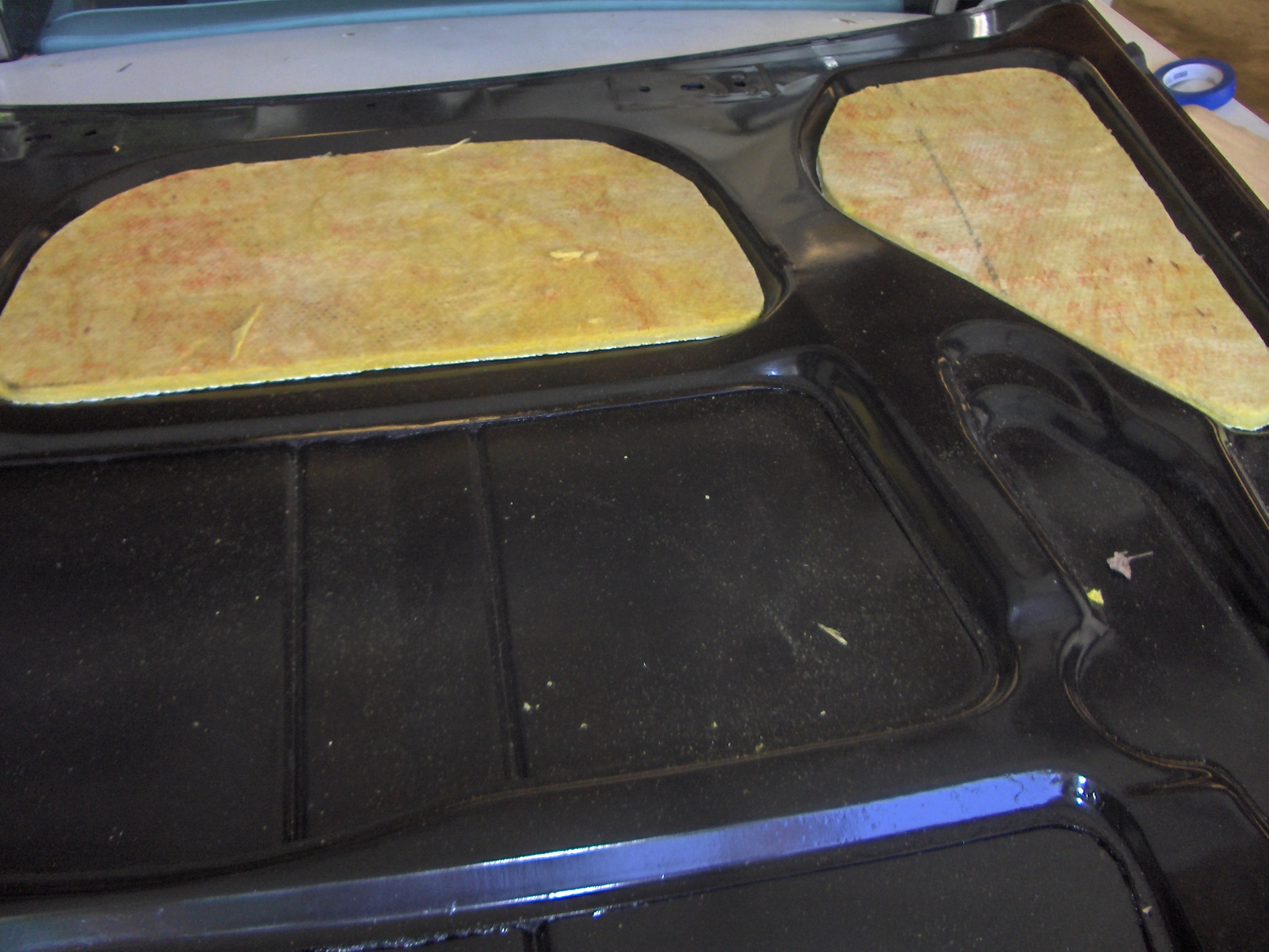

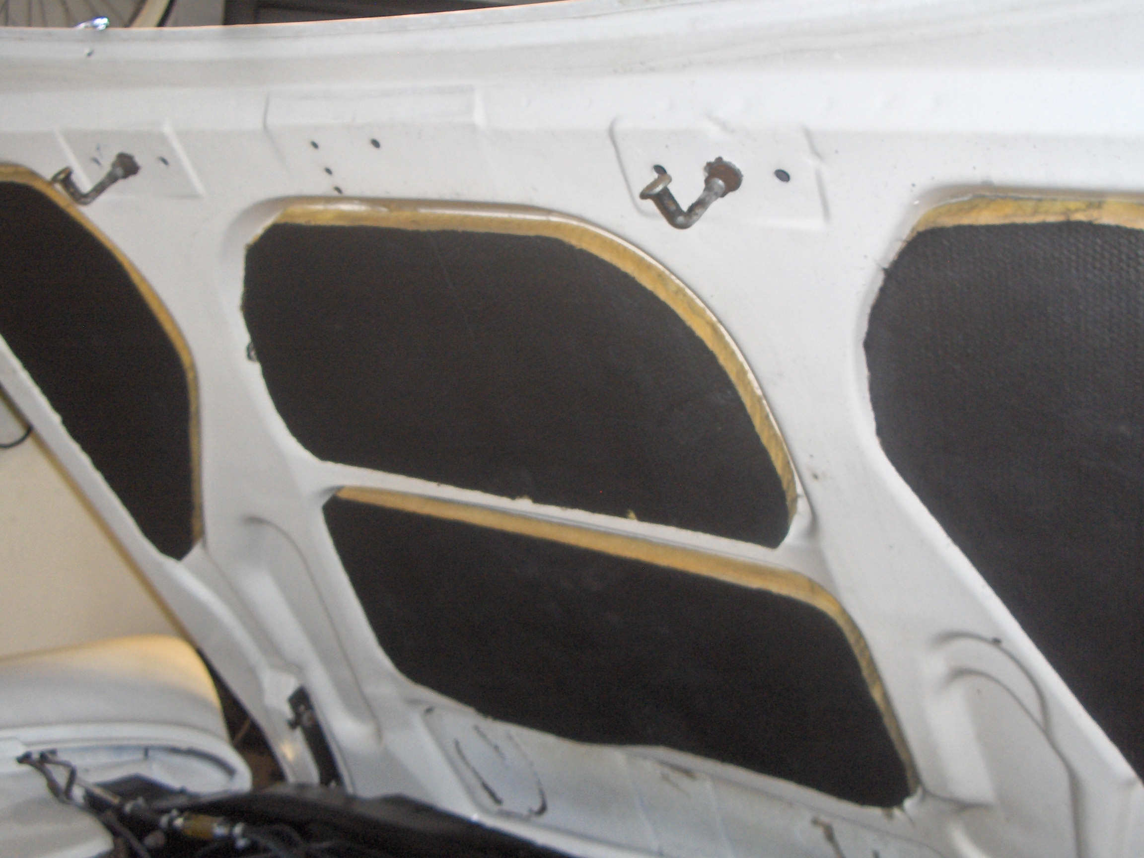

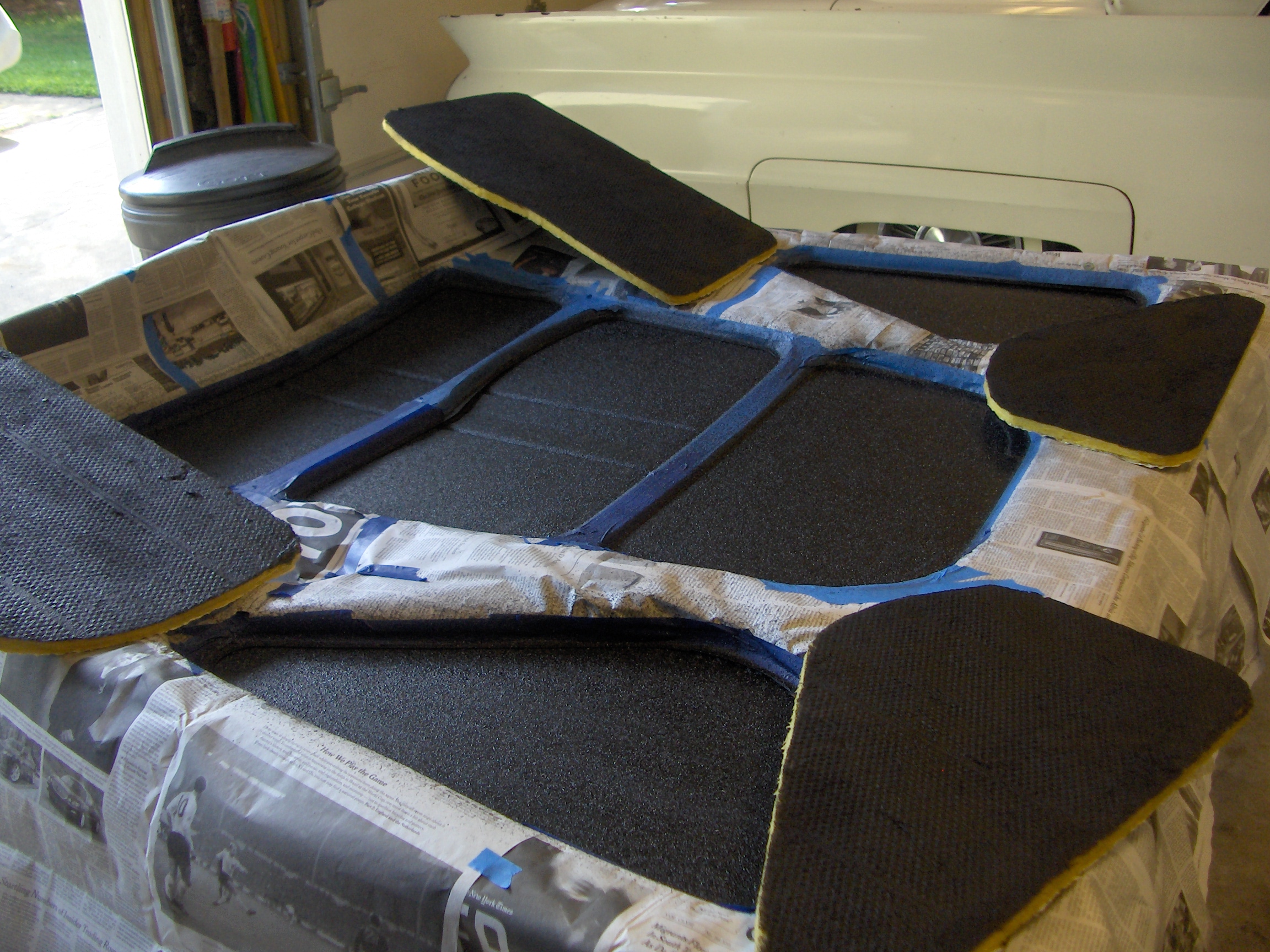

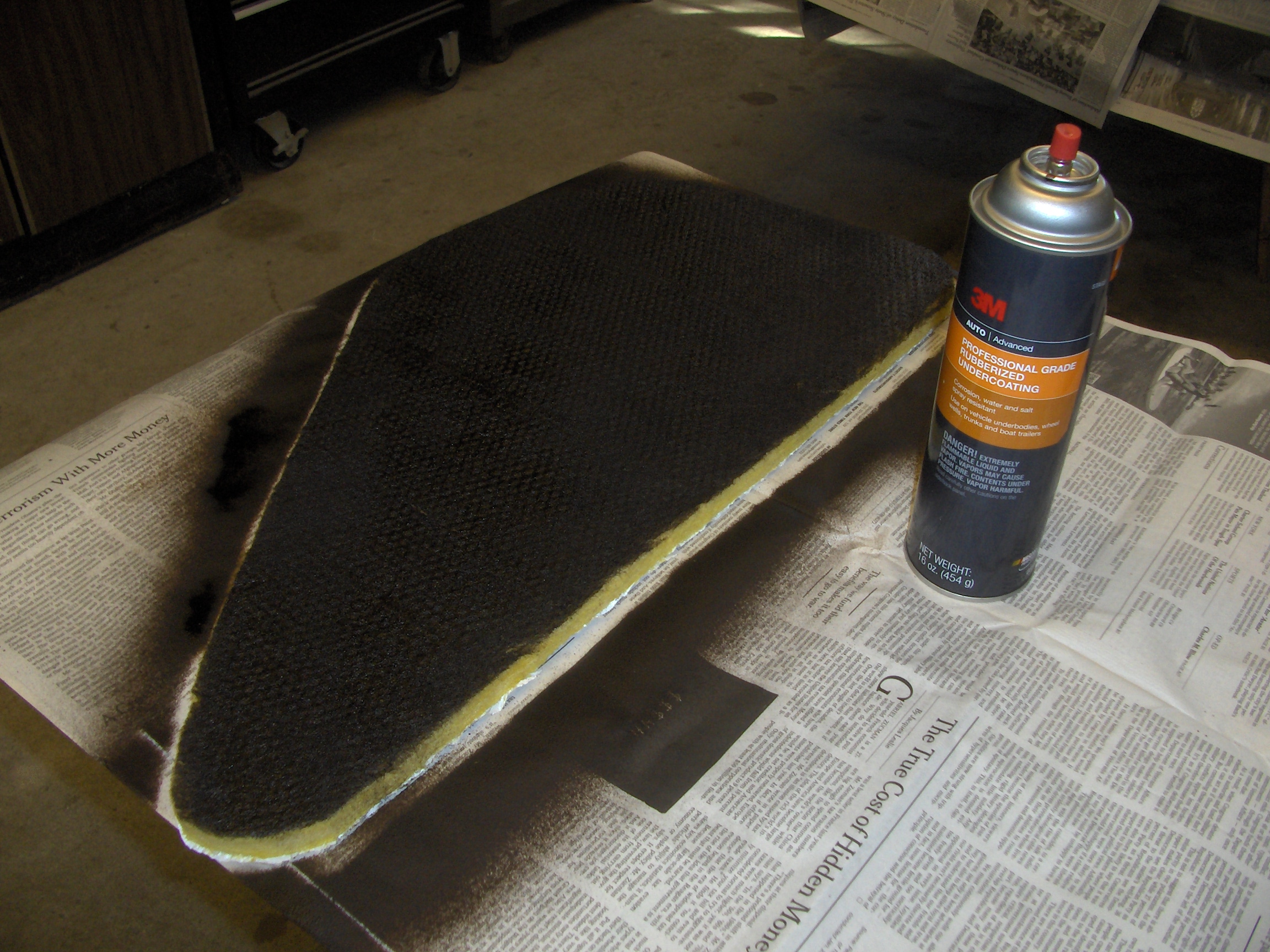

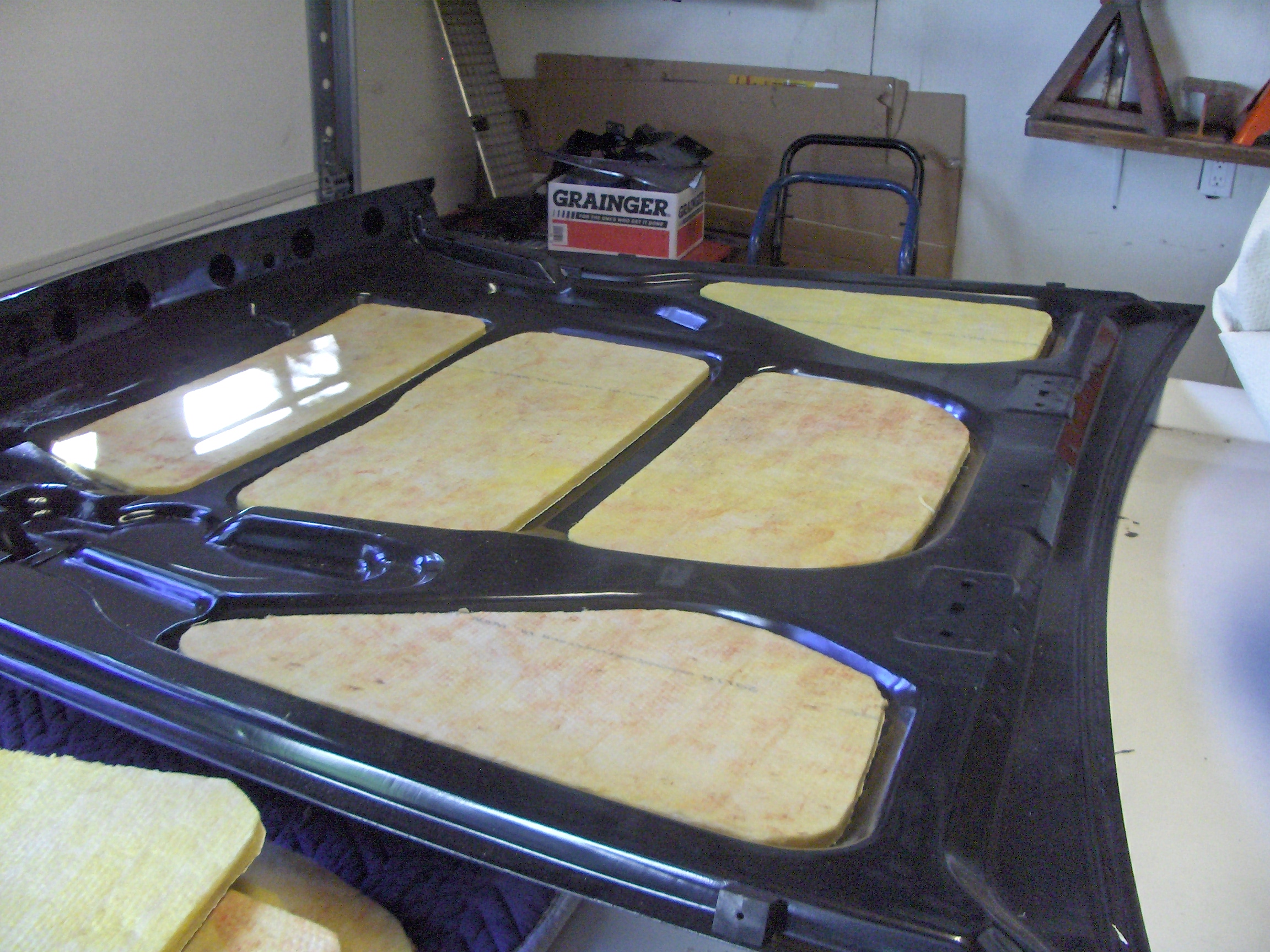

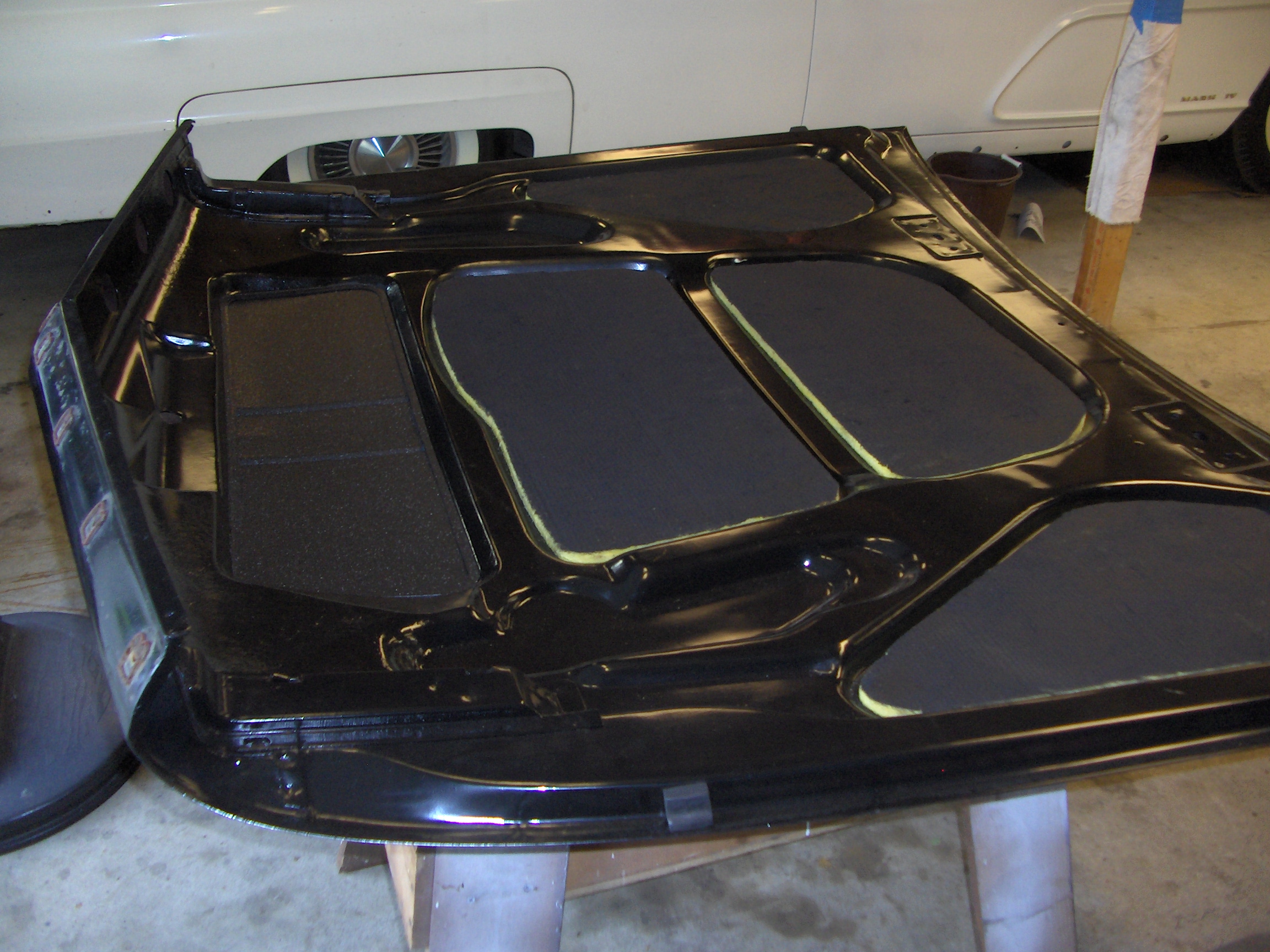

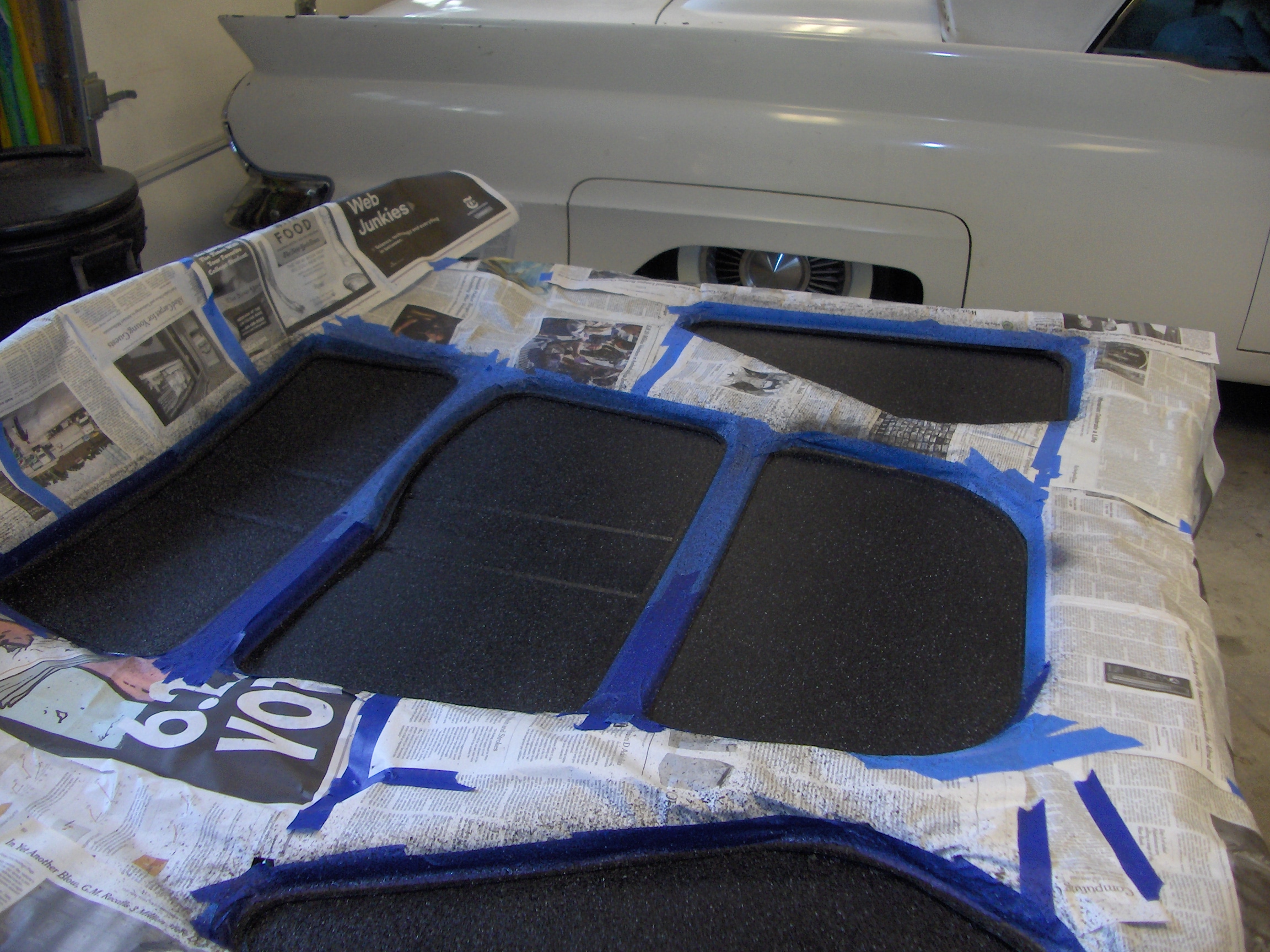

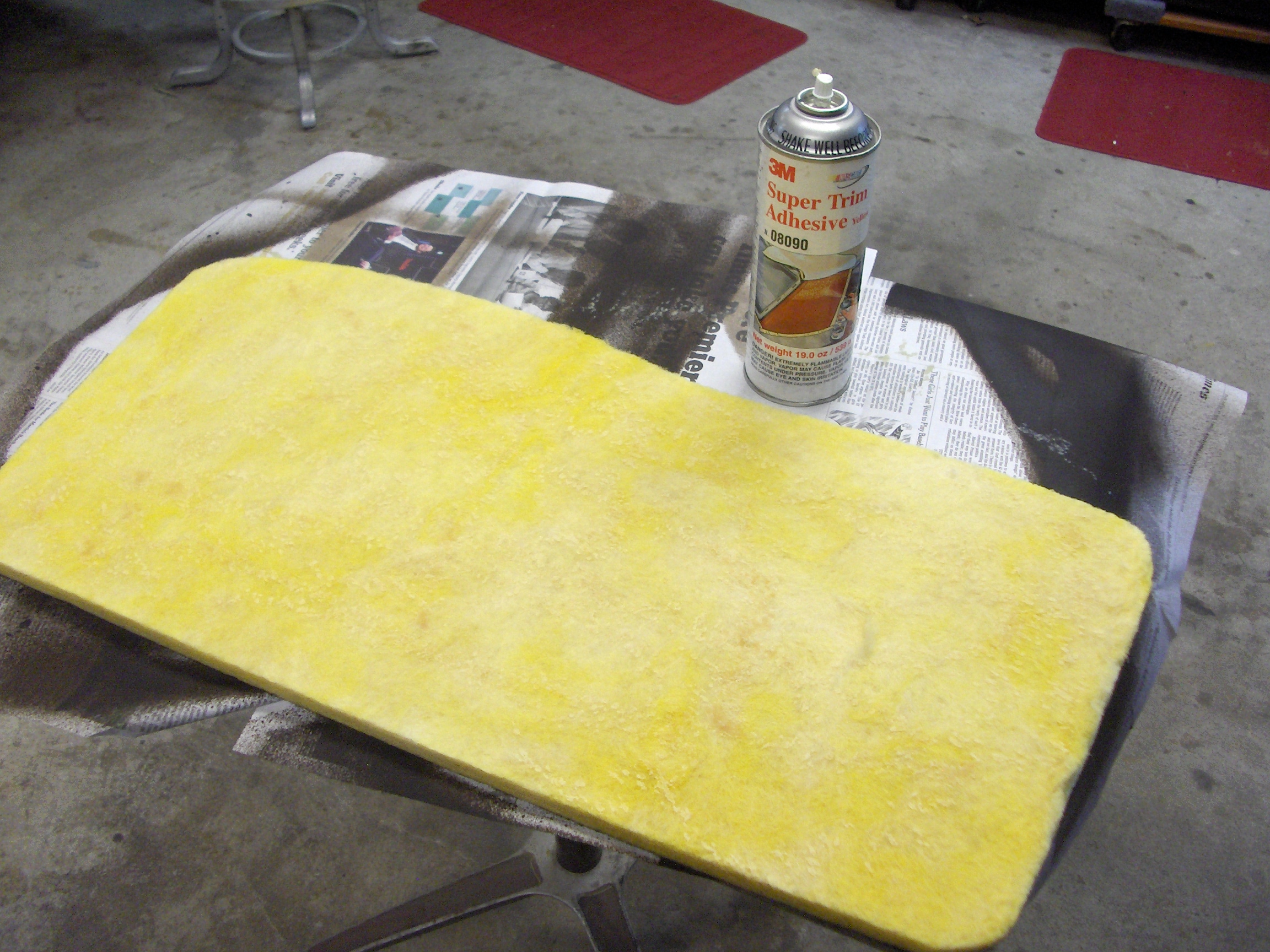

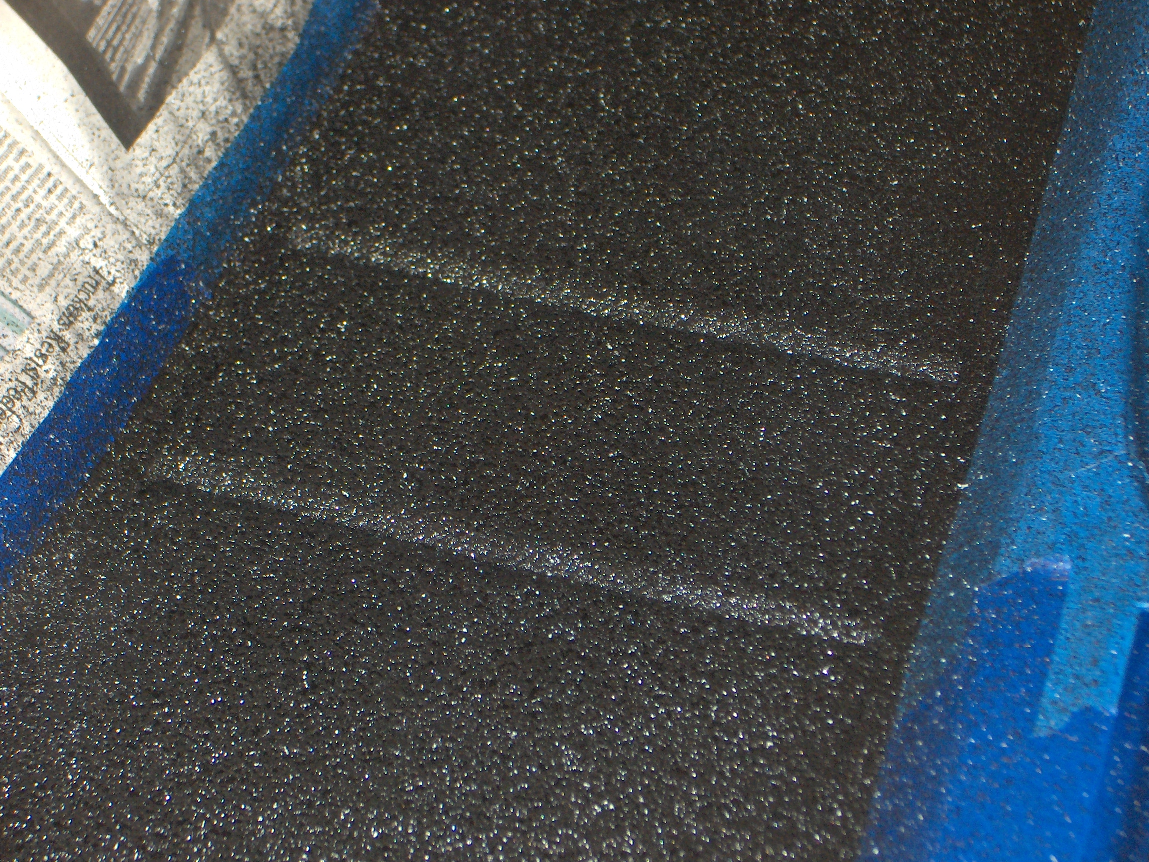

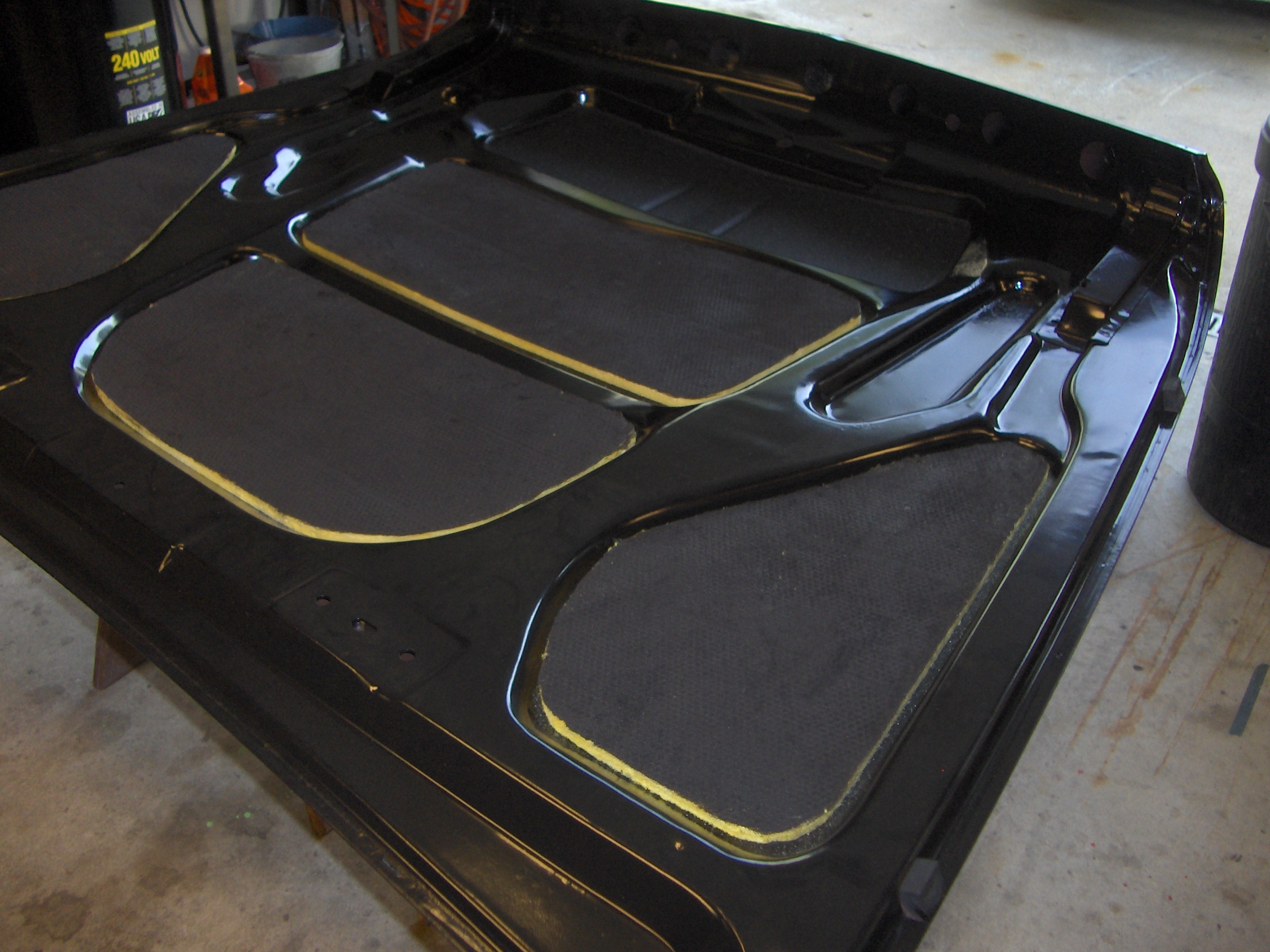

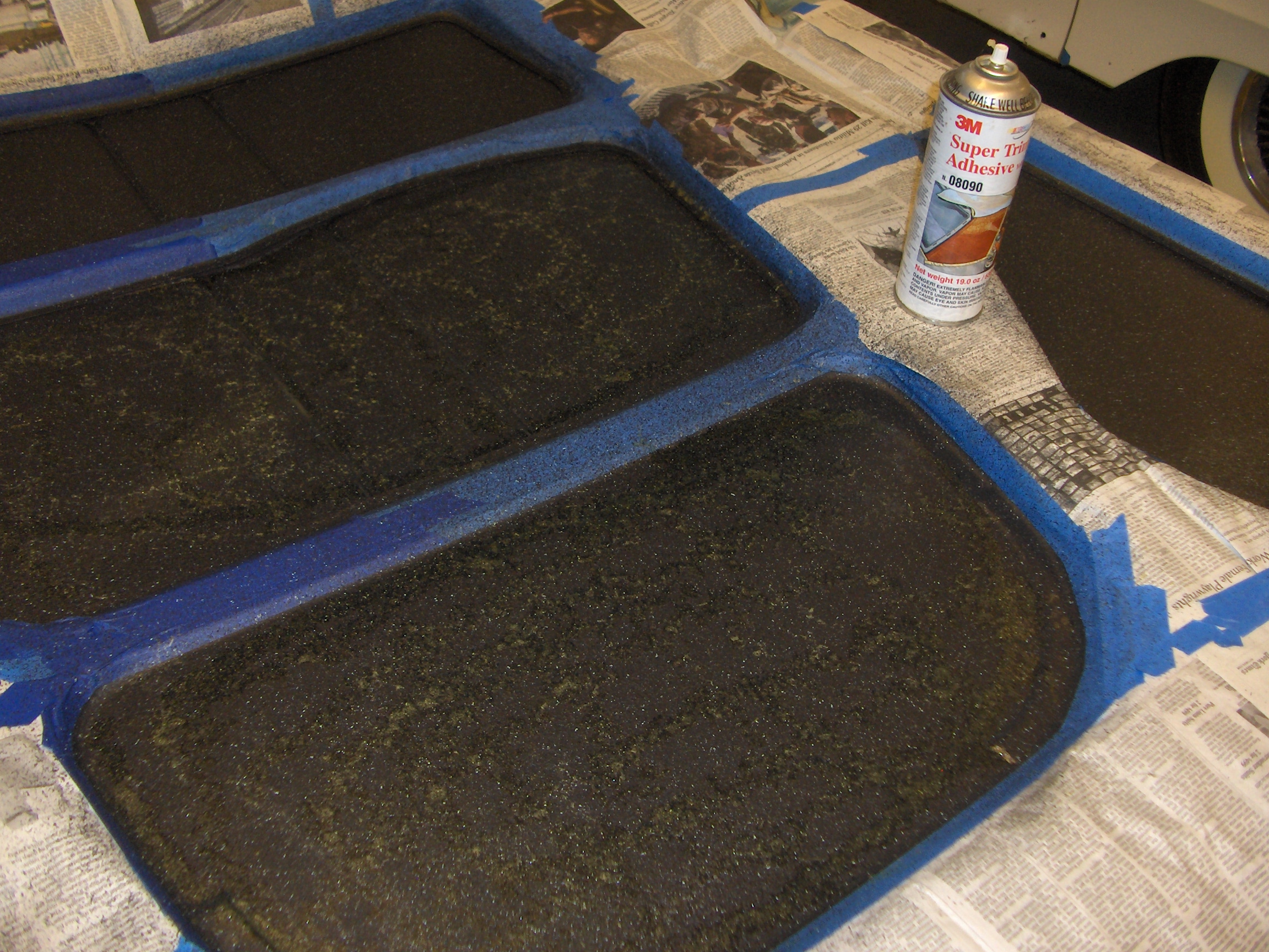

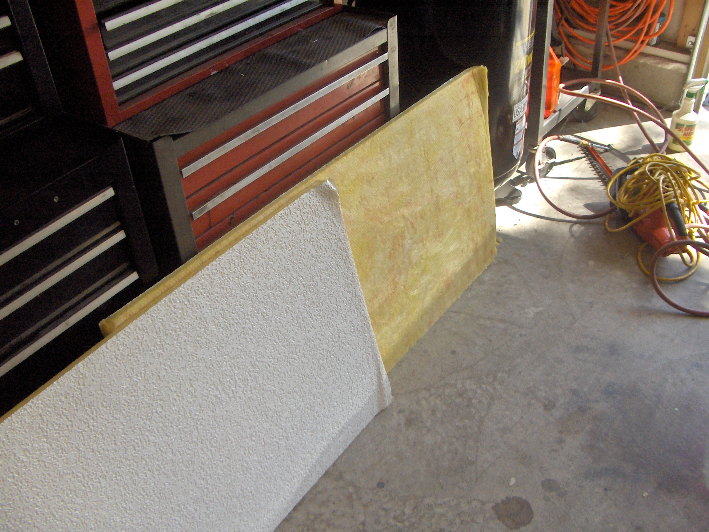

Working on the Lincolns today .. and I need to spruce up under the hood. A friend told me he was buying under hood pads from a supplier. There are two problems, the price and the material.
The hood pads supplied look like some type of black spun cloth. As for the look, well it don't even come close.
Heres what I did for my two vehicles.
