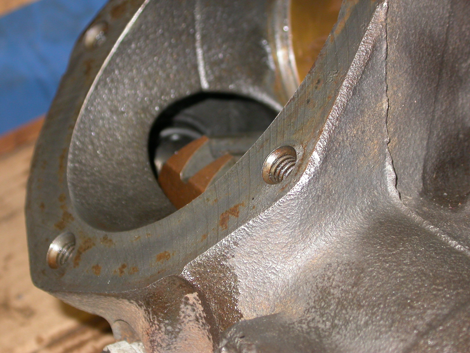

Carefully inspect the casting for cracks or stripped threads....this one looks good...
